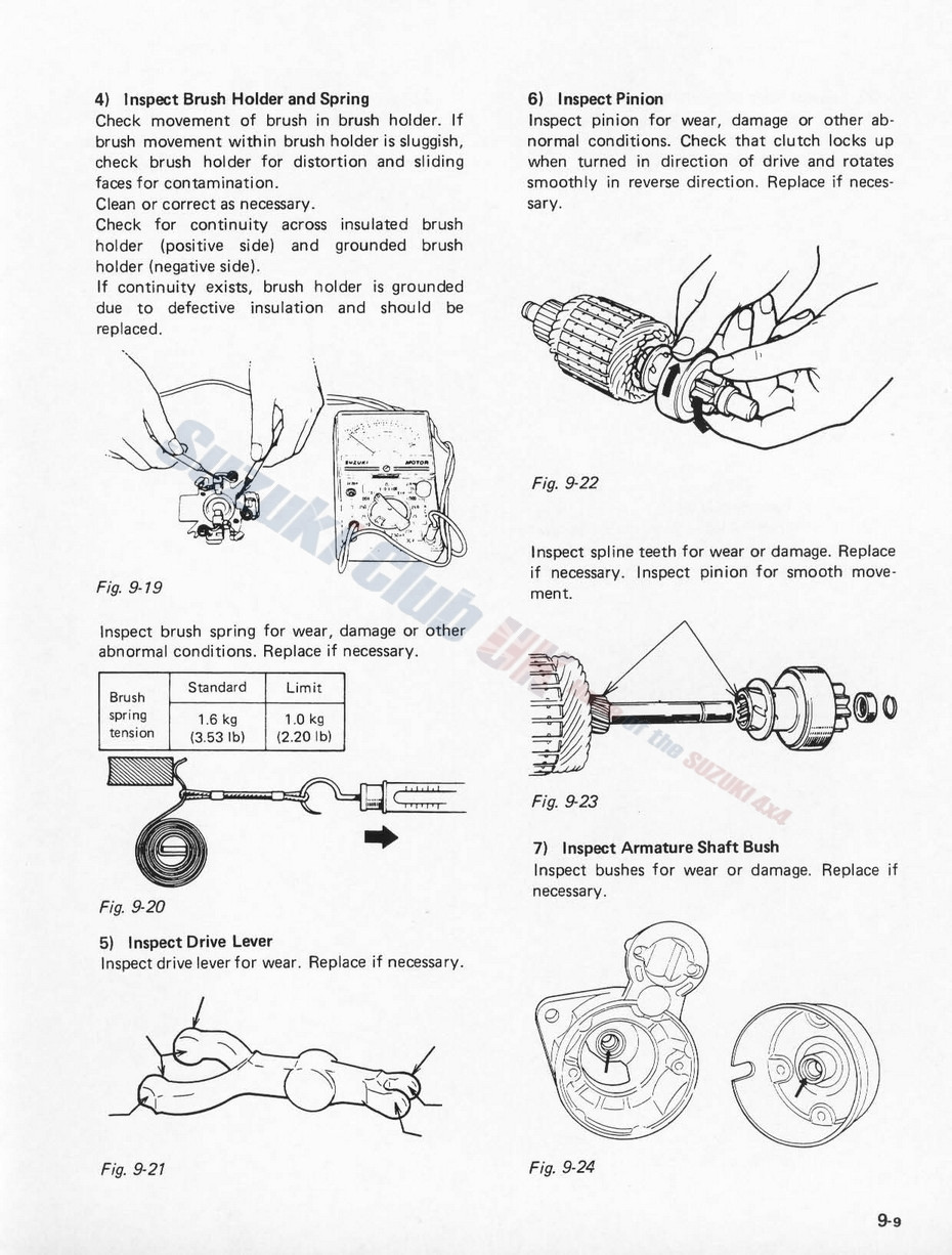

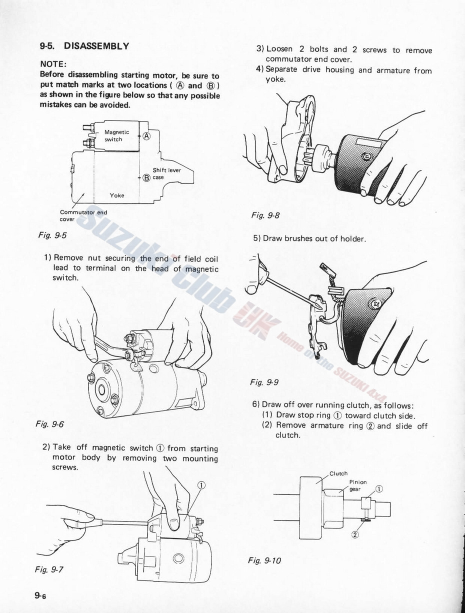

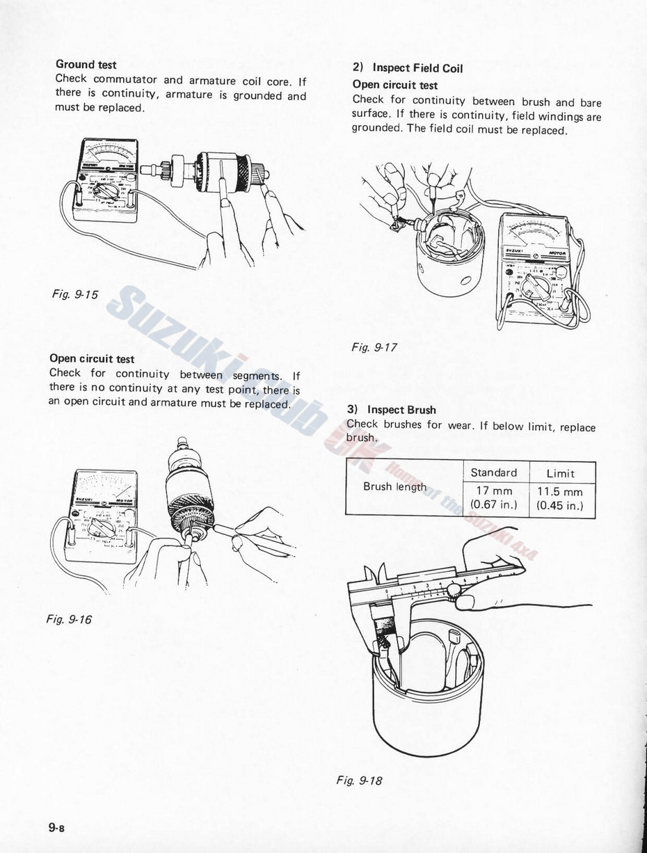

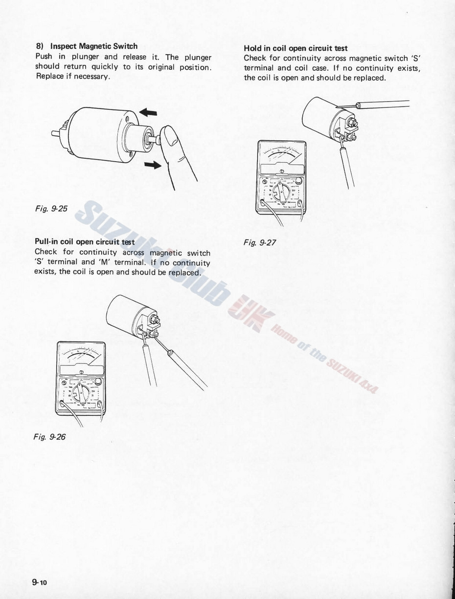

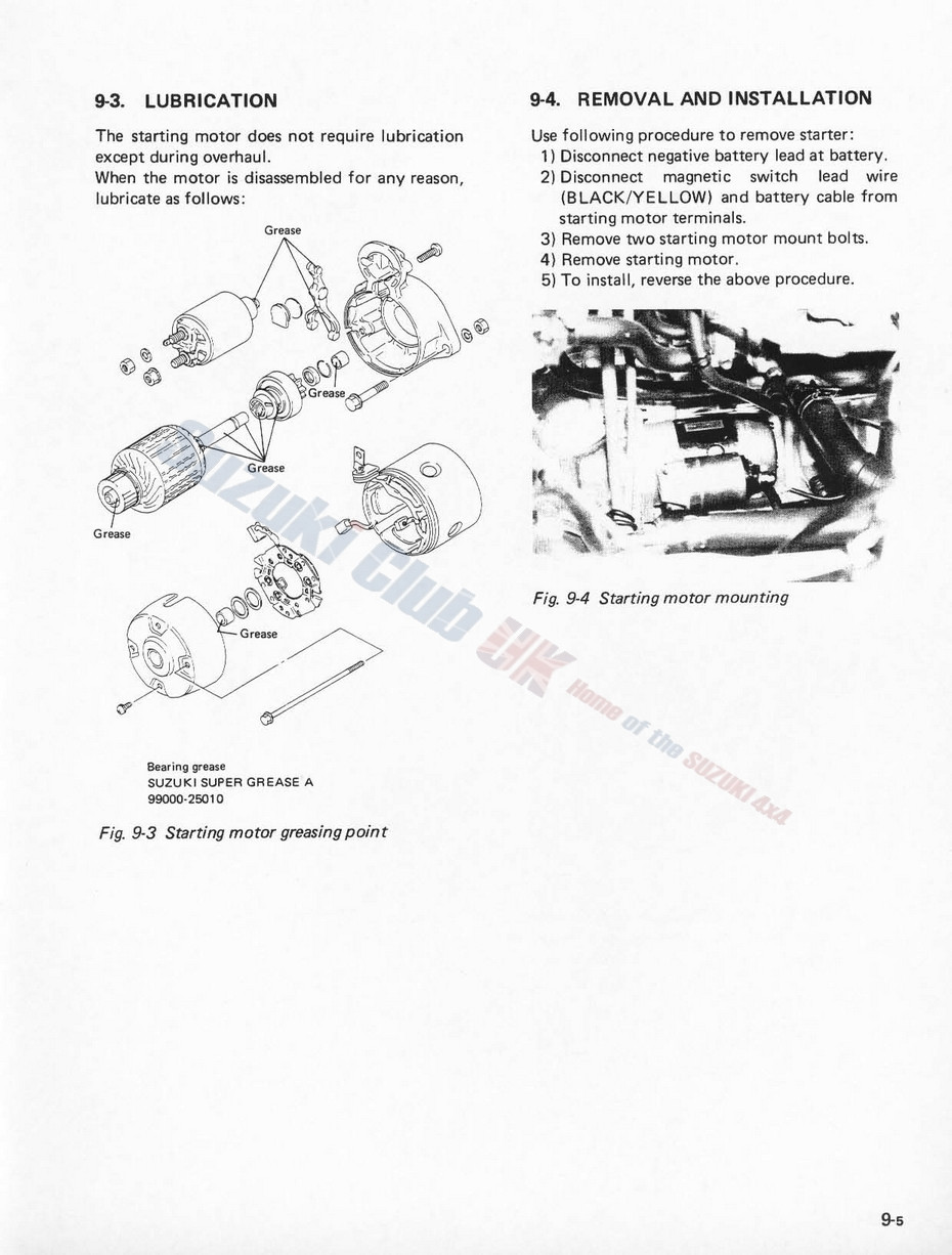

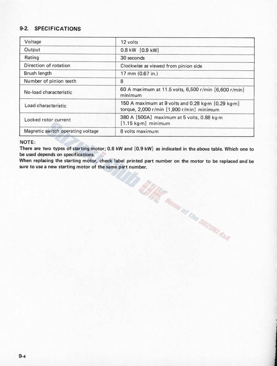

This is the "Cranking" section from the SJ413 workshop manual.
