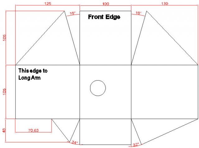

Transferbox guard template
- dazerede
- Posts: 2141
Re: Transferbox guard template
Ok ideal what's the best thickness metal to use
Would have thought 4mm would be sufficient. Look as the strength of the mounts. If you hit a real immovable object its going to rip it off the mounts before damaging the guard.
