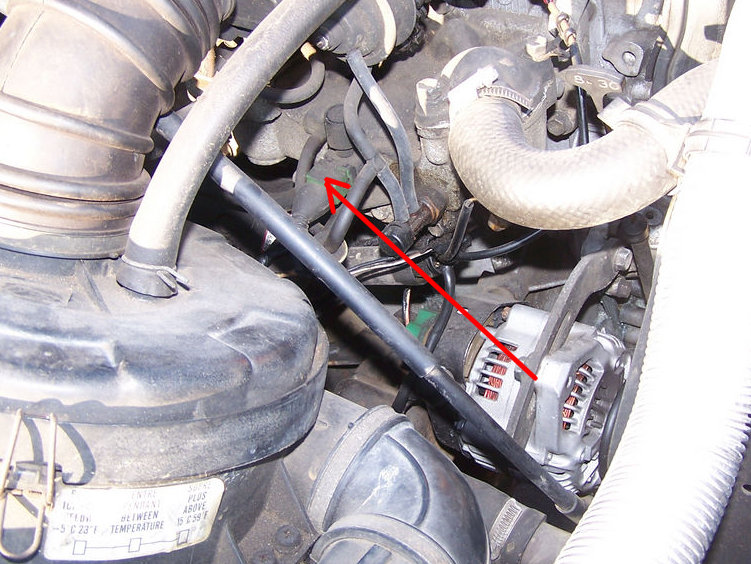

Yes there is an idle up system that raises the idle speed when there is a lot of current draw on the alternator.
3500 sounds a bit high though so it will need adjusting.
Or you could just unplug the idle up system. It's the electrical connector that is sort of under and off to the left of the thermostat housing iirc.

scottie ; so are you suggesting that I unplug the idle up unit and leave it unplugged ?? do you think this would give me the problems I am getting ie ; under normal conditions ie no headlights , On idle its either stalling or racing to 3.5 ??

Unplugging the idle up system will just stop the revs rising when the lights are on etc, I completely removed the idle up system on my old 1.6 carb.
It shouldn't effect the stalling issue, the stalling is probably a choke related issue and that's a seperate system.
In the General troubleshooting section on here you can download a service manual and there's a whole section about the carb and setting it up. They are quite complicated carbs though, most people get rid of them and swap them for a weber or SU.

Scottie , ive just been out and started it again , AND when I put the heater on it does the same so you may well have hit the nail on the head , ive just got to find the little blighter now and un plug it , I can live with the stalling but the high revs at idle make me sound like my great aunt mary in her metro :)

Post by Darrell » Sun Jan 25, 2015 6:57 pm
clark wrote:Scottie , ive just been out and started it again , AND when I put the heater on it does the same so you may well have hit the nail on the head , ive just got to find the little blighter now and un plug it , I can live with the stalling but the high revs at idle make me sound like my great aunt mary in her metro :)
This bugger................

boys i'm out there now with a head torch looking for the little bugger !!!!!
