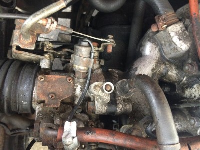

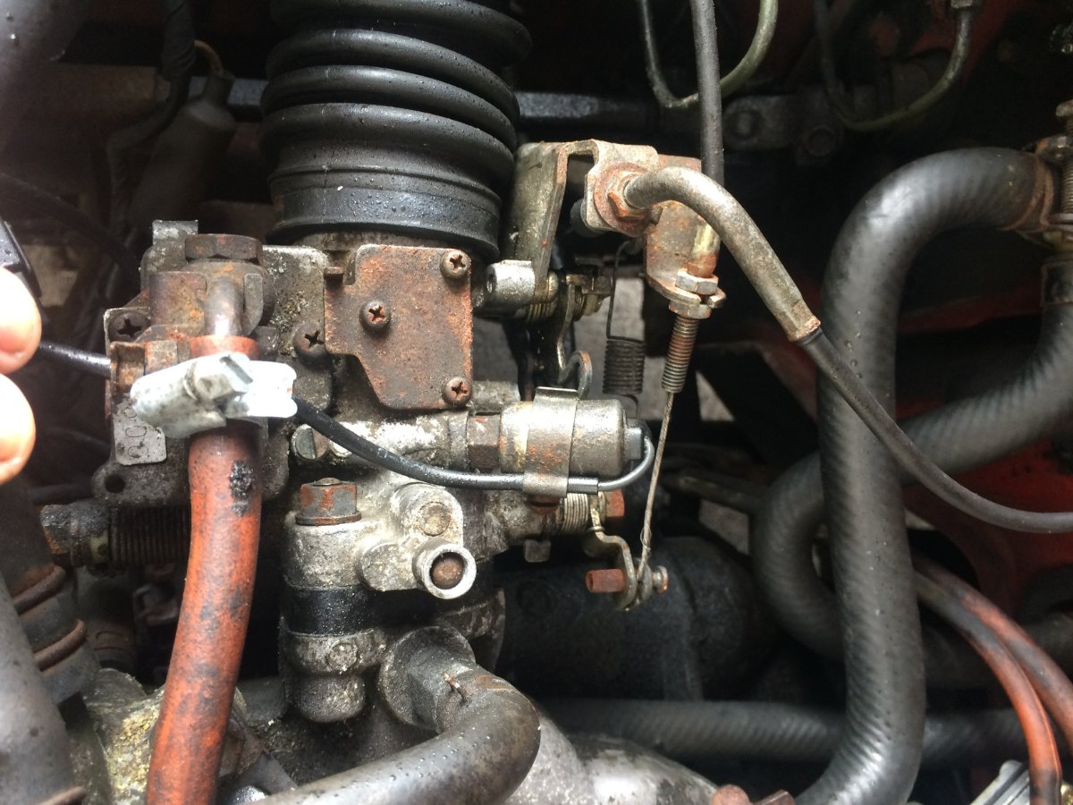

Hi guys
A bit of a novice here but was wondering if someone could assure me i got the right SU to bolt up to my SJ410.
The garage insists I'm missing parts for it to make it a direct fit to the mani? Its a Hif38 (fzx 1414).
Do i need a mounting bracket ? Seems like the bolts where the current carb is bolted to the mani are not diametrically
opposed to each other like they are on the SU, could be a slight of eye though. Any thoughts?
Posts: 11620
Re: SU Carbs
Post by ScottieJ » Wed Apr 17, 2019 9:39 pm
That looks like a HIF44 or bigger.
You need a HIF38 for the f10 engine. personally though I prefer the original aisin carb. if they are looked after, cleaned well and set uop properly they are awesome carbs.

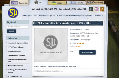

Ah, strange.
Per the part number tag on the SU i have it matches a hif38 for a metro on the SU catalog website
Could there be a different model that is a direct fit for the F10A?

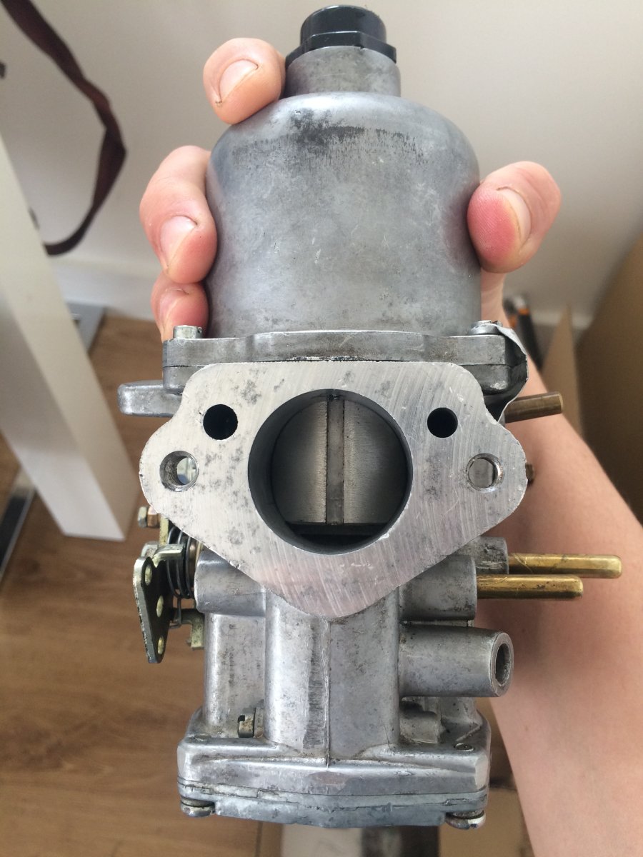

Post by ScottieJ » Thu Apr 18, 2019 11:07 am
sorry I was a bit tired last night....was a long day in the workshop.... your picture is of the air filter side, not the side that bolts up to the inlet :lol:
The side that bolts onto the inlet should have 4 bolt holes and you just use 2 to bolt it up to the inlet manifold.
You do need to do a bit of port matching on the inlet and open up/oval the bolt holes slightly.

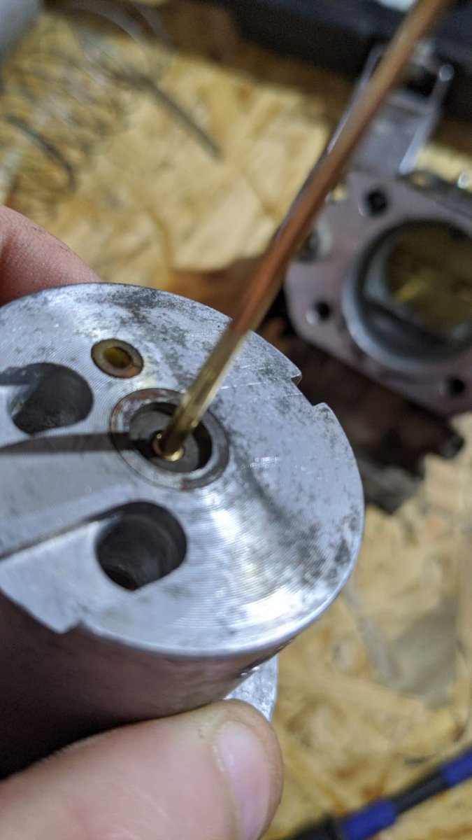

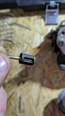

Needle question, where should this black retainer sit in relation to the damper, should it be recessed, flush, or proud? There is only a groove not a specfic locating point for setting the height, so I can set it wherever, just need to know what the 'wherever' should be.
