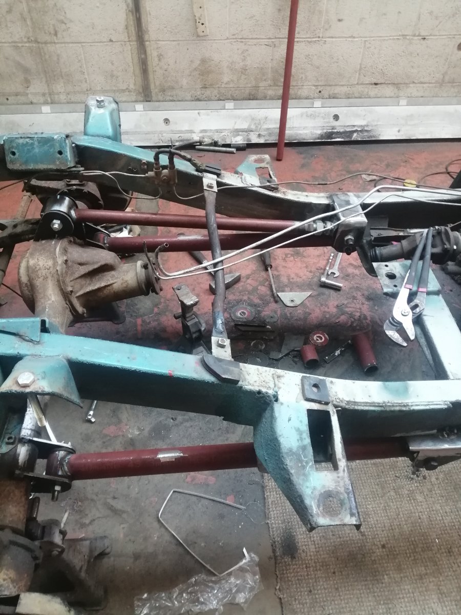

Bit more progress on the front today. Just tacked in place, once the arms are made ill be test fitting then welding and bracing

Just s little bit more progress today, managed to get the arms made up.

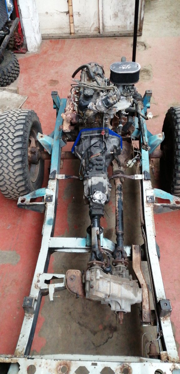

Abit more progress on the front end.
Managed to get it back om the wheels and see how it all fits under compression, nothing catches and has plenty of clearance. Just bumpstops and shocks to finish.
With out shocks my up travel will be about 4.5" and droop will be 7.5", so ideally im thinking i need some 12" shocks. Quite alot of travel for an sj
