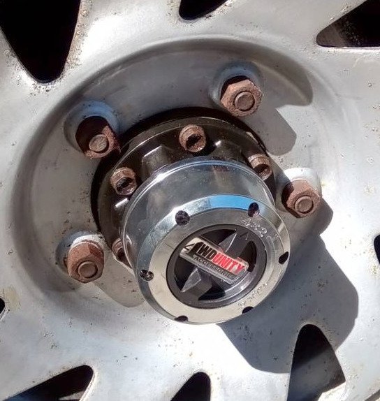

Done, with 'help' from my 2 year old grandson who was returned to his mum properly grubby & greasy.
Start'em young, that's the way.
Not Aisin hubs but they'll do for now.
Got the steering aligned, so far out of whack I doubt it'd ever been done - now it drives very nicely & not like a shopping trolley.

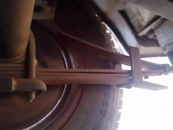

Its possible I was having just a little bit too much fun... busted a rear spring.
busted spring.jpeg (14.11 KiB) Viewed 14442 times
Perfect time to upgrade things, presumably its best to replace springs as a pair ?
Re: Hola, as they say here in the colonies
Post by Jordi » Mon Mar 14, 2022 6:35 pm
Can’t have too much fun with them.
I’d always do them in pairs other wise the old spring will sit lower.

The perils of ordering stuff when there's a language barrier.....replacement springs were not quite the same, almost, but not quite.
One of the looped ends was 44mm diameter instead of 30mm, which means the rubber bushes wont fit, arrgh.
I have a ride from home back to the middle of nowhere tomorrow so I can replace springs & recover the car, as a 'get me home' measure I'm 3D printing a couple of adapter sleeves. Never a dull moment here in the colonies.

It’s been a few years since i did springs, i’m sure the eyes are different sizes.
Bigger diameter bush for the chassis mount, smaller for the shackle.
I have some on the garage floor i can measure.

The chassis ends take 44mm bushes, or at least that's what the springs they made for me have.
3D printed adapters for shackle-end rubbers worked well enough to get me home (200km), now I'm back in Santiago I can find the proper parts. I'll also replace the lower leaf on the new stacks for the old 'overload leaf' - I have a history of abusing vehicles & its just a matter of time before I ask too much of it.
