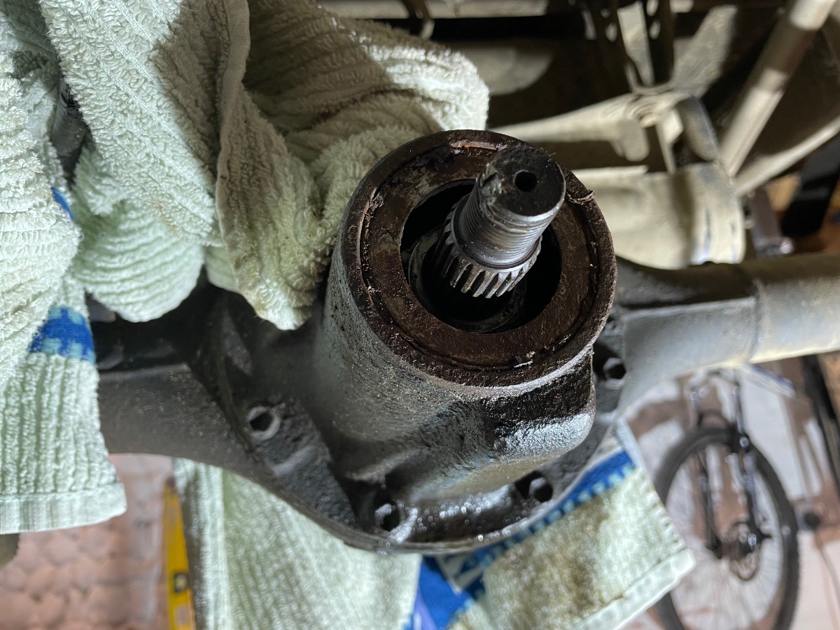

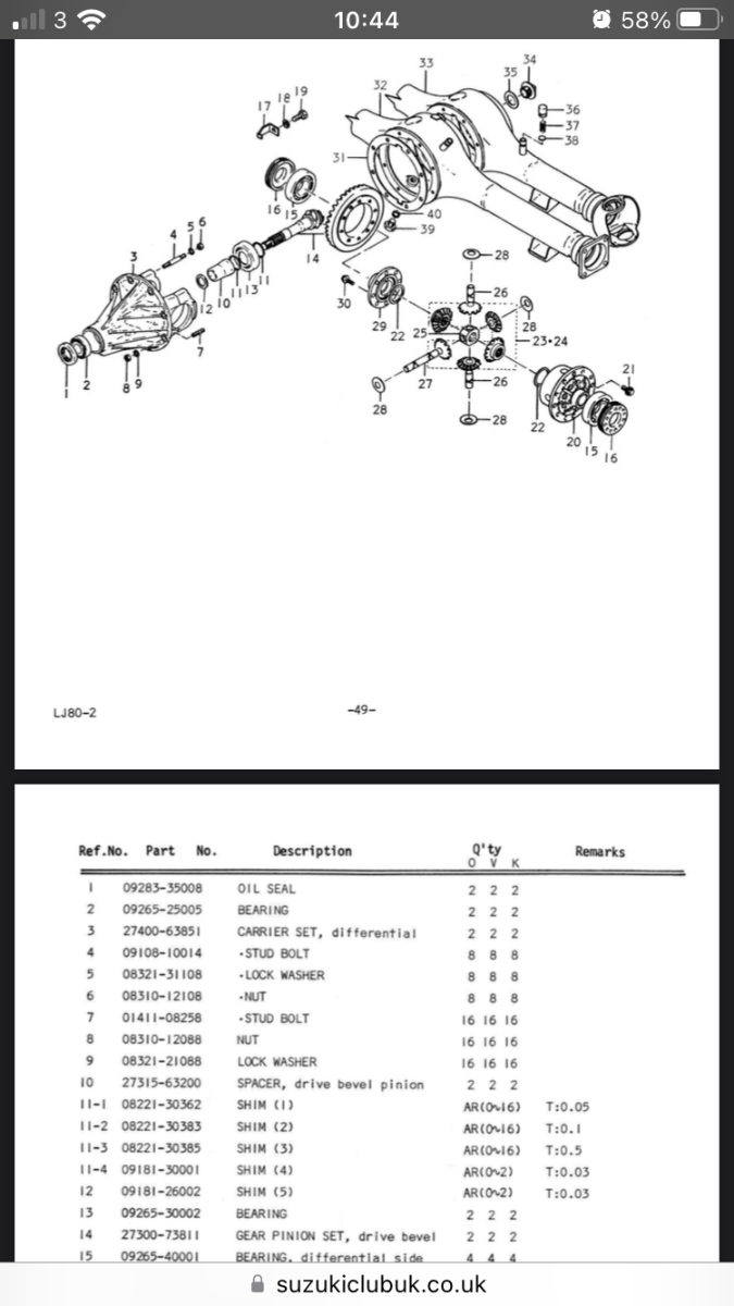

Thanks Scottie. The reason I was worried was that the parts drawing shows the front bearing and seal going in from the front of the diff carrier. If you look back at my photo, there is a flat plate with a groove around the edge in front of the front bearing and behind the seal.
I’ve not tried to remove it before getting the seal so I can see bettor how that fits.
I would expect to see what the drawing shows rather than what I can see!
I am sure I saw a diff rebuild kit somewhere, but can’t find it now. Any ideas?
I want to give it a going over as there is a slight rumble in reverse, but I’d like to have the bits before I start…

Is that not part of the seal?
It’s hard to tell from the pics tbh.
This is the lj80 parts cat page. Shows the same set up as the sj410 and every diff I’ve pulled apart has been as per the parts cats. That’s not to say someone hasn’t been in there before and fitted something that’s wrong or in the wrong order

That’s what I am suspecting, some type of oil shield. The seal in place was stuck to it, so maybe the did that instead of getting the right one.
I’m going to strip it out on Monday and take a look. Only done truck diffs before…this should be fiddly! Time for my meticulous head I think.

How far in from the front of the nose housing should the face of the front bearing end up by the way? The depth of the seal? It looks quite deep to me.
Re: Early SJ410 diff seal
The bearing does sit quite far in, the outer races are pressed into place (only one place they can sit) and then the crush collar sets the bearing preload.
The seal isn’t pressed too far in, there is a dust lip on the seal that sits against the back of the diff flange.

Getting on well with the diff, sussed the seal, it was a bodged plate to hold something they got that didn’t fit.
