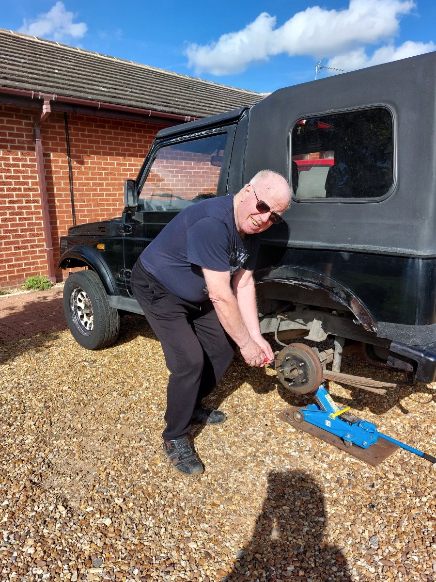

Picture today "Sammy" on the drive. Prayer mat is an old carpet runner I use, because at 81 I do feel the gravel particularly on my knees!!

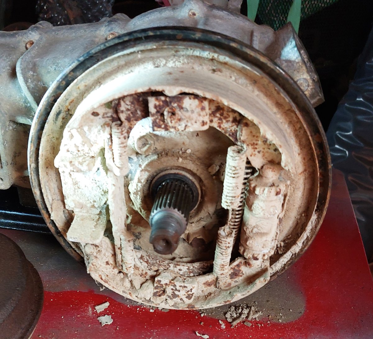

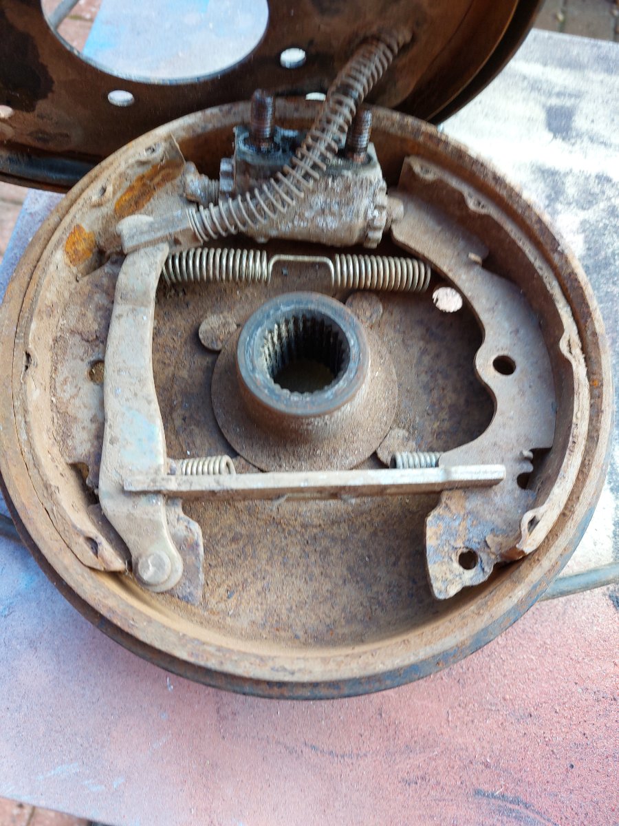

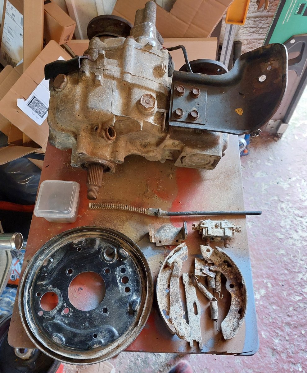

Number 6. Yes I had shown the transfer box / handbrake I purchased on a separate posting. For completeness will repeat the 'mud-trap' picture here. Effort in cleaning up has paid off and I have located replacement parts to rebuild the handbrake.

Re: 1991 Santana Samurai
The 'mud-trap' transfer box handbrake with the drum off.

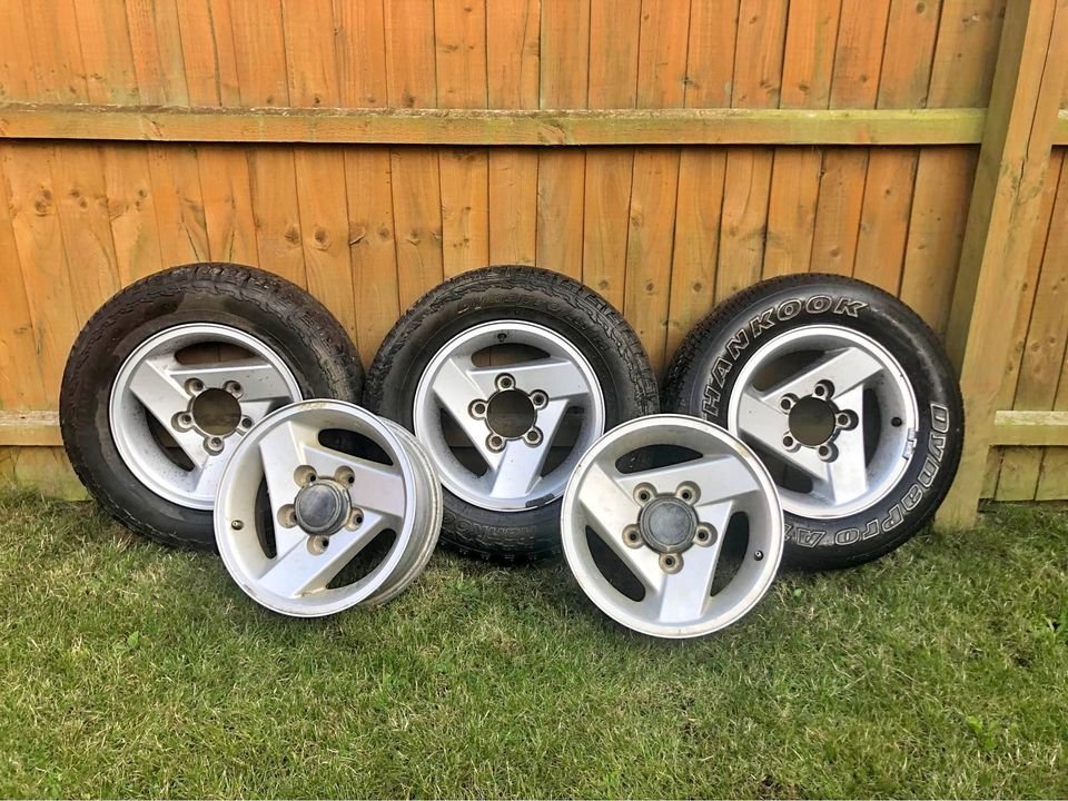

Tomorrow they will be fitted with Hankook Dynapro ATm - 205/70 R15T tyres.
Existing tyres are cracked so hand went into pocket.

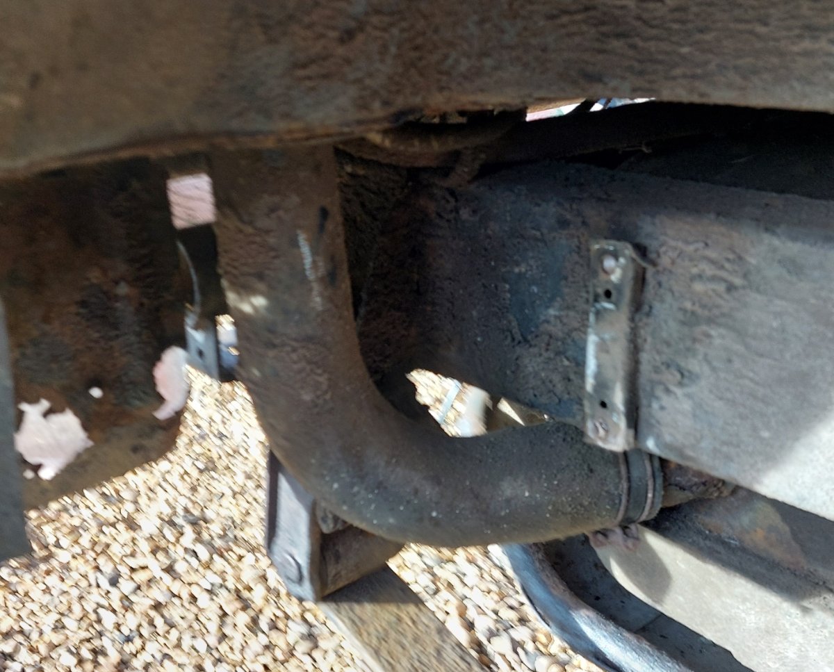

I spent about an hour yesterday removing, very carefully, the Scotchlock fittings around the rear bumper area. Condition of some wires is not very good.
Comparison between actual cables and the Spanish wiring diagram, I have showed up differences, so plan to drop the fuel tank and guard and get better access to the loom then. Sort out what goes where and what wiring is required for the towbar and additional lights I plan to add.

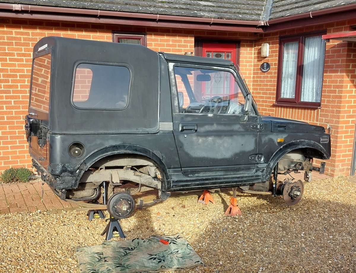

Taken last year when it was warmer!!

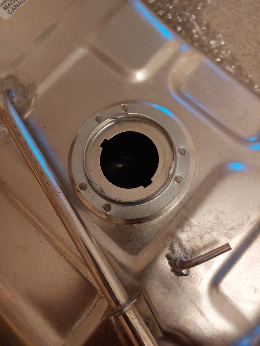

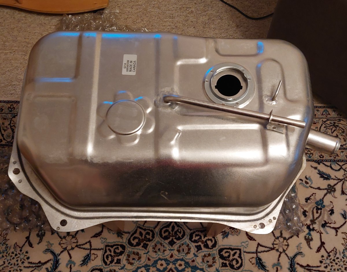

After much searching a new Spanish fuel tank was located and purchased.
