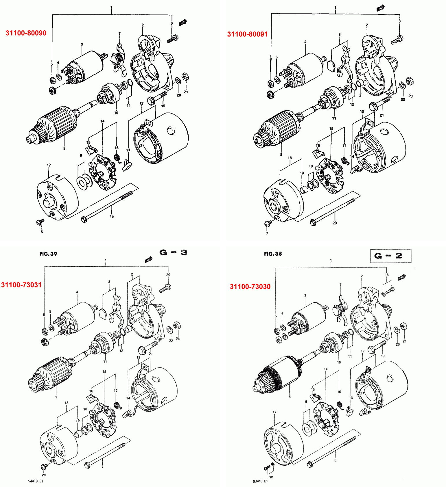

I have at big problem with my sj410 fron 84. the startermotor is bustet.... :cry:
i have ordered a new one fron a startermotor specialist here in Denmark but he has sent my the wrong starter. And now he claims there is at lot of diferent starters? I have only seen one type on sj410. Is there any of you experts tha can confirm that? Or even have the oem parts numbers?

Looking at the diagrams I have found 4 numbers listed. To be honest I don't see much of a difference between them IE the fixing plate. Hopefully somebody will be able to give you a better answer. I thought there was only an issue on the starter body size. Can you see why it doesn't fit.
SJ410 starter motors.jpg (399.12 KiB) Viewed 4377 times

Well i the one i have reseeved is too long. about 1". so i have to find out wich one will fit my sj.
Thanks for your drawing now i have some to work with.
