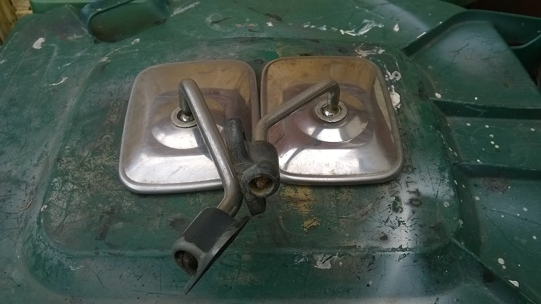

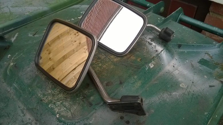

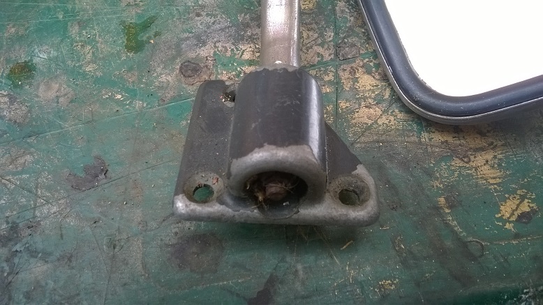

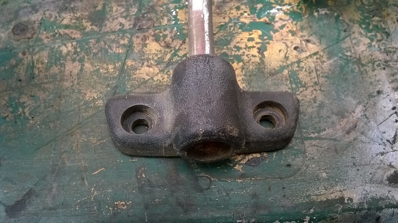

Found 2 mirrors but the mounting points are different. Maybe take them off (8mm bolt) and use your existing ones?

I have some experience with these mirrors and mounts.
Be very careful removing that bottom bolt, the chrome plated chamfered point shaft bolt is often well corroded, and can disintegrate when disturbed!
The chrome shaft arm is press fitted into the S/S mirror back, so impossible to salvage
If you need to grind thru the galvanized bracket mount for better initial access, I might have some spare.

Thanks for looking those out Donkey - so the stem base is bolted into the mount plate? and maybe I could keep my existing mounts and fit these to the black mounts?? I assume holes are in different places etc? Are those chrome stems slightly different?

I had another look yes they are slightly different. One is for an LJ I think. Oh well!
