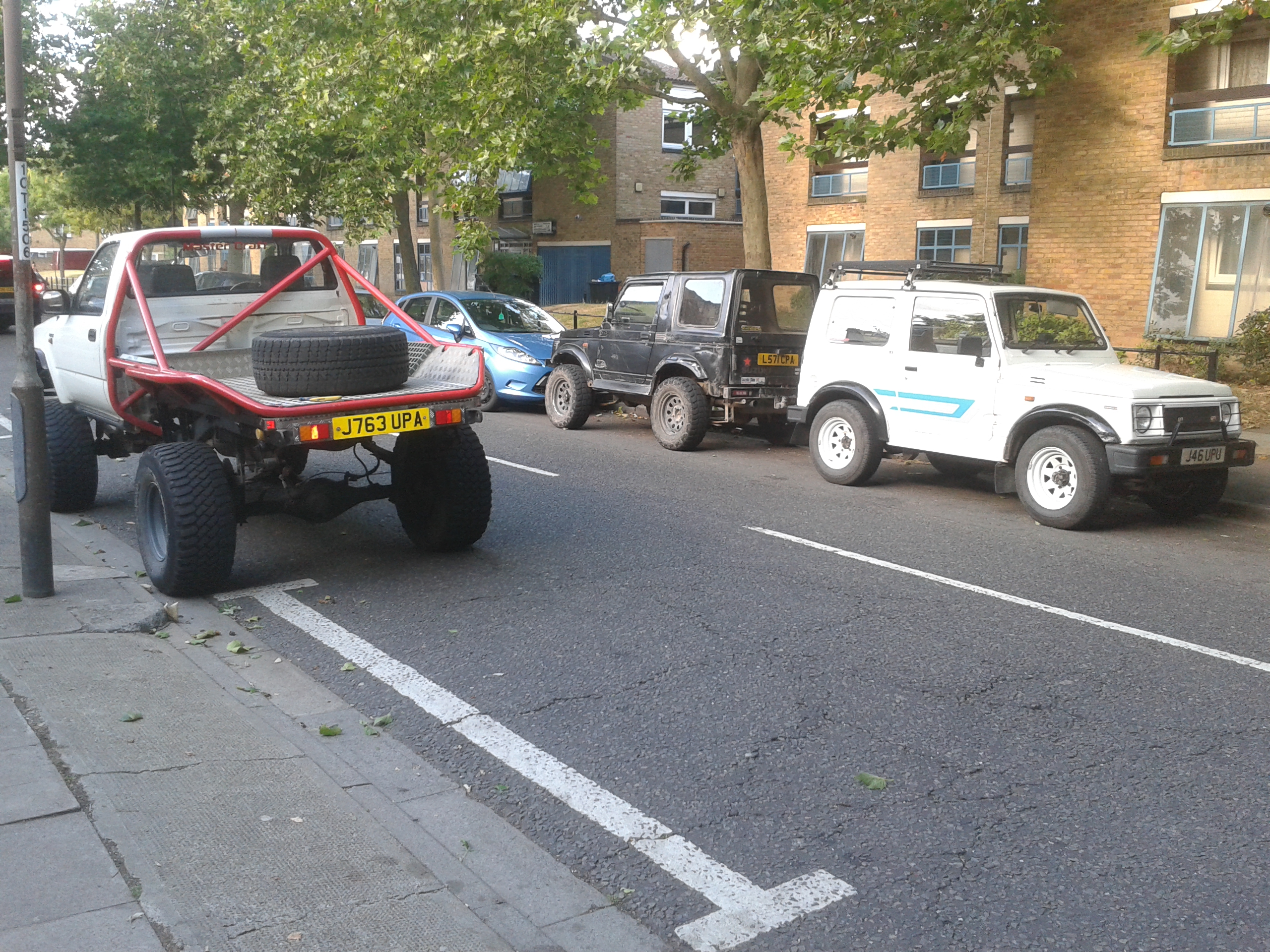

Stock height with some offset wheels and 215 75 15 is a nice look in my opinion.
My daily
They are a bit harsh on the spine. I wouldnt have them again.
My daily
- 20130728_182227.jpg (3.85 MiB) Viewed 29297 times
- 20140516_124948.jpg (3.24 MiB) Viewed 29297 times

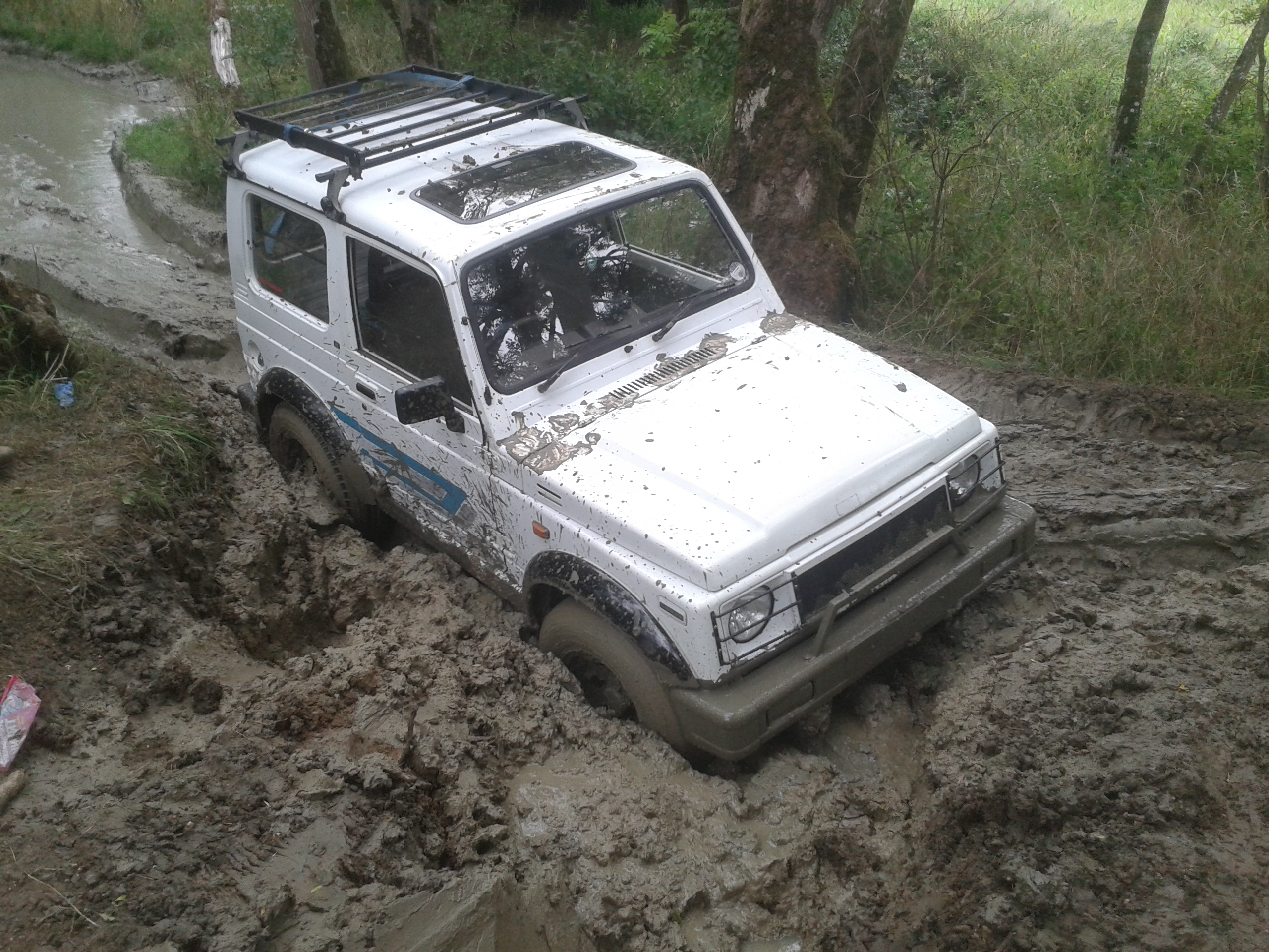

Tyre wise mine are Goodyear wrangler rt/s I paid 30 quid for 4 of
Them
For less than £100. I picked up a set of 205 70 15 hankook dynapro at tyres
For 40 quid delivered! They was listed as kia sedona tyres. I sold them
On for 35 after 6 months use.
Even if you do fancy a dip in the mud an sj with road tyres
Will still get you further than you'd think.
- 20130817_173728.jpg (3.54 MiB) Viewed 29276 times
