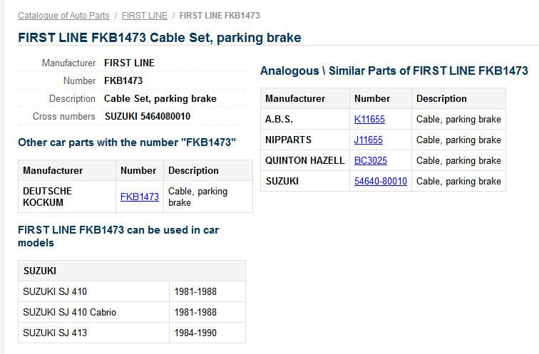

There's a guy on Ebay that's selling a T-box hand brake cable (item number 280715233777)It's the same part number as the one in Darrell's picture (First line FKB1473) but it's got different fixings... Going to have to be careful when buying this part..

Bit more cable info
FIRST-LINE-FKB1473-Cable-Set-parking-brake 2013-12-15 23-25-24.jpeg (104.79 KiB) Viewed 45673 times
