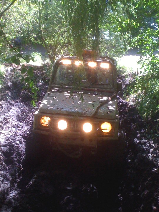

Post by arnie » Tue Jun 28, 2011 6:57 pm
progressed with truck and took it out first time with all the new bits well please although i think bigger lump is needed just bit down on power when going up hills

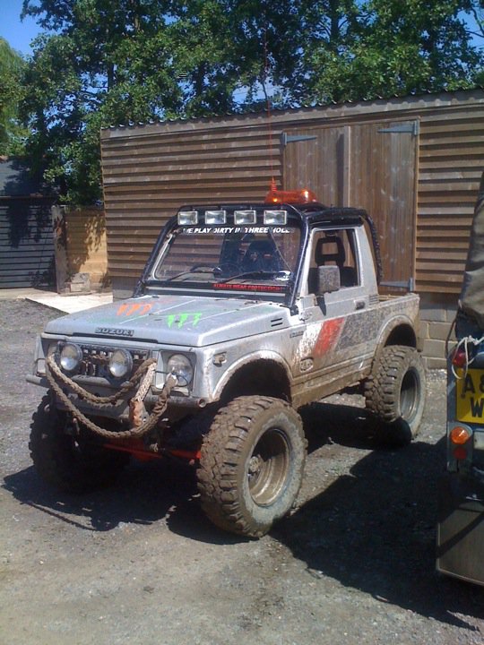

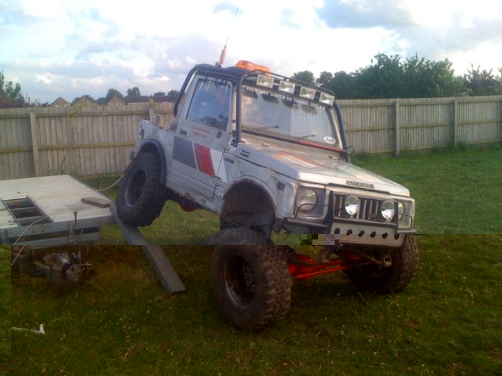

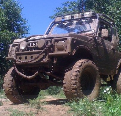

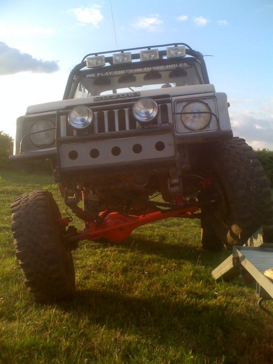

Post by sam16v » Sun Jul 03, 2011 3:49 pm
nice truck you got there mate, cage looks spot on. what suspension have you got on it and what size are the wheels and tyres? keep up the good work.
arnie
Posts: 23
Joined: Mon Apr 25, 2011 9:23 pm
Re: zuke sj410 budget home build
Post by arnie » Sun Jul 03, 2011 10:59 pm
Thanks mate Iv spring Over axle it and then iv made leafs up out of all different sets to get her to sit where I wanted her And the tyres are 267 75 16s. On reversed and re drilled/ counter sunk discovery steels. Gives nice offset with the ease of finding 16s tyres :)
