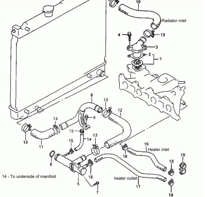

Think iv sorted the cooling but if its not to much hassle to you then it wouldn't hurt for me to check ive done it right.

Decided not to bother with the photos as mine is a 413 and the vit is a little different. That and the fact your fitting an SU which does away with about a hundred soddin little hoses including ones that heated sections on the original carb. So thought I'd just post up this......
