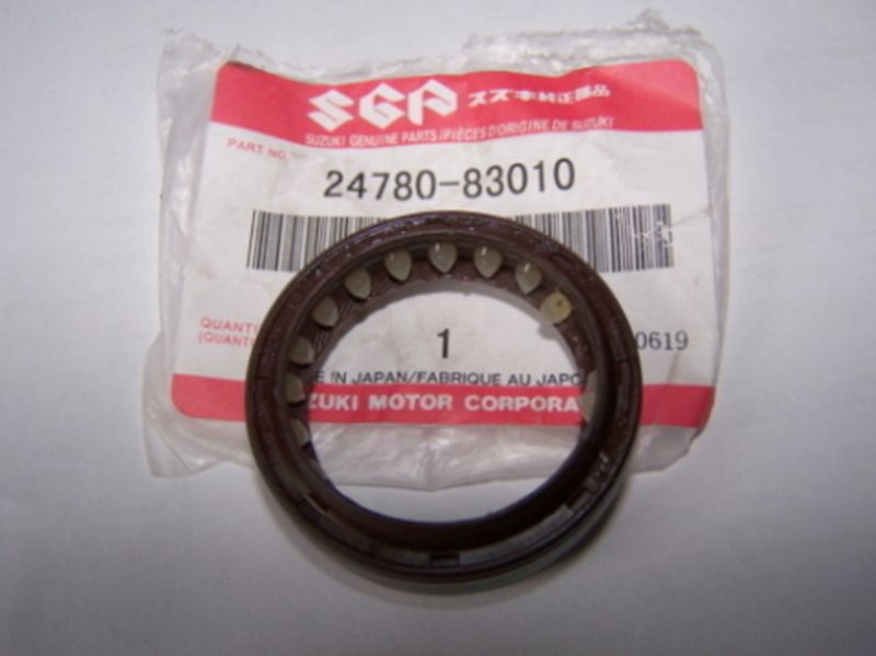

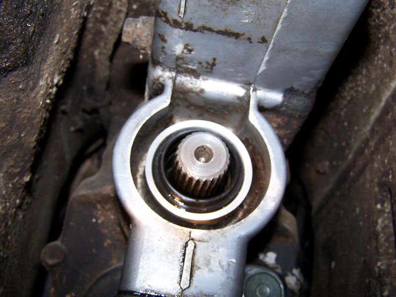

Yep, easy enough to remove the short prop. Just undo the 4 bolts on the flange and move it to one side and pull from gearbox. Mine didn't leak oil when I removed it. Screwdriver to prise the old seal out and a socket to tap the new one in. The old seal was worn, but also gone brittle.
- 100_1773.jpg (69.63 KiB) Viewed 6469 times
- new_seal_879.jpg (40.21 KiB) Viewed 6469 times

Good work Darrell. Knew you would be along with the part number!
