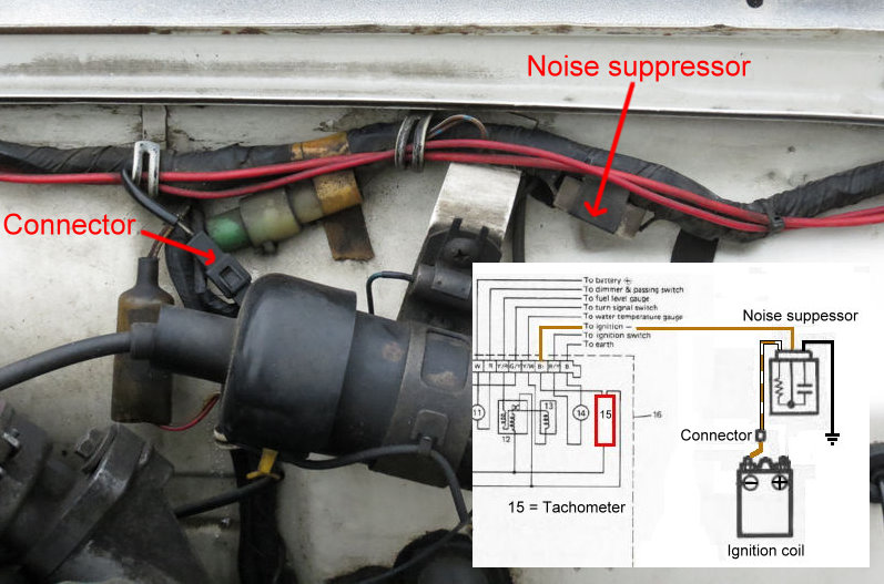

Edweird wrote:That would probably depend on the one you've bought as to whether it need to go through the suppressor. Given your old one stopped working the suppressor is one of the things that could have broken though.
ahh ed i havent bought one yet matey :lol:
so is the noise supressor the grey block looking thing ?

this brown with the white trace has been chopped off....
my coil...
does this black and white fellla do anything ?

New diagram
Rev counter wiring diagram.jpg (95.51 KiB) Viewed 5266 times
Re: rev counter is not working now its gone up the swaney!!!
Post by Darrell » Sat Apr 07, 2012 3:46 pm
Black/white is switched live. On the coil via a connector it is normally then just white with a heat-sleeve. Yours is not the original wiring as it has a chunky brown :er:. I would just put some insulation tape on the end and leave it.
