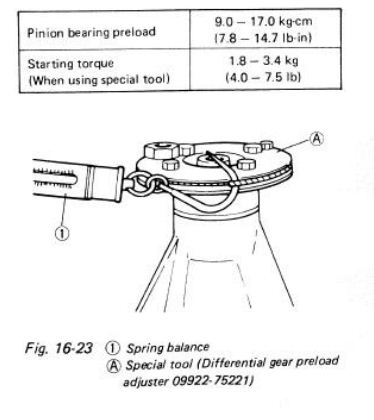

I dont think the service manual bit I'm looking at requires the diff to be apart?
It shows a pic of the flange with a spring balance (aka newton meter) pulling on it while tightening...
Looks to me like you dont have to take the diff apart to do that and it might be worth doing as a spring balance can be had for about £3 off ebay

- Suzuki Club UK • View topic - Differentials Setting up and servicing etc. - Ope_2012-06-27_17-25-44.jpg (22.36 KiB) Viewed 4777 times

Right, on closer inspection of the manual... it says that the procedure with the pic above should be done after the carrier is re-installed, so I guess you should be able to do it without taking the carrier out in the first place...
I'm just overly cautious about diffs... no point in accidentally ruining one if that's all it takes to get it to manufacturers specs

Trust me the pinion bearing preload is set without the diff case in the carrier, (prob would help if we weren't calling the diff case the carrier
Where does it say that it should be fitted?

From the diff sticky...
Right hand side, says to do it after assembling the diff
Re: swaping flanges
Nope doesn't say install the differential case into the carrier, just pinion, bearings, crush collar, seal and the flange
your imagining things twiss
It says in the section after you what the starting torque should be with the diff case fitted when adjusting the side bearing preloads, however you need to know the starting torque without the diff case fitted first.
You could however measure that starting torque with the diff whole diff assembly removed from the axle before removing the flange and then reset it to that with the new collar and seal fitted, that should do the trick.
