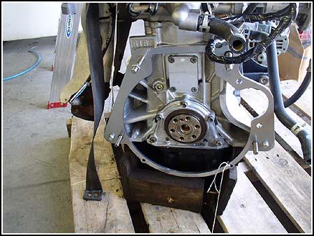

Ok another question.....does one of the "plates" that sit between the engine and box need to be used or modified?
As obviously when the box is in place, on the left side (looking from box end) theres a huge gap above/next to where the original unused Vit hole is that would let dirt and water into the bell housing.....How do I get round this?

chris71920 wrote:Ok another question.....does one of the "plates" that sit between the engine and box need to be used or modified?

Re: Few questions about 1.6 conversion
Post by dan_2k_uk » Thu Jul 12, 2012 8:16 pm
I modified the spacer from the 1.3 to clear bits on the 1.6 and then filled in the gap left behind with a little bit of ally cut to shape and stuck on with silicone.
