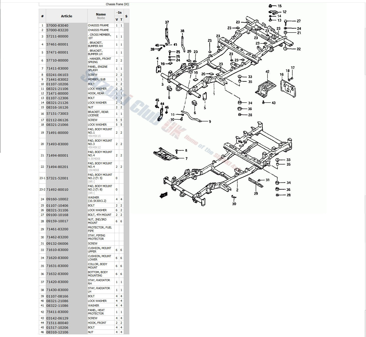

Yeah they're the ones I can see, as well as the other two. (All four that connects to the cross member) I shall take a picture tomorrow so it will make it clearer. Has anyone got any advice about the hockey puck looking body mounts and where they should go ?

This any help....
