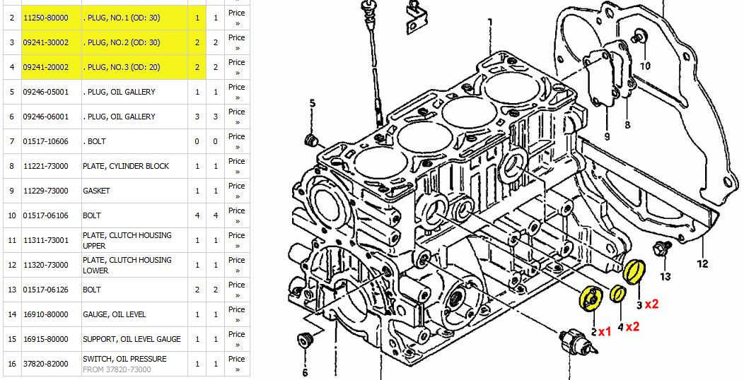

Post by Darrell » Wed Jul 03, 2013 9:34 pm
Hope this is all correct. Some engine photos show the large plugs all the same (3 off).
But the online diagram shows one of the large plugs a little different and therefore a different number.
The other side of the block has one large, one small.
410 plugs.png (134.7 KiB) Viewed 5555 times

They are easy enough to spot when you know what you are looking for. Here is a little video on how to change them. Make sure you can get hold of some new ones first though, before you knock the old ones out!!
Click Here for Youtube Video
Before fitting new ones I would poke and prod all the crap out of the water jacket. and give it a good flush out with water. Then clean the hole in the block, dry it and then fit as the video shows.
