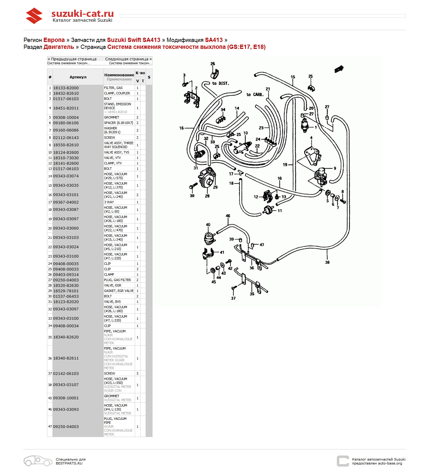

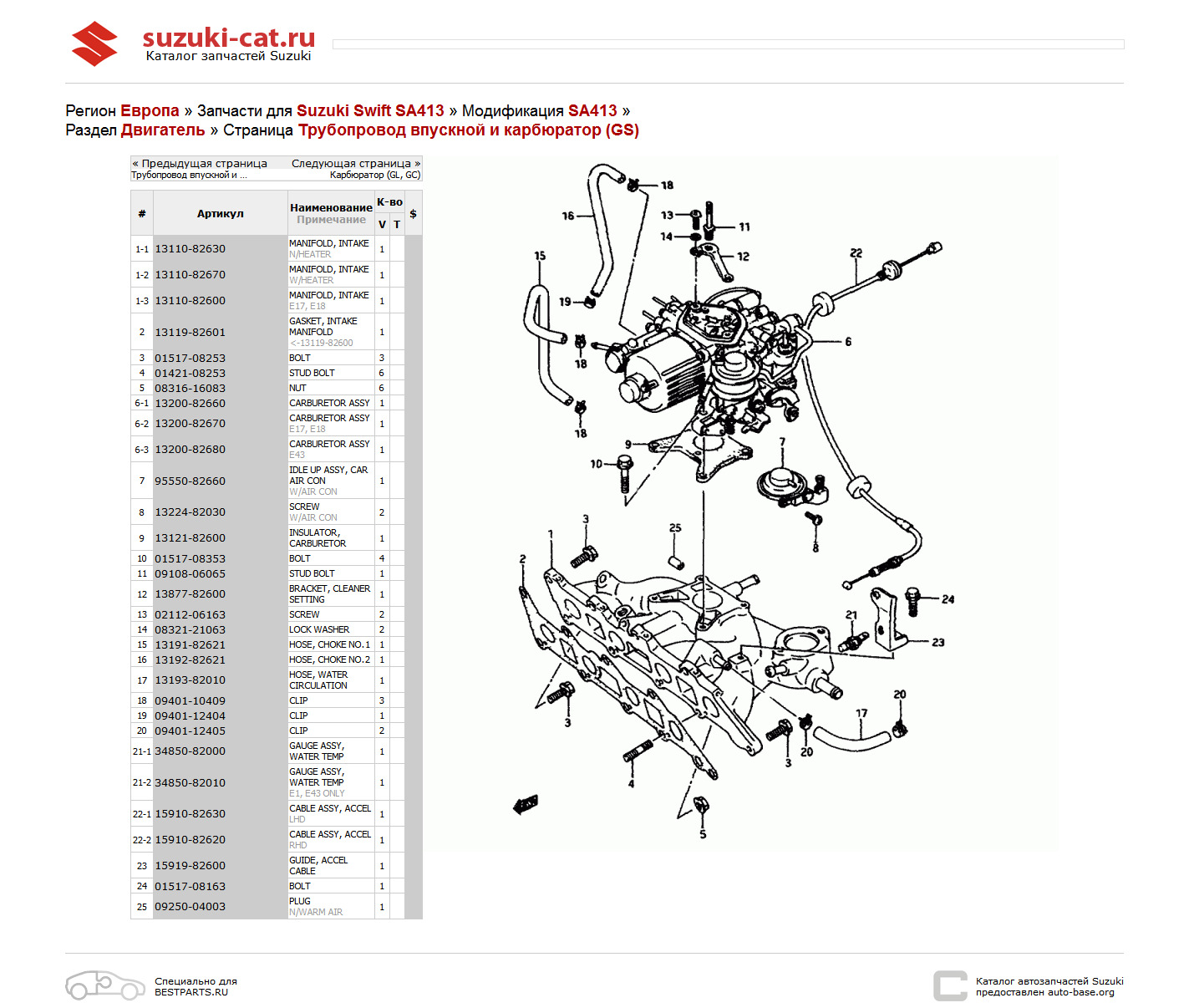

It's from a Swift GS engine.
After a bit of research last night, apparently they are quite rare cars?
I pulled the whole engine and loom etc out of one.
Found this online, but not a very clear picture:
I have a SJ413 manifold and carb in the garage too. It came with my other engine I bought, but after stripping that engine to find it was completely fecked, I'm not holding out much hope for the carb. So opted to try and use this one, as it ran perfectly in the Swift.
Re: SJ410 -1985 'Cabrio', engine rebuild
Post by twiss » Mon Aug 18, 2014 1:36 pm
Did you see if the swift carb fits on the standard manifold?
Suzuki Swift SA413.jpeg (487.71 KiB) Viewed 5756 times
Suzuki Swift SA413 2.jpeg (415.89 KiB) Viewed 5755 times
Post by Darrell » Mon Aug 18, 2014 9:17 pm
Not very clear though :S
Post by Darrell » Mon Aug 18, 2014 9:22 pm

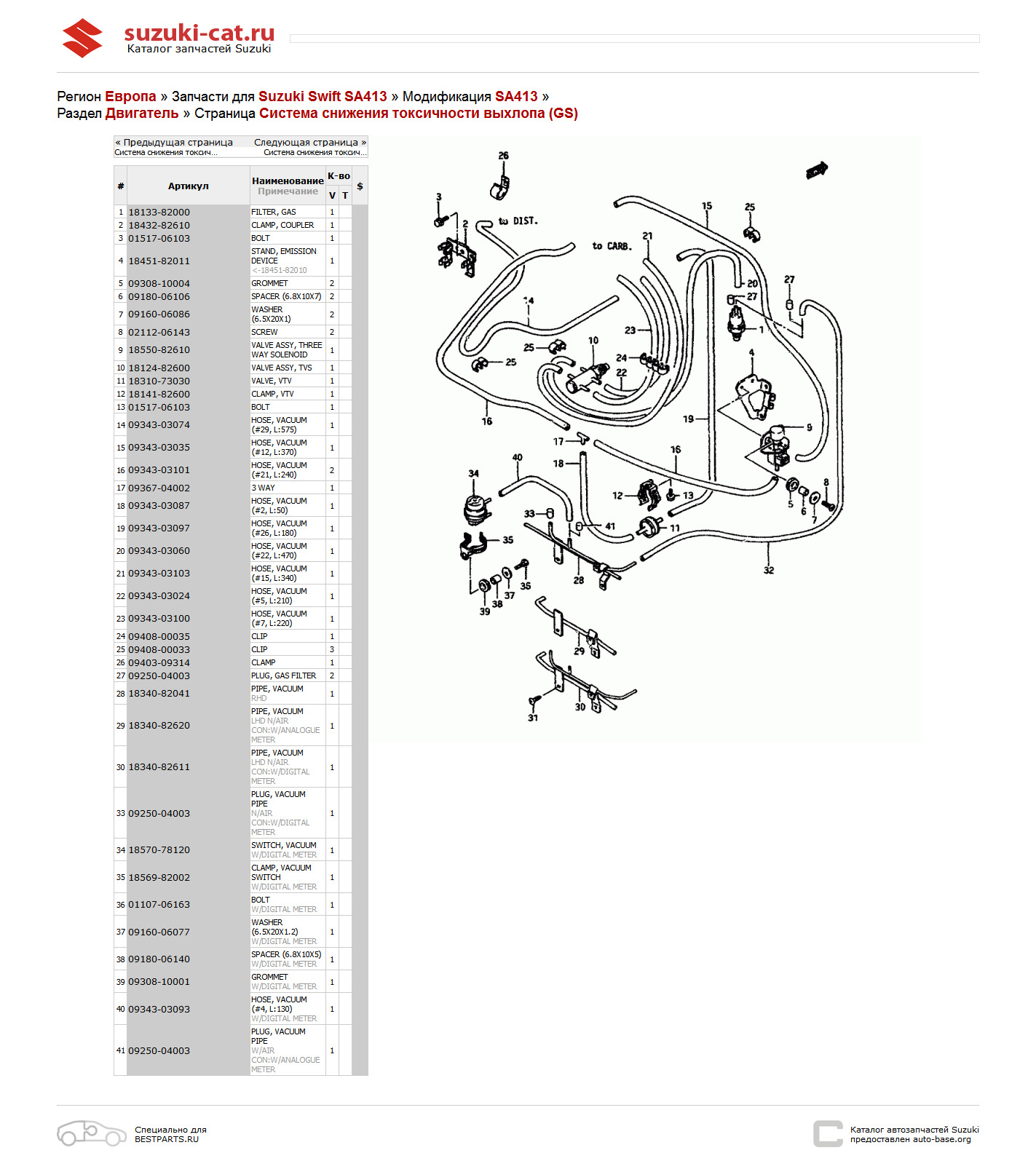

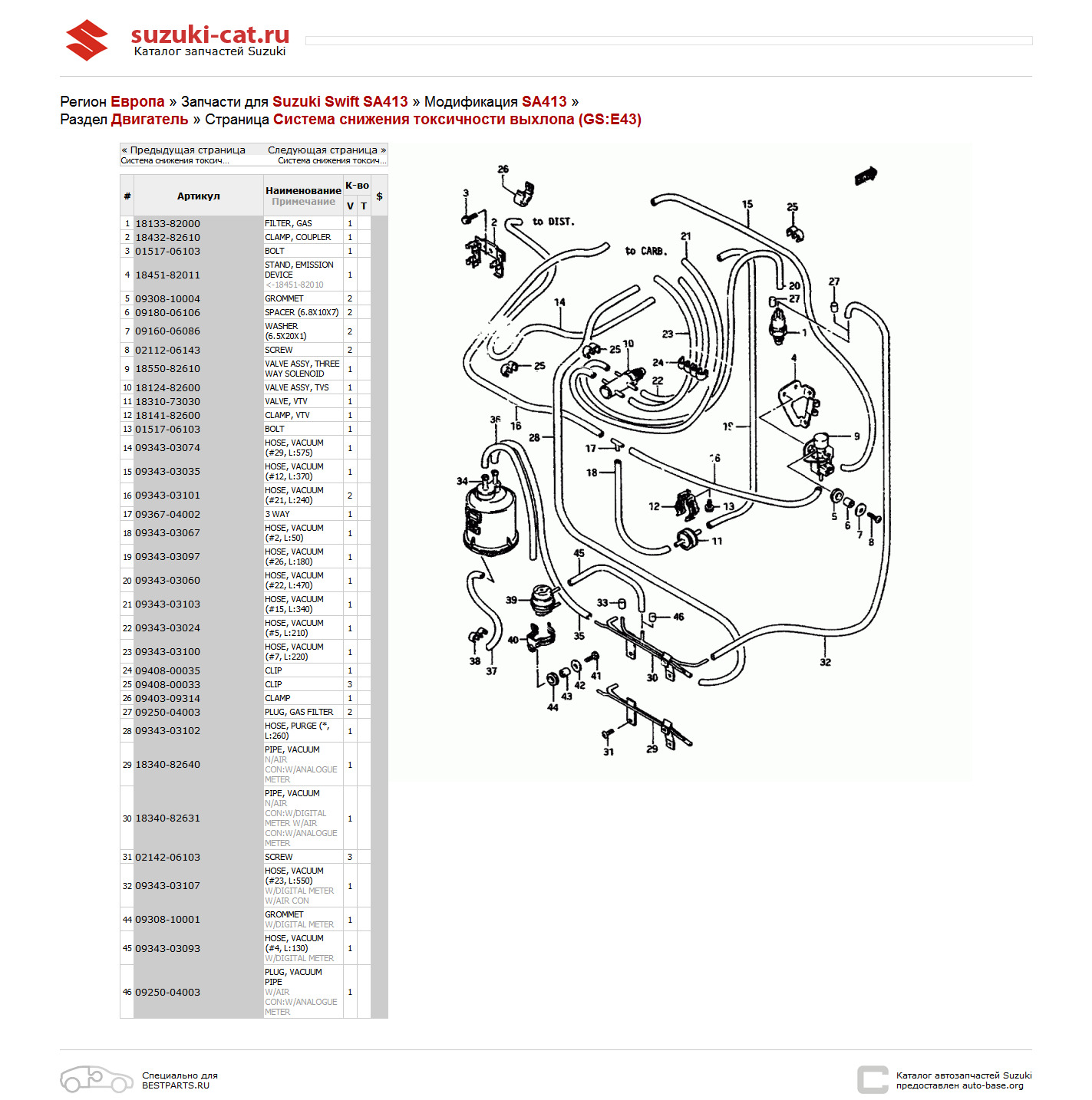

And a couple more showing the GS, don't know what countries there for though :er:
This ain't going to be easy.....
yet another GS.jpeg (477.45 KiB) Viewed 5749 times
gs again.jpeg (498.72 KiB) Viewed 5749 times
