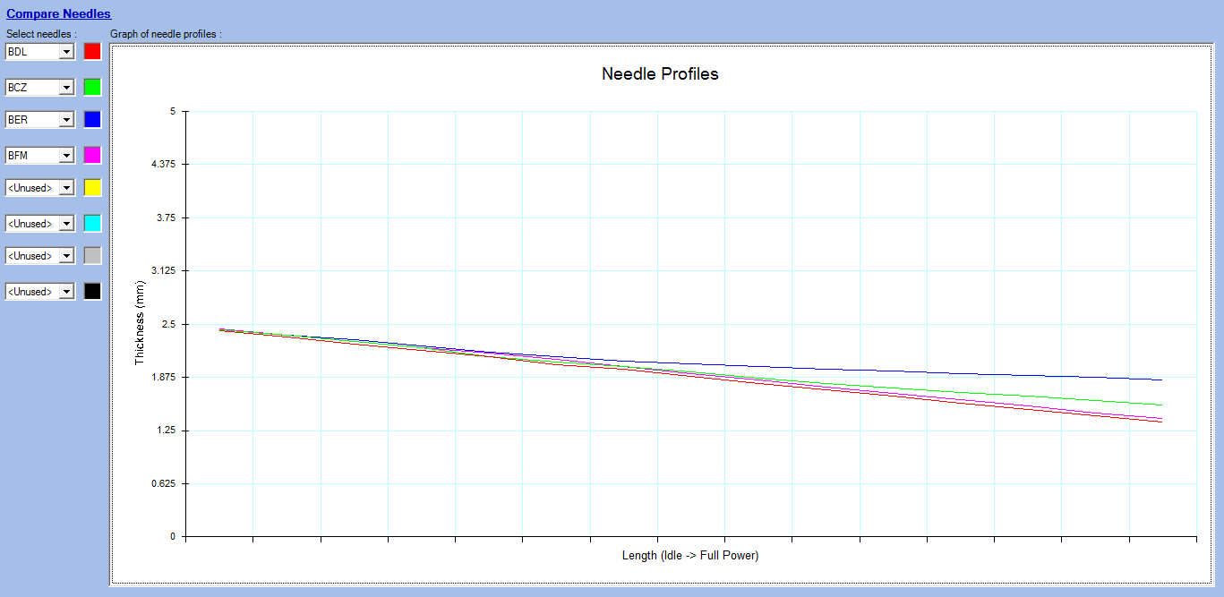

Re: SU Carbs
Here is a graph of various needle profiles...
red - bdl - 1.3
green - bcz - 1.3 (this is the needle rhino ray recommends, i tried one and found it just as good as the BDL)
blue - BER (yours, as you can see, quite a bit leaner at WOT)
pink - BFM - 1.6 suitable for vitara engine
red - bdl - 1.3
- needleprofiles.png (25.68 KiB) Viewed 10380 times
Re: SU Carbs
very handy Twiss the SU man
I'm going to get a BDL, sorted. I understand the vac issue from your notes.
