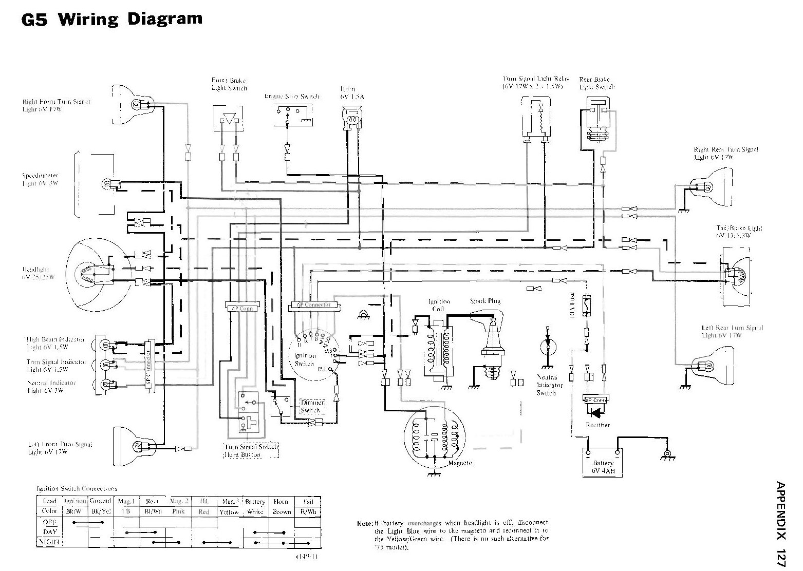

It wont download..I just need the wiring diagram really. Any chance of a pic of that?
Re: Kawazonkey
Post by Darrell » Sun Jan 25, 2015 2:32 pm
:salute:
Re: Kawazonkey
Post by donkeychomp » Sun Jan 25, 2015 5:22 pm
Incredible! Thanks matey!!

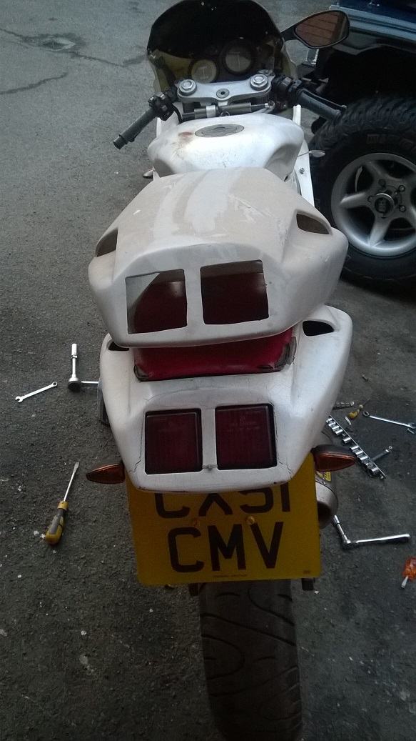

Post by donkeychomp » Tue Jan 27, 2015 1:20 am

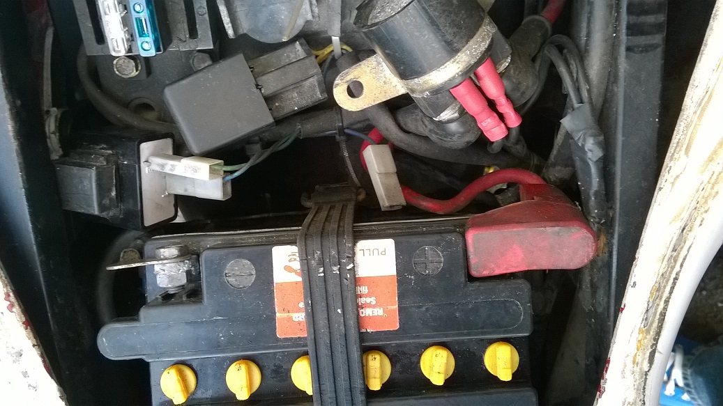

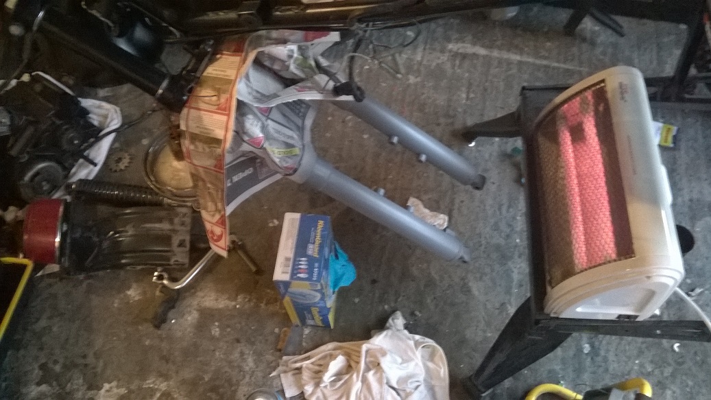

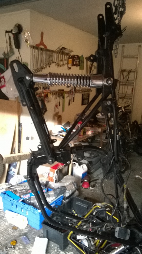

Had a pretty good day today bike-wise. The 'lil Kwak's frame is all done and I am sorting out the wheels...basically a damn good polish with Autosol before they go back on. Once she's on 2 wheels again I'll pop the new engine in. Was a cold but dry night so I thought I'd ride Mia home. Fat chance...the starter kicked in but she wouldn't fire up. Had a look on the web and it looks like the battery is dead, they need 6000rpm to burst into life and it was showing 2000. Opened the covers and it was bone dry..filled it with water and left her on a charge. Hope I don't need a new battery as they are a little dear..
Re: Kawazonkey
Post by donkeychomp » Tue Jan 27, 2015 7:57 pm

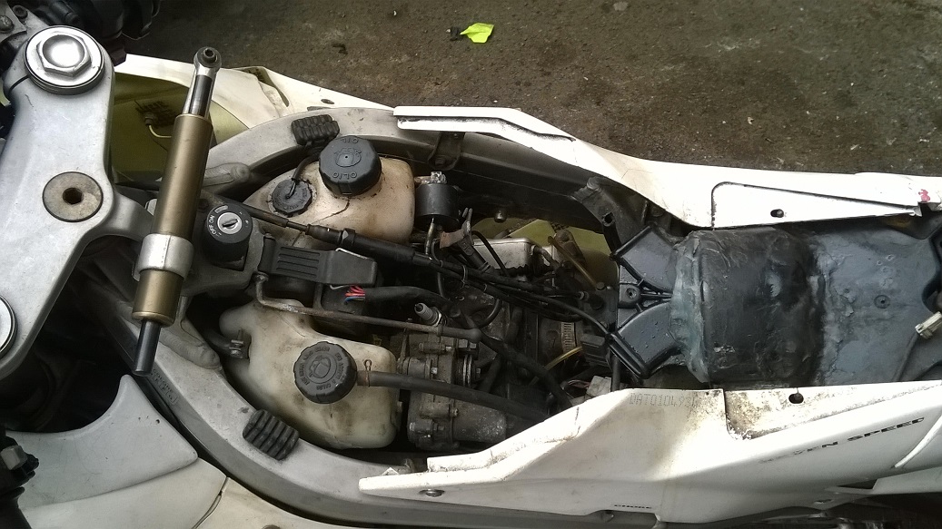

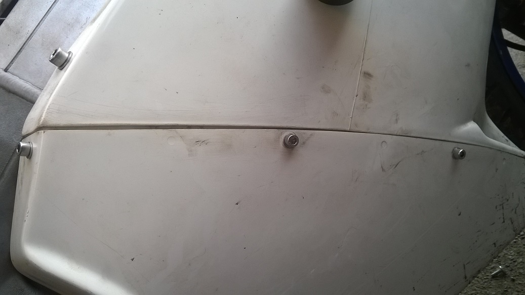

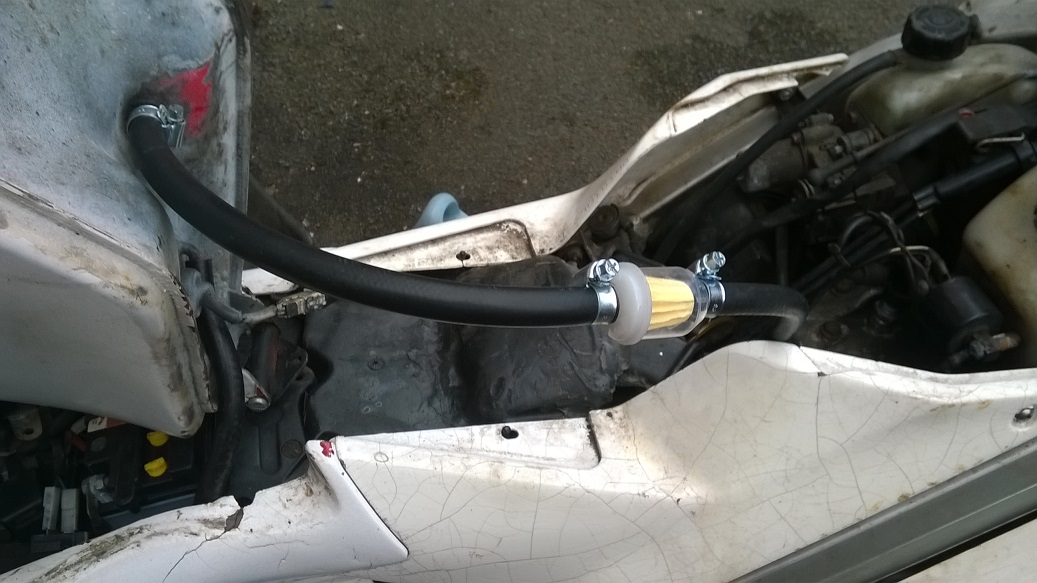

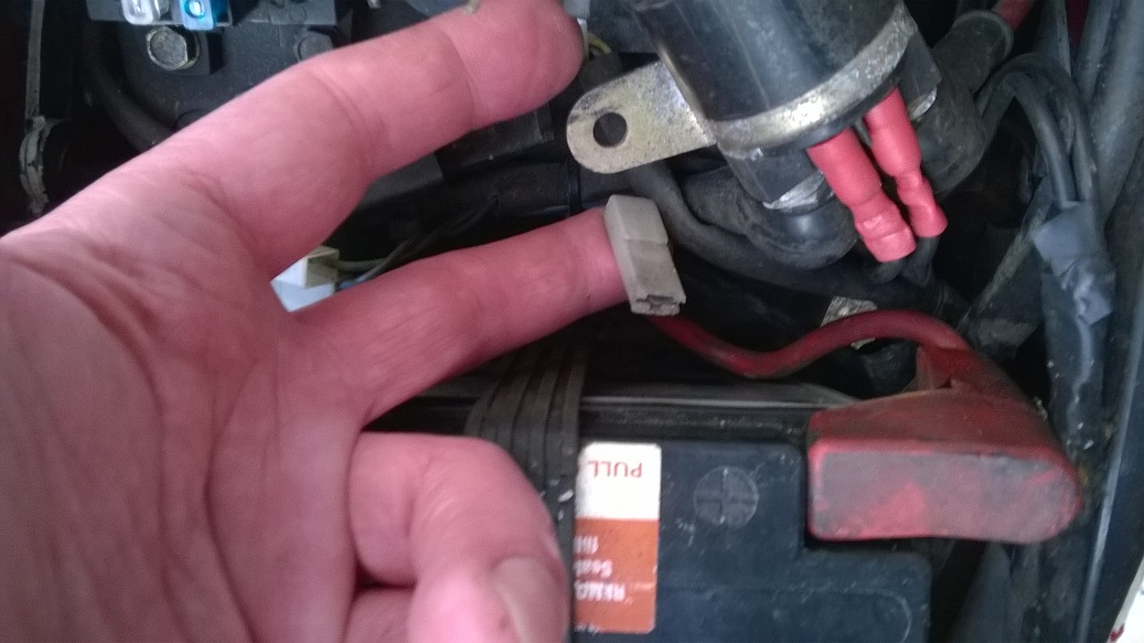

Well the battery is fully charged and still she won't fire up. Started taking off the panels to access the engine and I noticed a little clip on the petrol tank...it's hinged! DOH! Took out the plug, seemed fine and it's getting a spark. Changed the crap fuel lines for new and she's getting petrol into the carb...thought there would be a fuel pump but it's gravity fed..but the starter motor only cranks for maybe a second then dies...reckon she needs a new one. That's 2 vehicles now without starters! I replaced the 'bolts' on the fairings with allen ones but I really need the dome shape variety. Oh and a little wire not connected to anything. Hmm. 'lil Kawazonkey coming along lovely. I'm painting the forks gloss black as the chrome there is a little to far gone on one leg.
