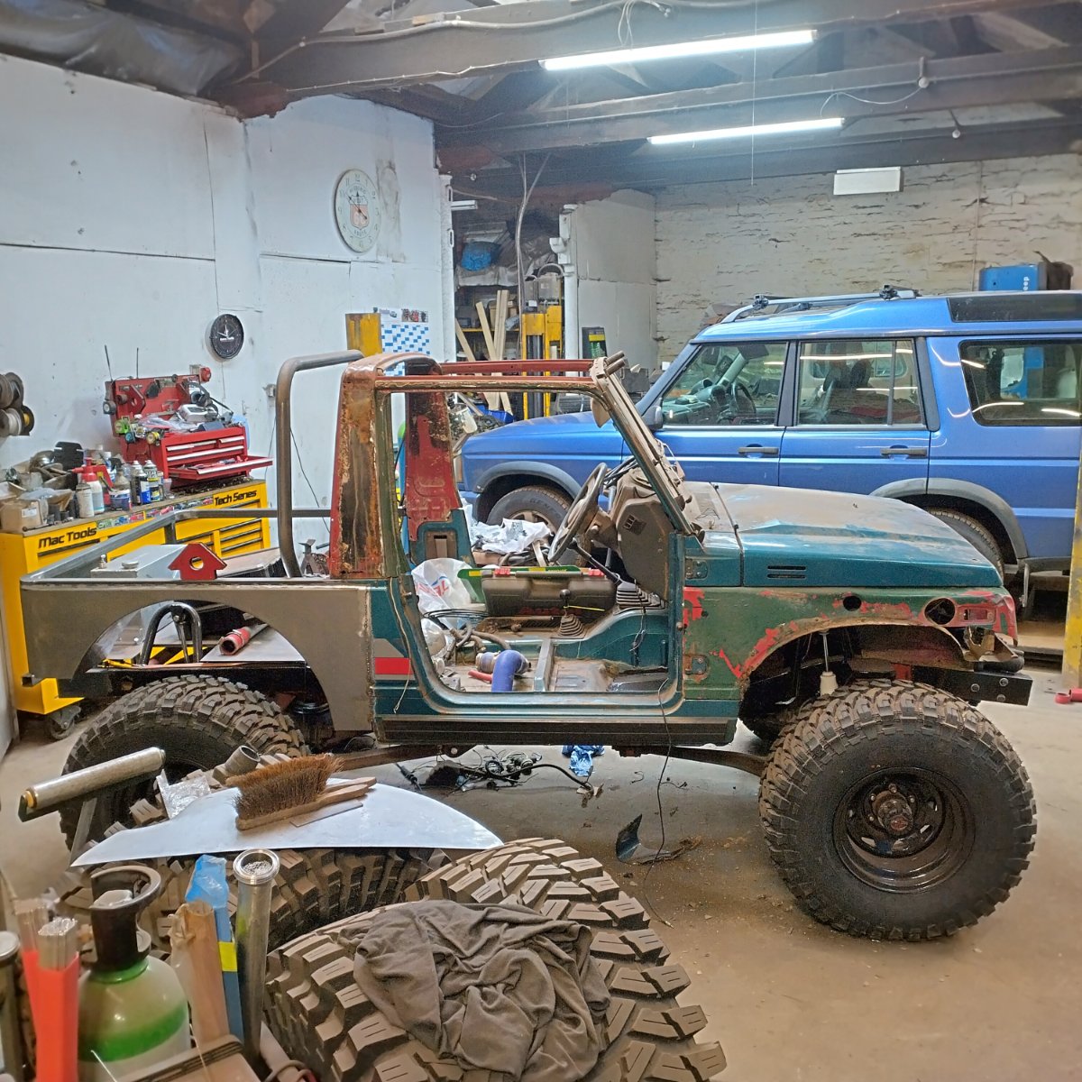

The plan was to do the back end of the LJ270 like this so it won’t really have a roof….just a bit of aluminium to meet comp regs :lol:
I’m presuming you are going to run into issues with a roof and the cage B hoop hence the question? You could cut strategically placed holes with a slit into the soft top and then seal with a flap of rubber (or wetsuit material) sewn in and some Velcro flaps.

Well as a quick fix I bought a new roof from India that is a soft top but changes it into a pick up effectively. That will work how it is now but ideally I'd like to have a full roof in the end.

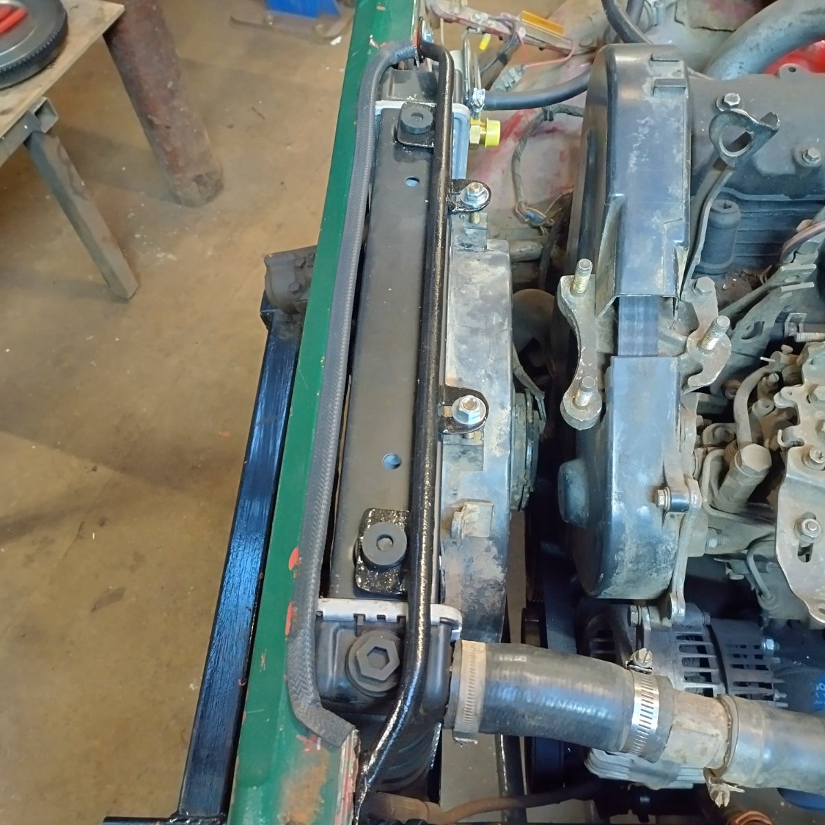

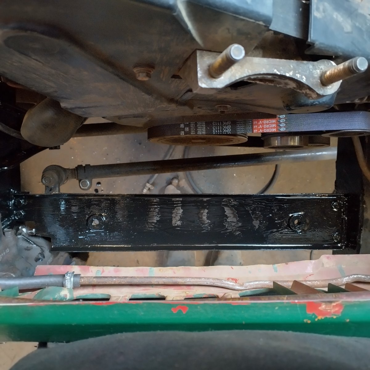

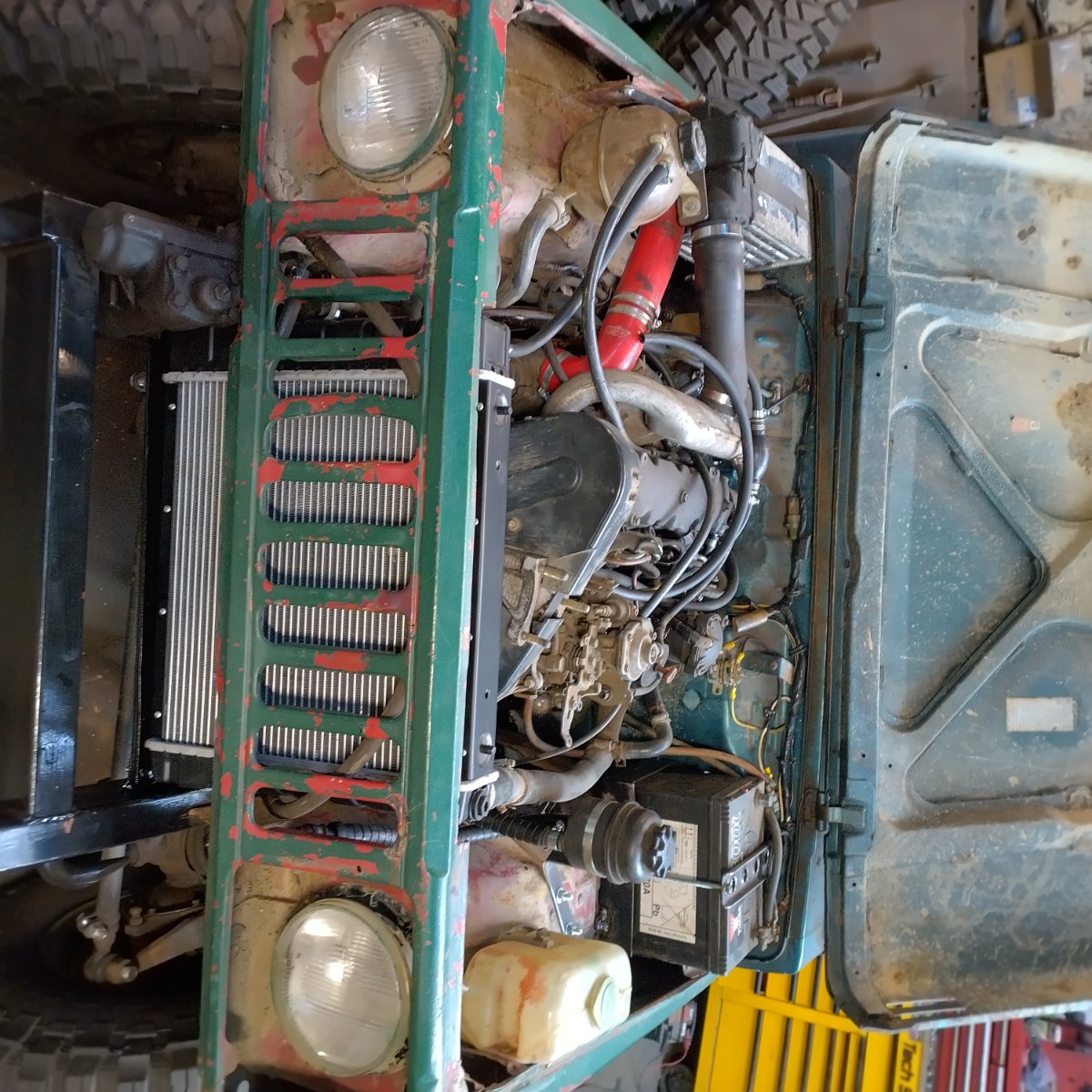

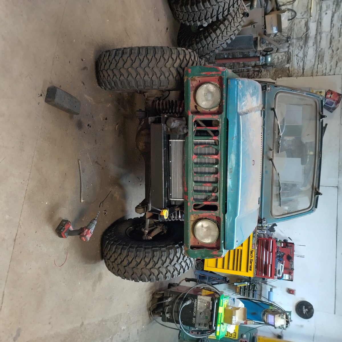

Braved the cold today and got a few more hours in.
Welded some tabs onto the chassis and made the bottom radiator bracket, I folded some 3mm steel and fit some oe land rover rubber mounts for the 200tdi radiator.

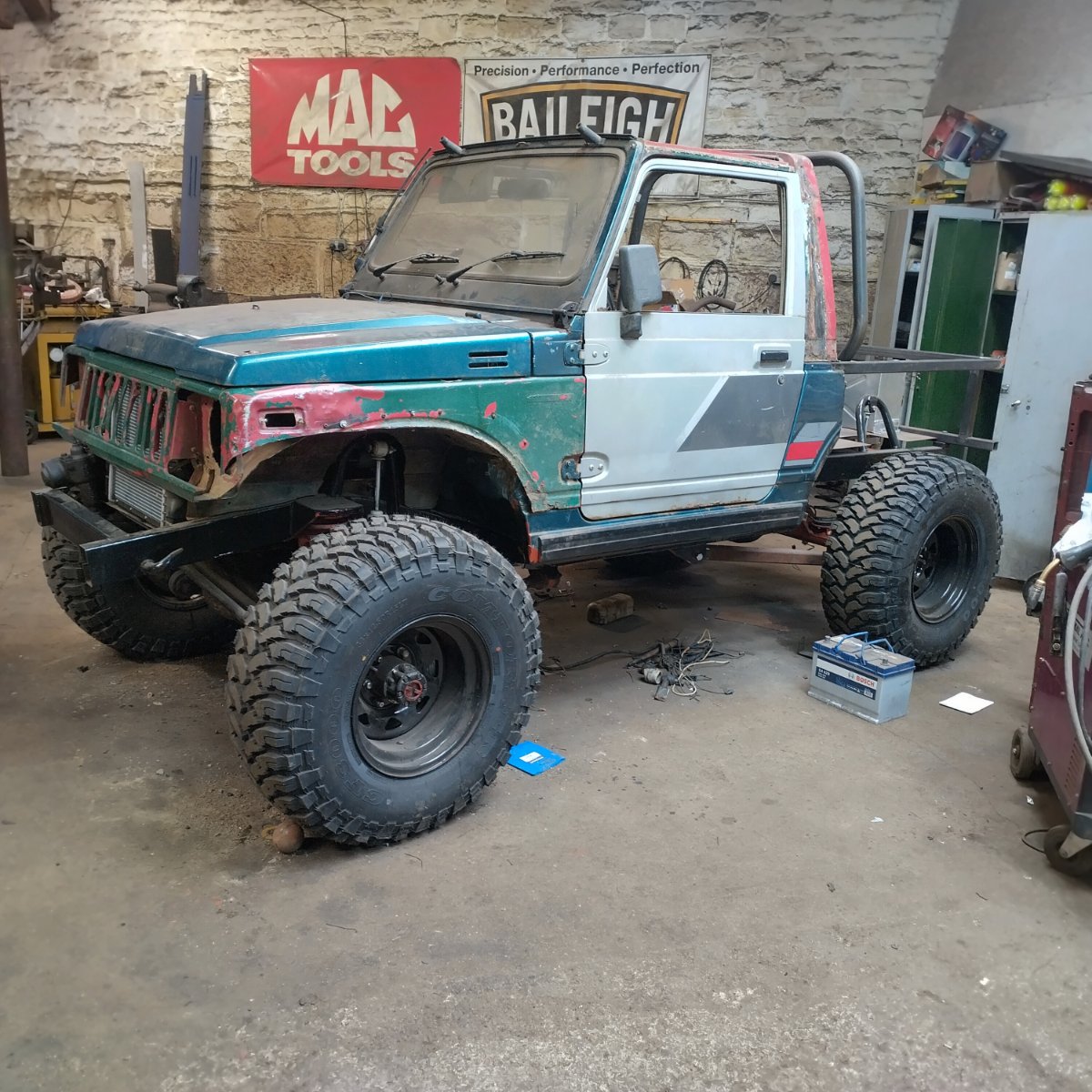

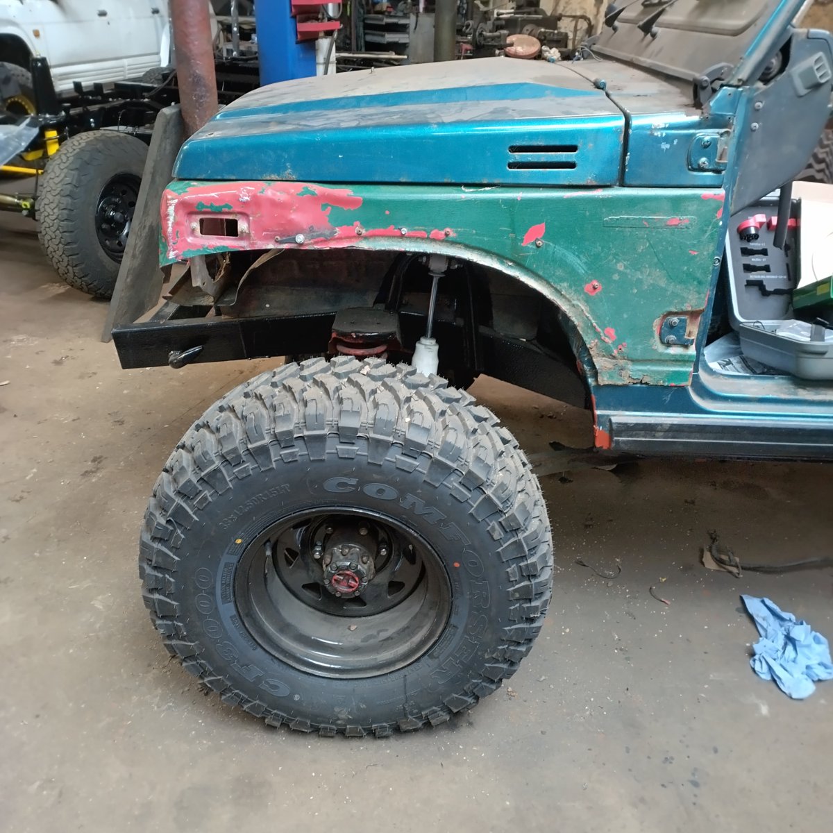

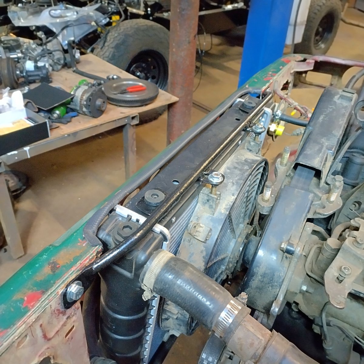

Post by d_r_1989 » Fri Feb 10, 2023 11:08 am
Radiator and fan now mounted finally, made a little bracket that holds the top of the rad straight and the slimline fan.

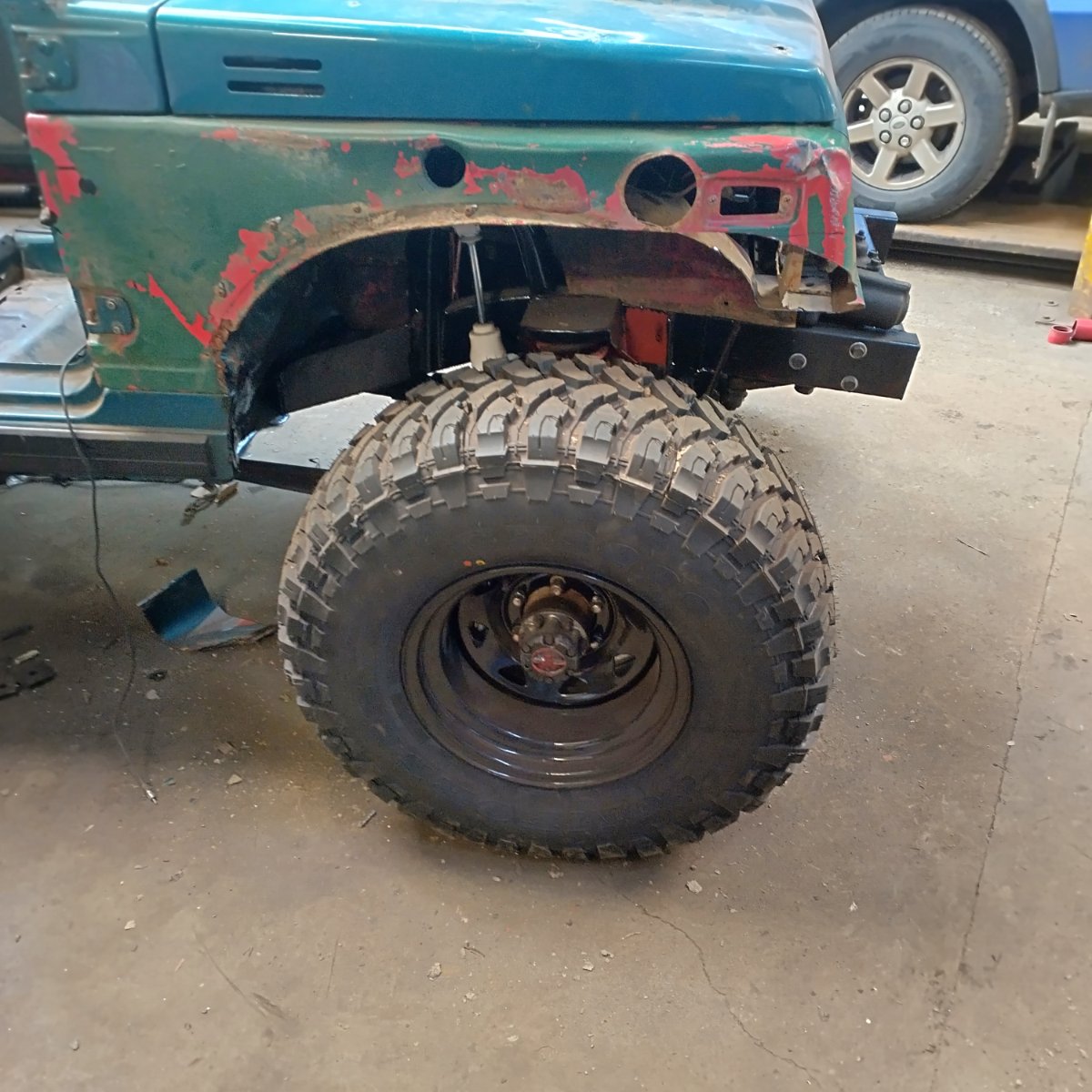

Started to cut the front arches out to give clearance for the extra wheelbase on bump.

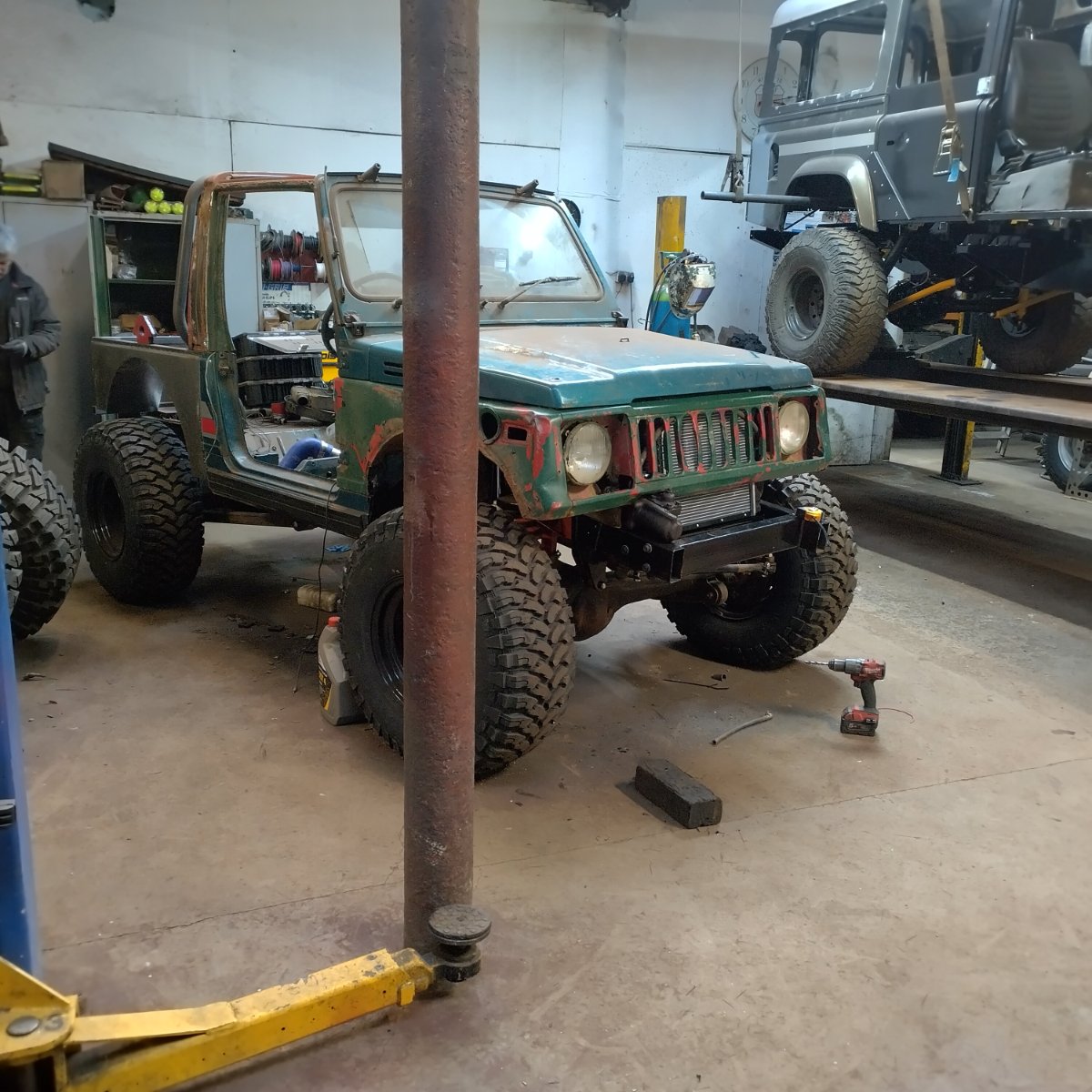

Just waiting on James to finish the rear cage so I can carry on, it's ready to run and drive when I put some fuel in.
The door was on just to check everything lines up, which it does
