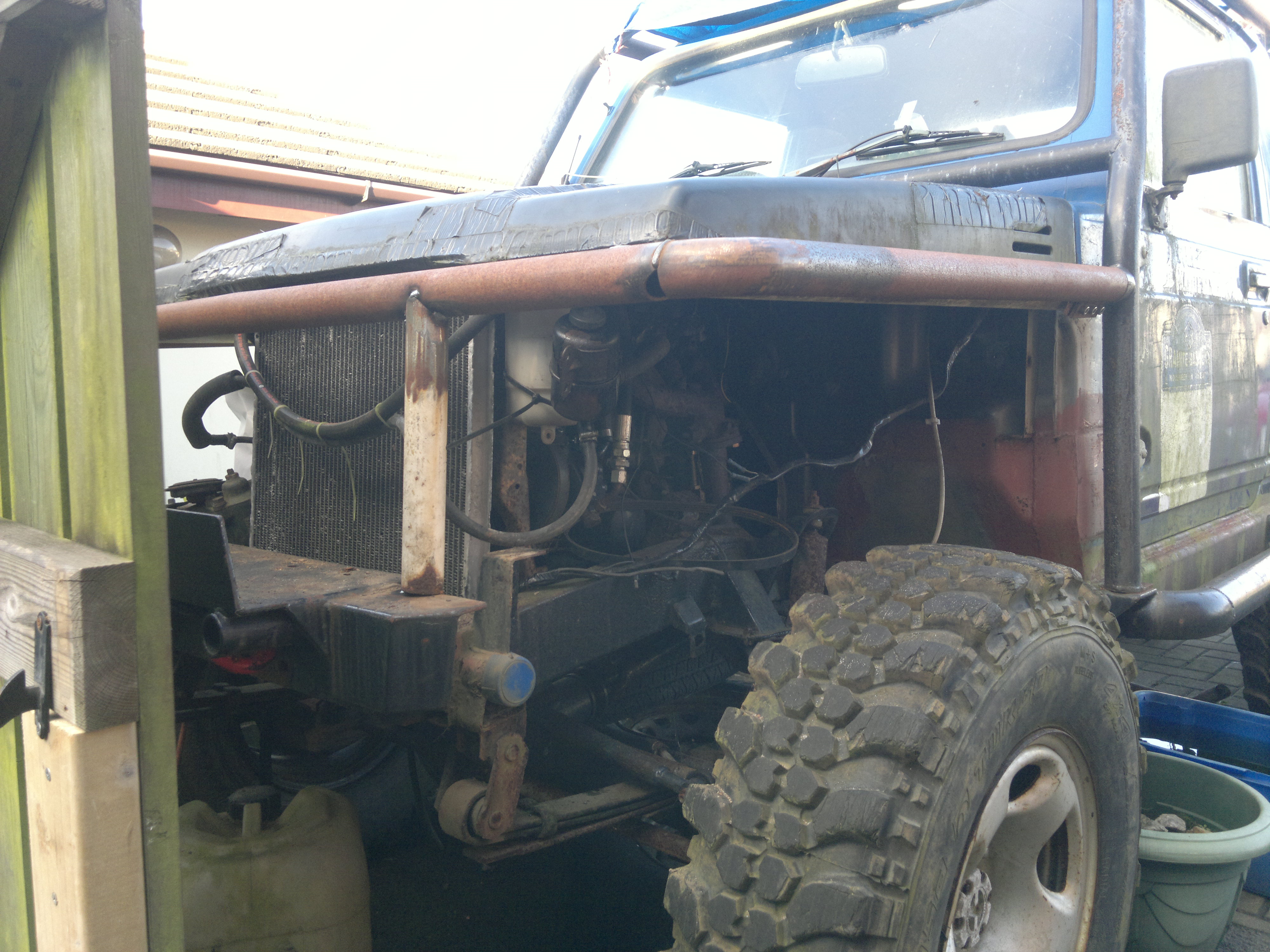

right then folks after a forced leave of absence(working in the land of all things zook), i'm starting work on the old girl again.
well when i got home i wasn't too sure if she'd start, but charged the battery over night ang she started first time :armsup: , so time for a few lanes, followed by an afternoon down at the p+p, well the tubes that went around the front clip worked but not as well as i'd hoped, i was going to do similar to scottie j and trim the wings but after a momentery loss of concentration the front pass wing got stuffed into a low tree stump, hard enough to cripple it, crack the light lense and tear the bolt at the front though!

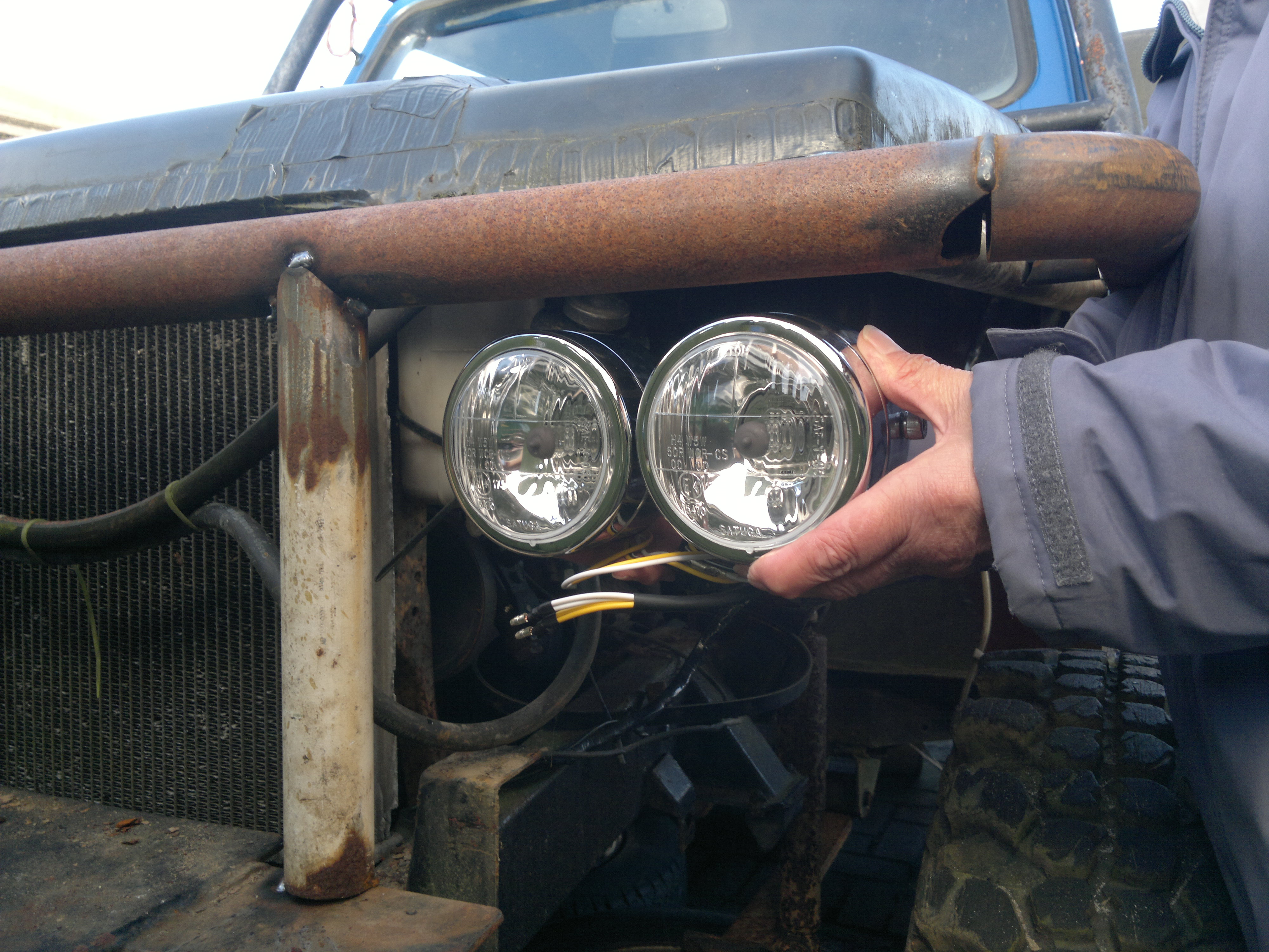

really need to paint it, oh well she isn't supposed to be pretty. a quick look on the bay bought some lights that'll end up here
these will be protected by some more tubes around them.

Post by turbo-tom » Sat Dec 08, 2012 10:20 pm
glad to see your working back on her giving her the treatment she needs :thumbup:
what company did you get the lights from? could you send me a link please ? thank you tom

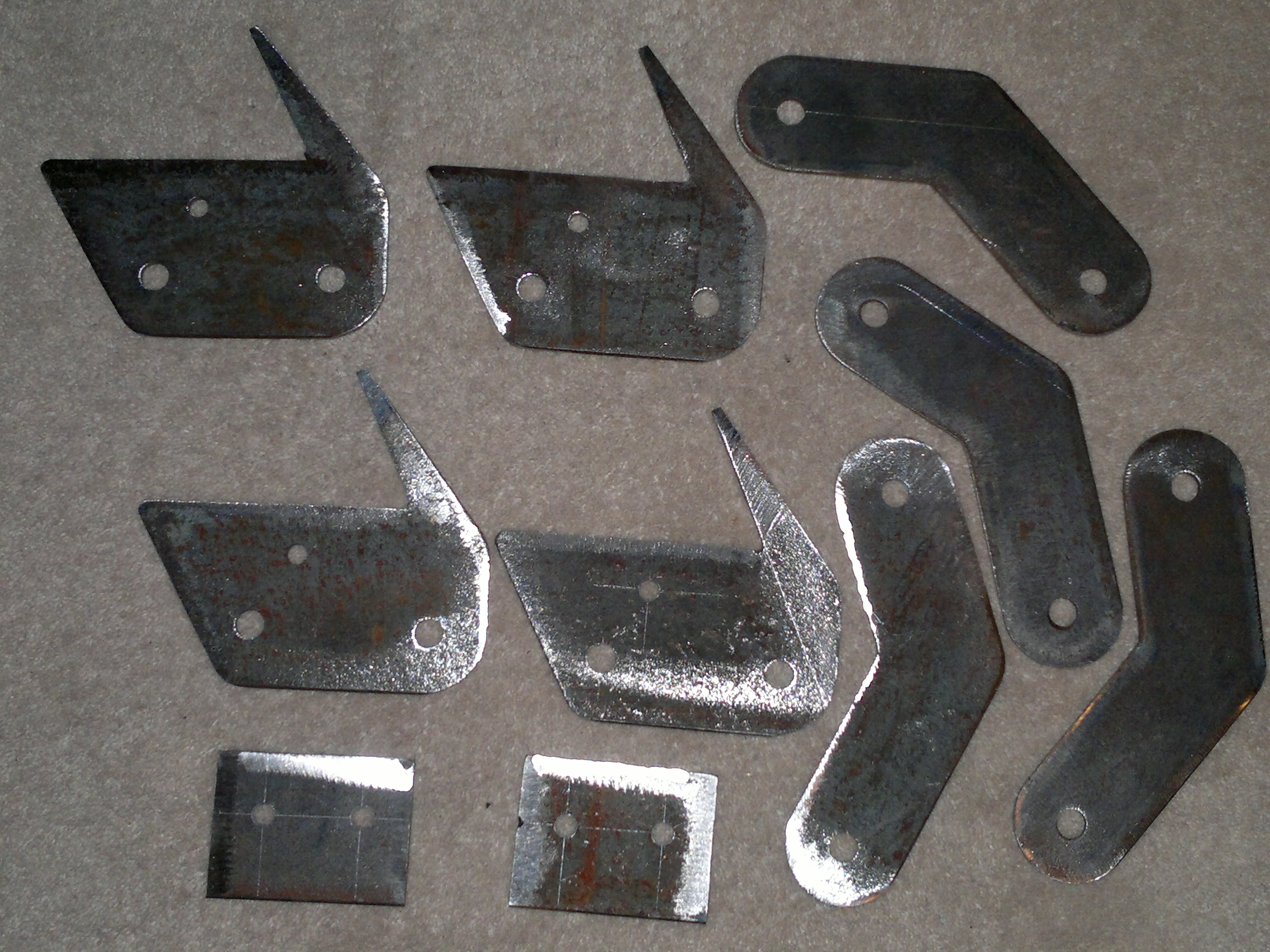

well folks it's been a busy week or so, but that hasn't stopped me getting a few bits done over the lunch times
got these cut and drilled over a couple of days, spacer sleaves made so that i can jig them for welding, also decided that one more leaf can come out of the hi lux spring packs as they felt really stiff on the bench. will get a decent pic of the missing links and post it up over the week end, glad to be moving forward again all be it slowly.
