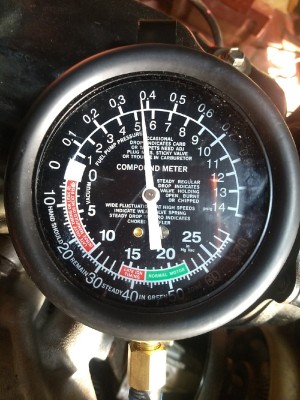

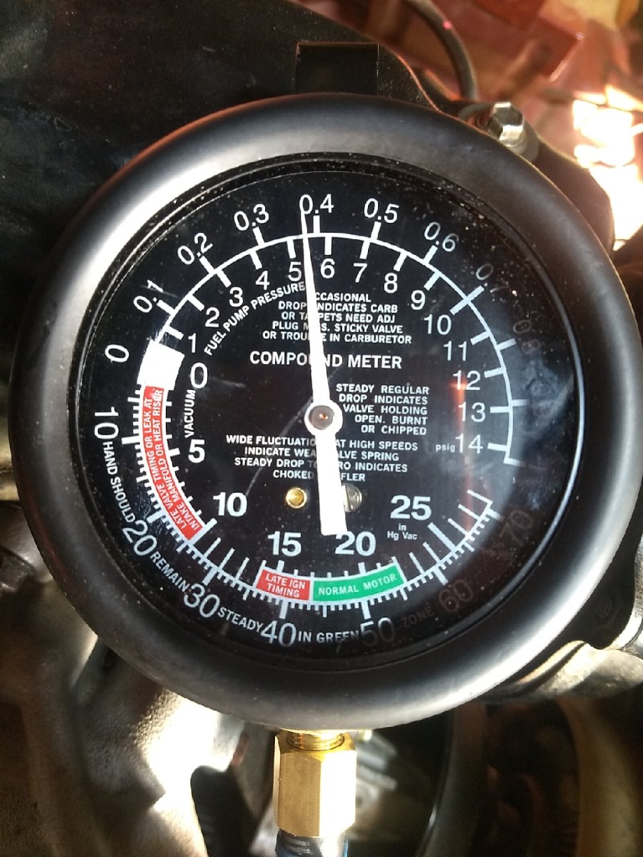

Finally found a few minutes to have another look at this, stuck the pressure gauge on the new pump just for a sanity check and it's bloody putting out more pressure than the old one!! :argh:
Showing just shy of 6psi when it should be 2.1psi!
No wonder it was pushing fuel past the jet.

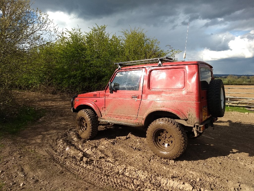

Thanks, was nice to get the wheels a bit muddy on a few local lanes today!

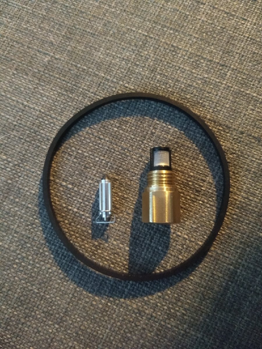

Rechecked the fuel pressure and still good at around 2psi. Reckon it has to be the float needle valve now, although the viton tipped one that's in there looks ok. I've ordered new needle valve and housing so will see if that helps! If that doesn't work I'll replace the float but it looks perfect and it's set correctly too.

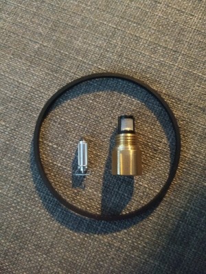

Just arrived today, fingers crossed these will fix her up!
