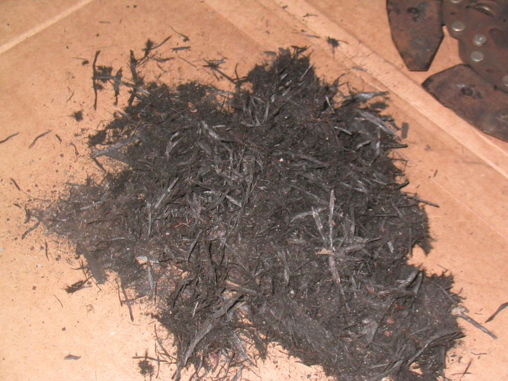

See if you can wiggle the gearbox input shaft... if you can, its goosed!
When there is enough room to look straight at the clutch I don't bother with the tool, just make sure its all lined up round the edges and in the middle
This is what a good clutch plate should look like:
Old clutch looks like this:
and this:

Yep mine clutch looks like the old one i didnt get all that other stuff come out of it doh new clutchshould be here today so will be giving it ago

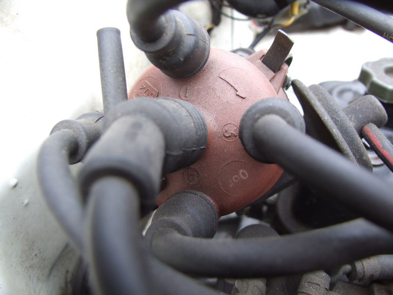

not sure if you can fit the cap 180 degrees out :er:
Re: Problem is it diff or prop shaft
Post by twiss » Sat Mar 24, 2012 4:57 pm
So the starter motor turns round but it doesnt fire up?
The cap does physically fit on the wrong was around, so its worth checking that. If its a brown dizzy cap there should be an arrow on it (arrow goes at the top)
Post by Darrell » Sat Mar 24, 2012 5:03 pm
like so ...........

Mine isnt the brown one and yes the starter motor turns and theres spark from soark plugs but just not firing up
Post by twiss » Sat Mar 24, 2012 7:17 pm
Well basically, the lead that comes from cylinder 1 (front of the engine) should be at the top
