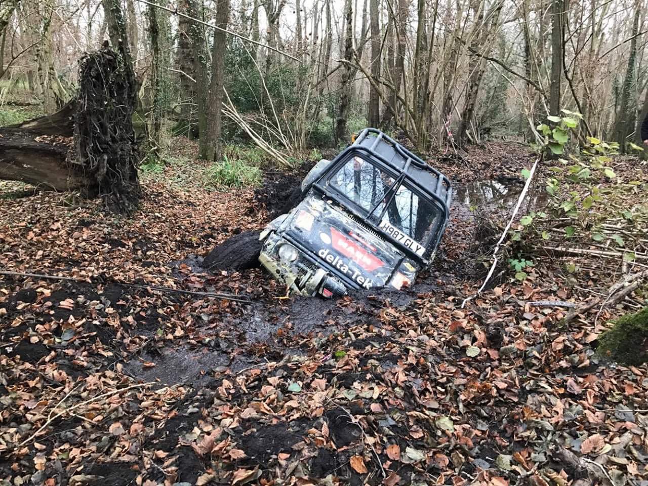

Very battered now

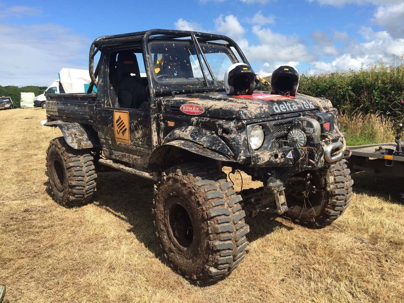

Last event I did i poked a hole in the rad and it overheated to the point it seized so it's new engine time
Also got a hole in braided brake line
Transfer box pops out of 4lo
Intercoms stopped working
And stopped charging !
Few bits to fix
Few bits to fix

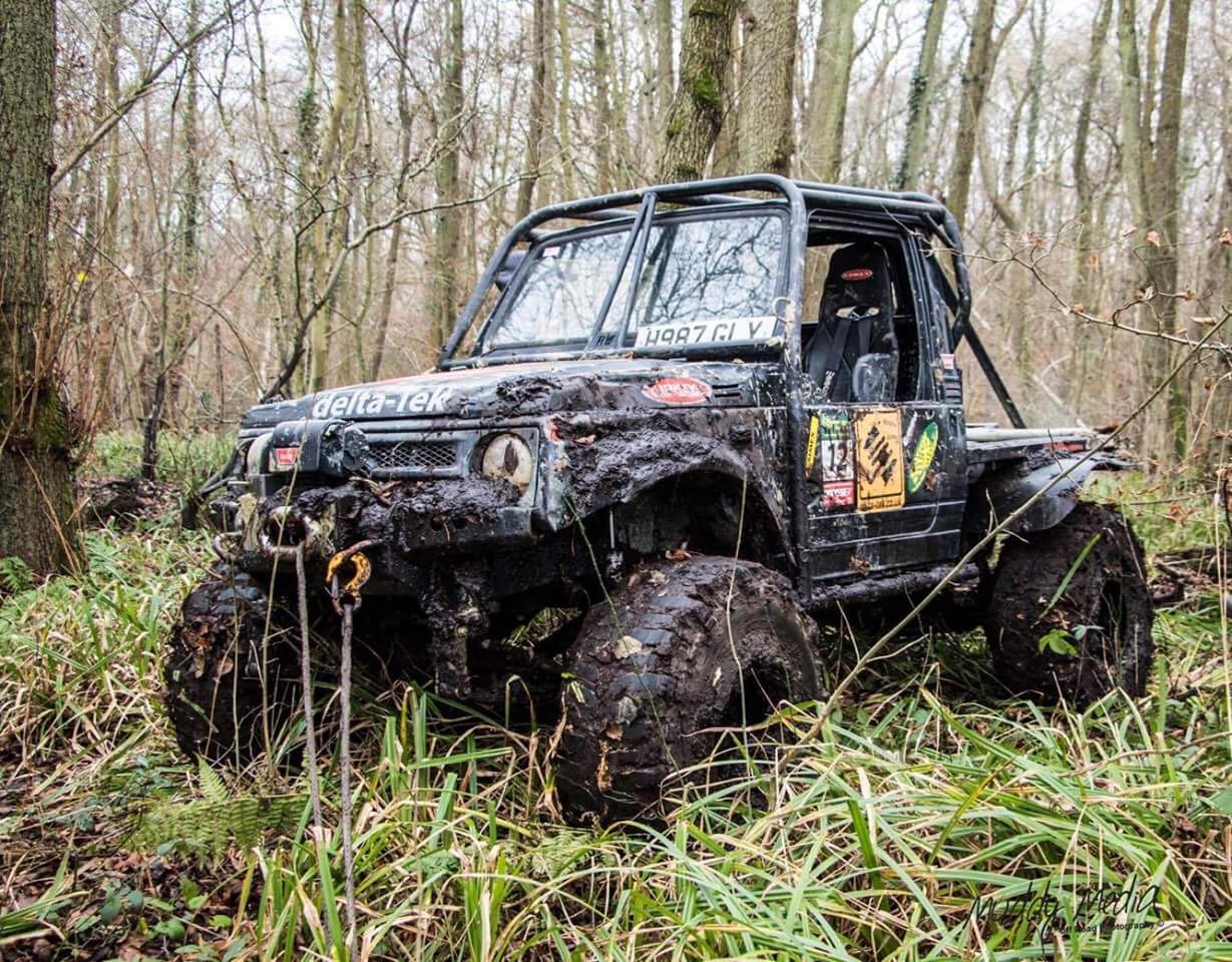

Il try and get some pictures up, very badly beaten after some bad roll overs, ripped the front shock mounts out of the chassis and tore massive holes in the actual chassis, ripped the front of the transfer box of as well !!
Just came 4th at a challenge south west event which was good.
Pleased with how it's going, china air locker to try in the front soon

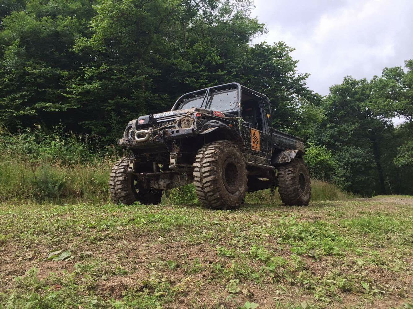

I had a couple of texts from people asking about the spec of the truck, thought I'd add one on here just in case anyone wanted to know what it's running now, or what's been done.
Suzuki samurai Lwb chassis
Suzuki Kja sj413 cab
Suzuki super carry bed with sides
1.6 16v vitara engine
Sj413 gearbox
Paddle clutch lor
Trail gear 6.5 to 1 ratio transfer box twin stick convertsion
Rockwatt tbox cradle built in spine
Walbro fuel pump
Hudraulic Handbrake
Vitara Lwb brakes all round vented discs
Rear springs up front
Trail tough Missing link front shackles
Trail tough 3 inch lift shackles
3 inch old man emu rear leaf springs all round
Rough country nitro shocks front and rear
Braided brake lines plastic coated
Spoa, trussed samurai axles with knuckle gussets
Rob Storr Full floating rear axle
Rcv 33 spline front half shafts and cvs
Front and rear lock rite positive locking diff locks
5.38 ring and opinions
Rob Storr solid crush collars
Rob Storr hi steer kit
Toyota Land Cruiser prop shafts
Warn premium free wheeling hubs front and rear
Art off-road 11 inch wide wheels 10 inch offset with beadlocks
37/13/16 tsl super swamper boggers
Rockwatt external roll cage
Kirkey aluminium bucket seats with harnesss
Vitara v6 power steering
Twin batteries
Warn 8274 modified winches
Arb air compressor

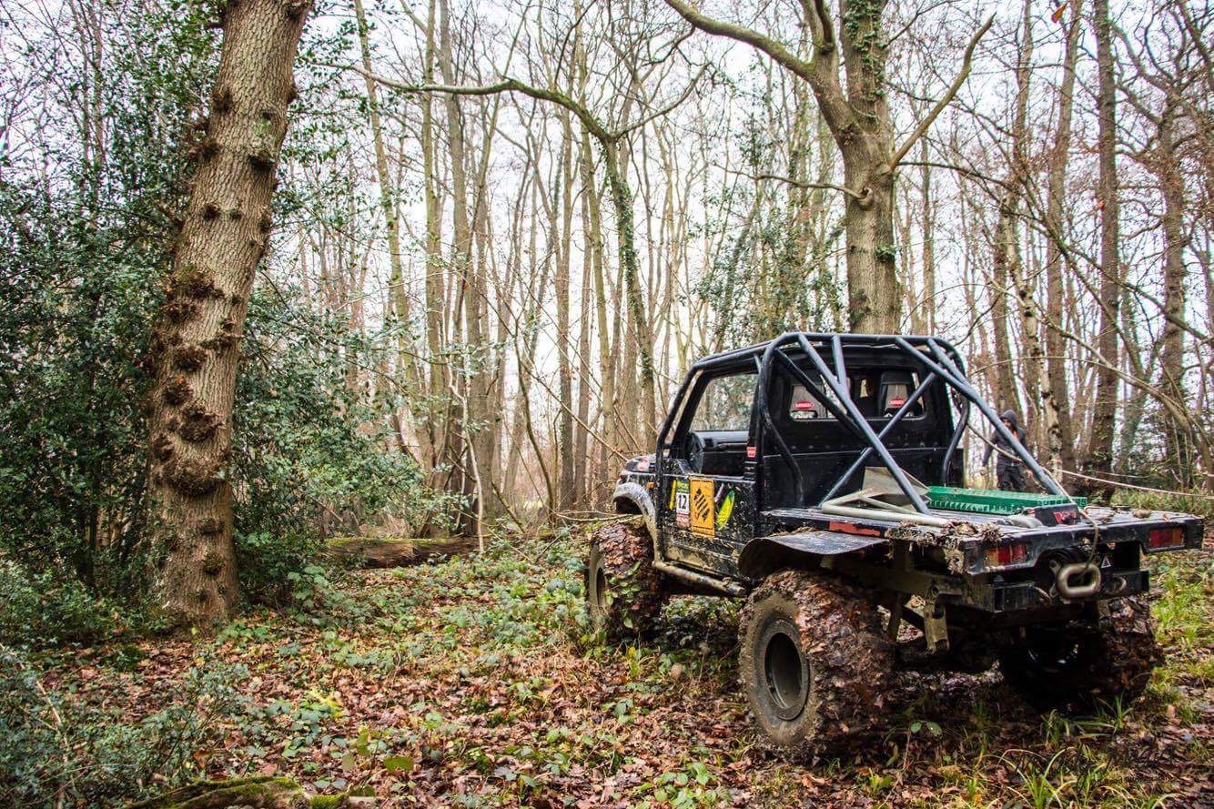

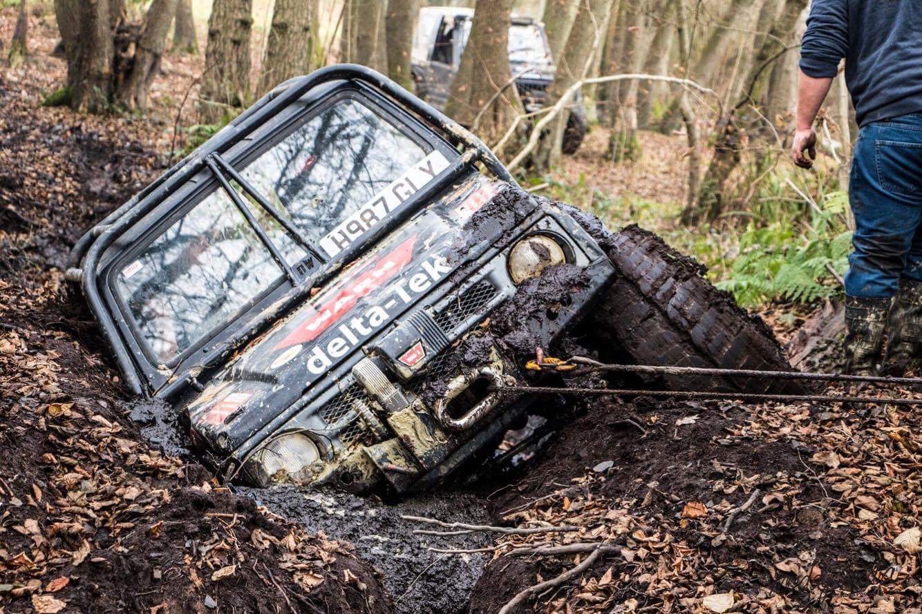

Mud
- IMG_0469.JPG (464.87 KiB) Viewed 7886 times
- IMG_0468.JPG (431.64 KiB) Viewed 7886 times

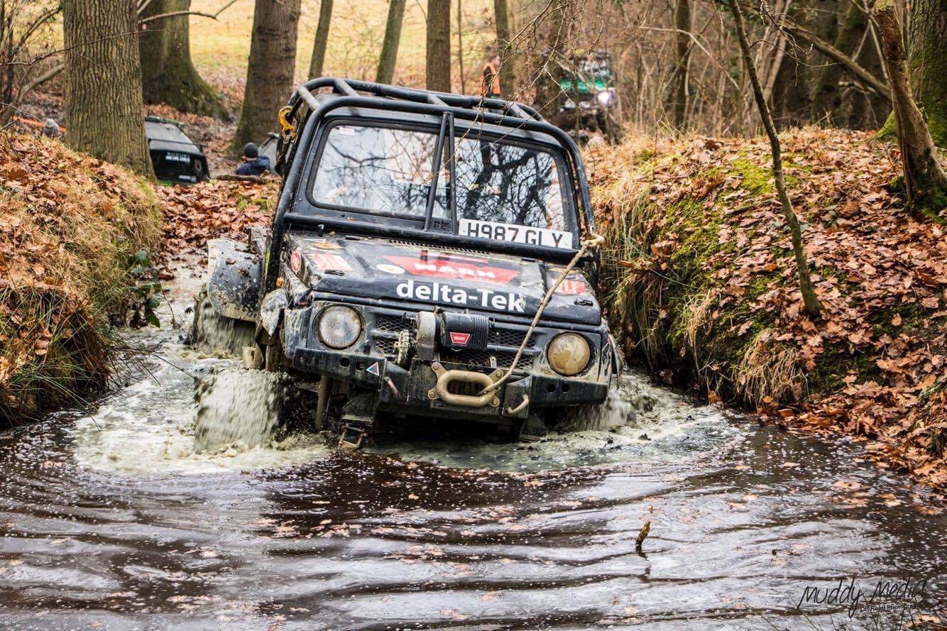

Battered !

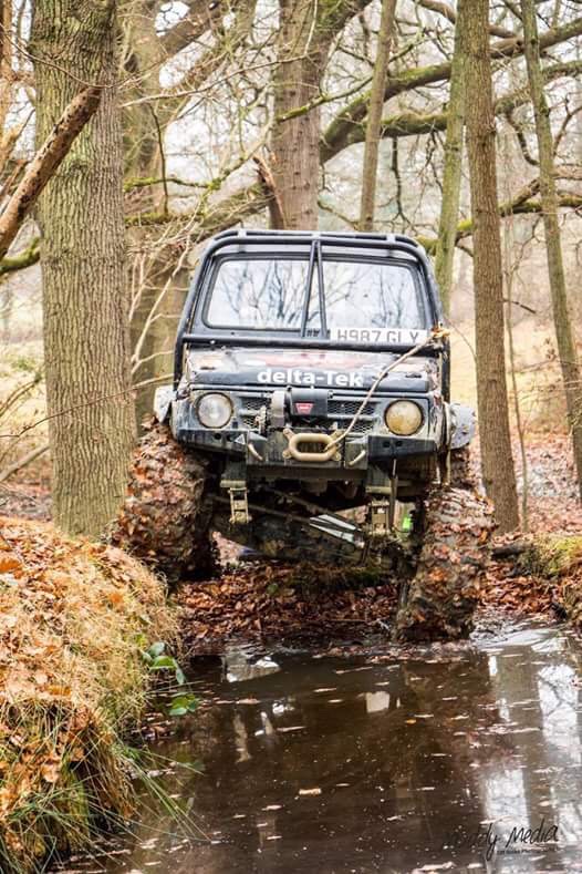

Mud
- IMG_0471.JPG (506.7 KiB) Viewed 7883 times
- IMG_0470.JPG (609.83 KiB) Viewed 7883 times
Good to see it out for a play
that site looks boggy as hell
