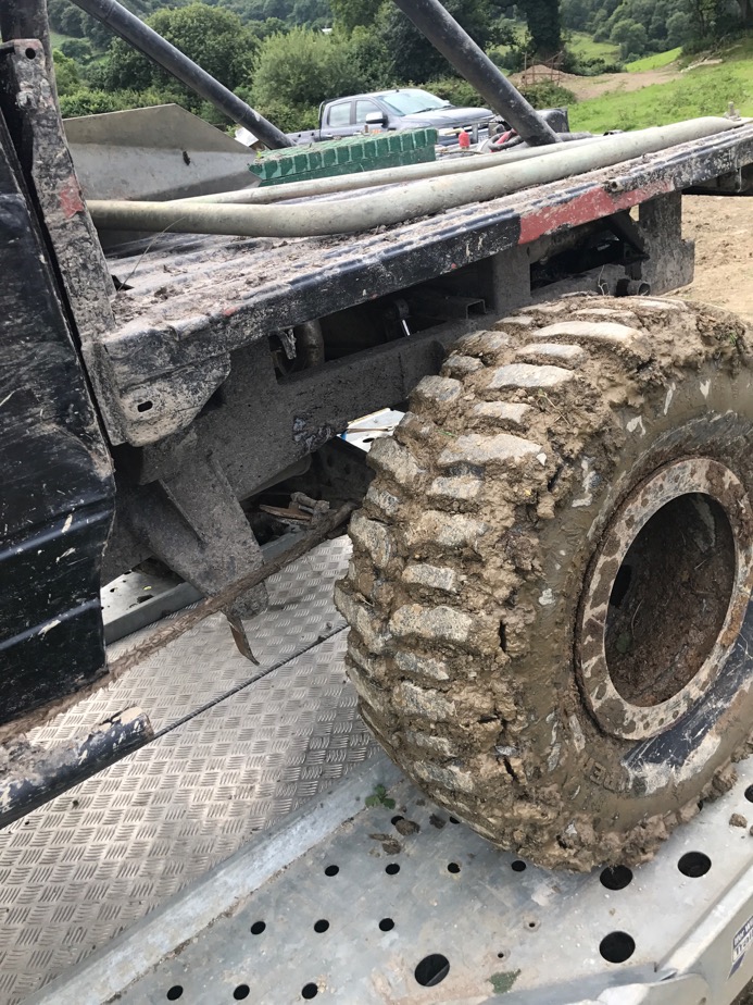

i'm guessing the missing link gives it a bunch of lateral movement it doesn't like? where do the springs snap, at the eye or the axle?
Re: Mikes kja hybrid challenge truck updated 07/06/2017
Post by mike harris » Mon Aug 07, 2017 6:45 pm
Rear one bud !!! Missing links are mint think there the best thing ever, rear spring that broke half way along :)
This truck probably sees more use than any other suzuki in the U.K. That's still a suzuki setups base, so I think it's doing pretty well to be fair.
My trucks fine it's just the abuse during challenges and my rubbish driving caused the roll, spring broke in a gulley but has probably been on the way out for a long time.
In competition stuff gets broken, these springs have lasted me a long time last one I broke was on my red truck ! And they where second hand like these ones I've broken !!
Set of four new ones on order job done, new hub I have in my garage lucky the warn hub wasn't damaged which is sweet, and worked out why it didn't run right the air flow meter came unplugged lol

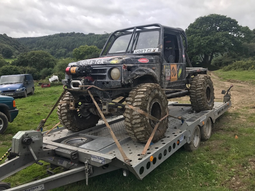

Post by mike harris » Mon Aug 07, 2017 6:54 pm
Bless him !
Post by mike harris » Mon Aug 07, 2017 6:56 pm
Bang !

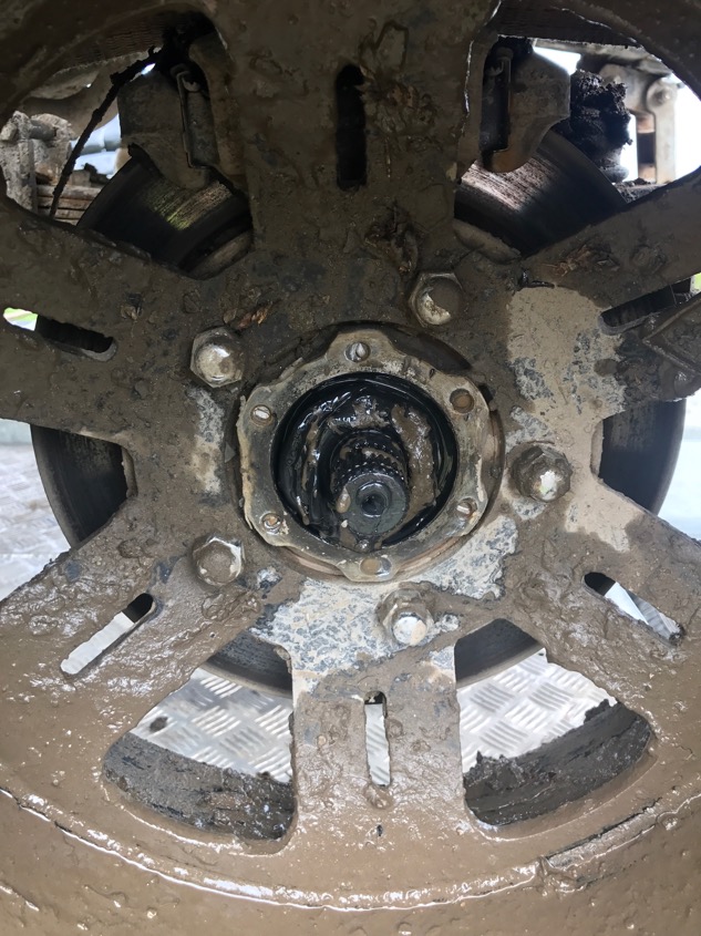

Sheered 6 arp studs lol
And spat the warn hub off
