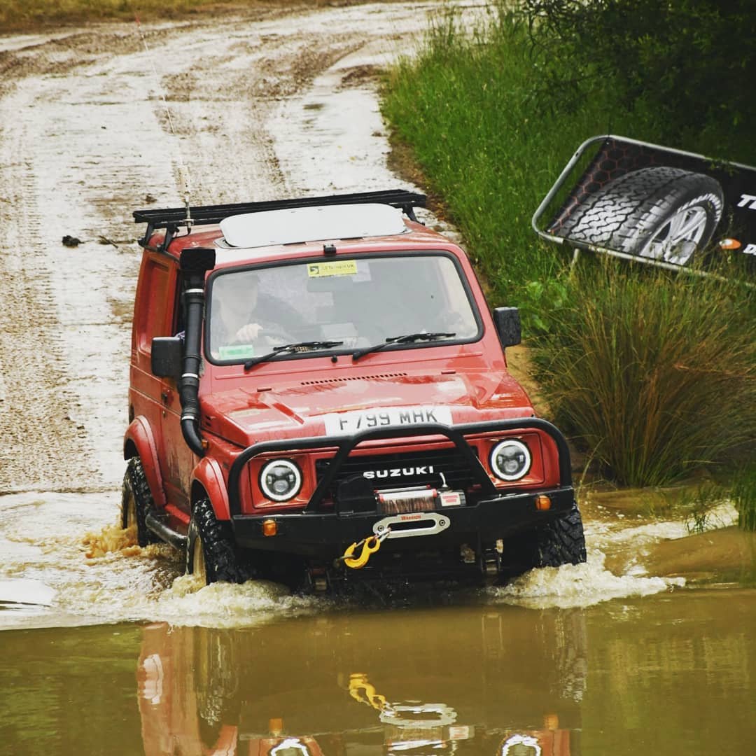

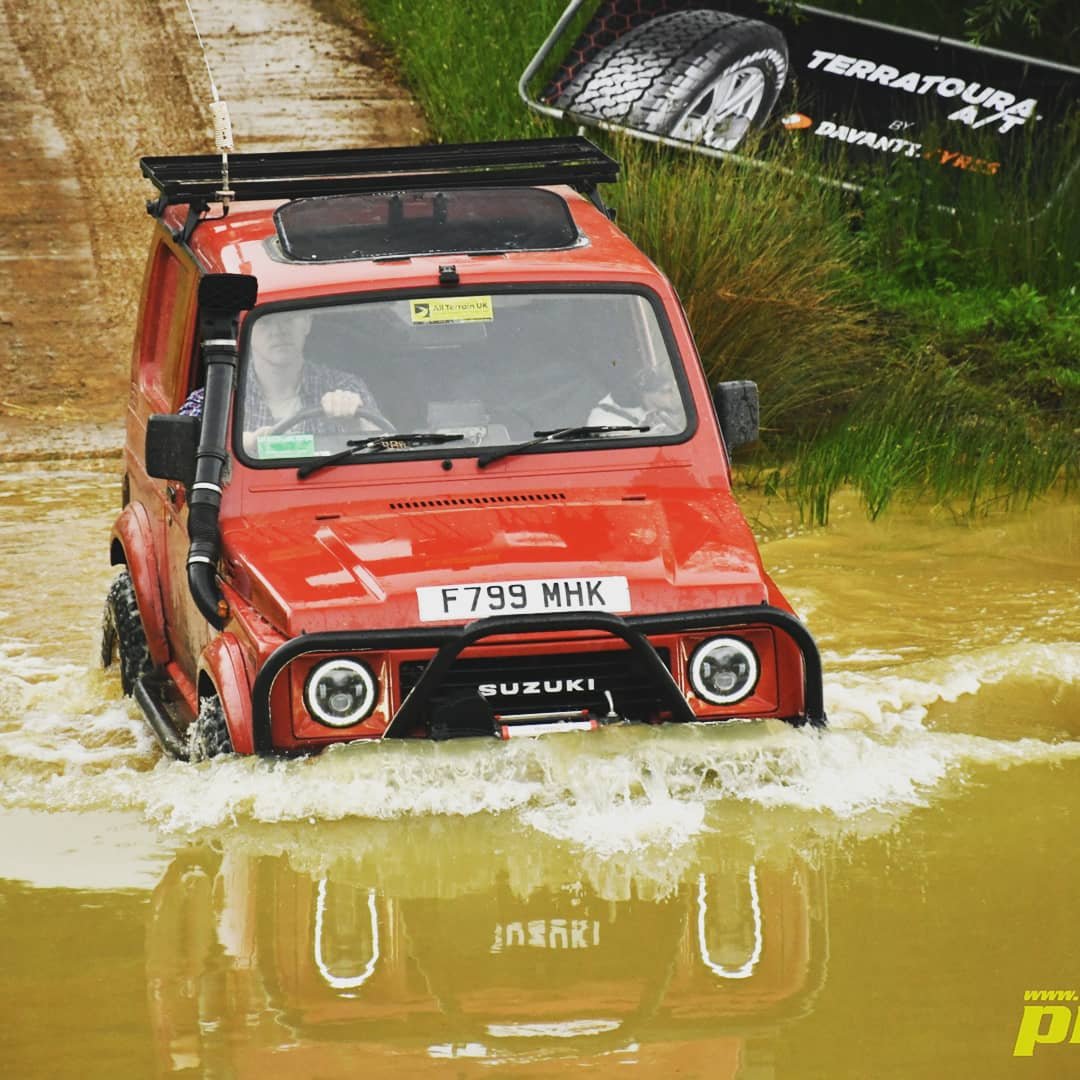

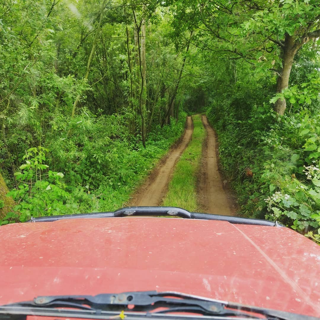

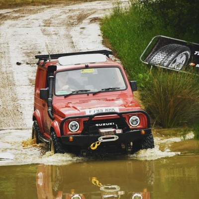

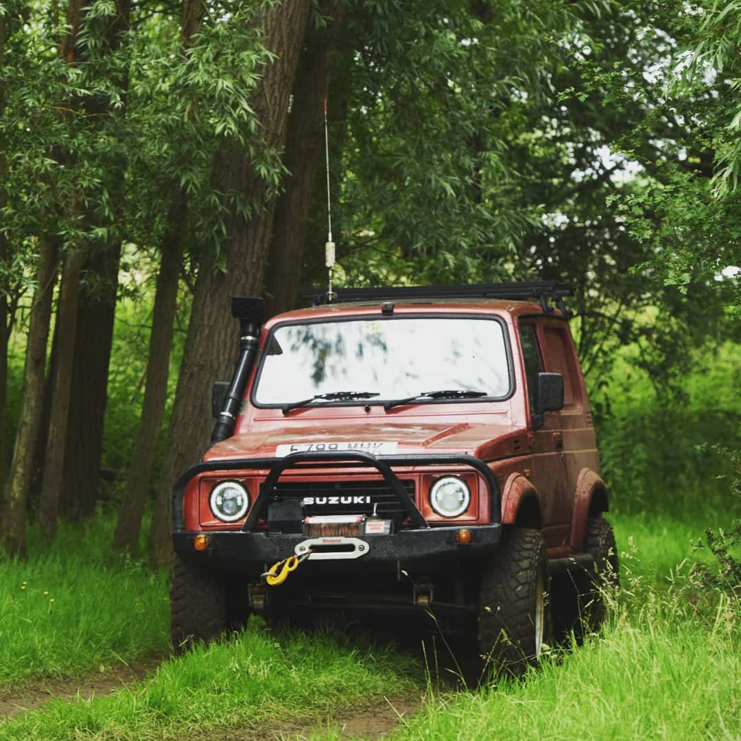

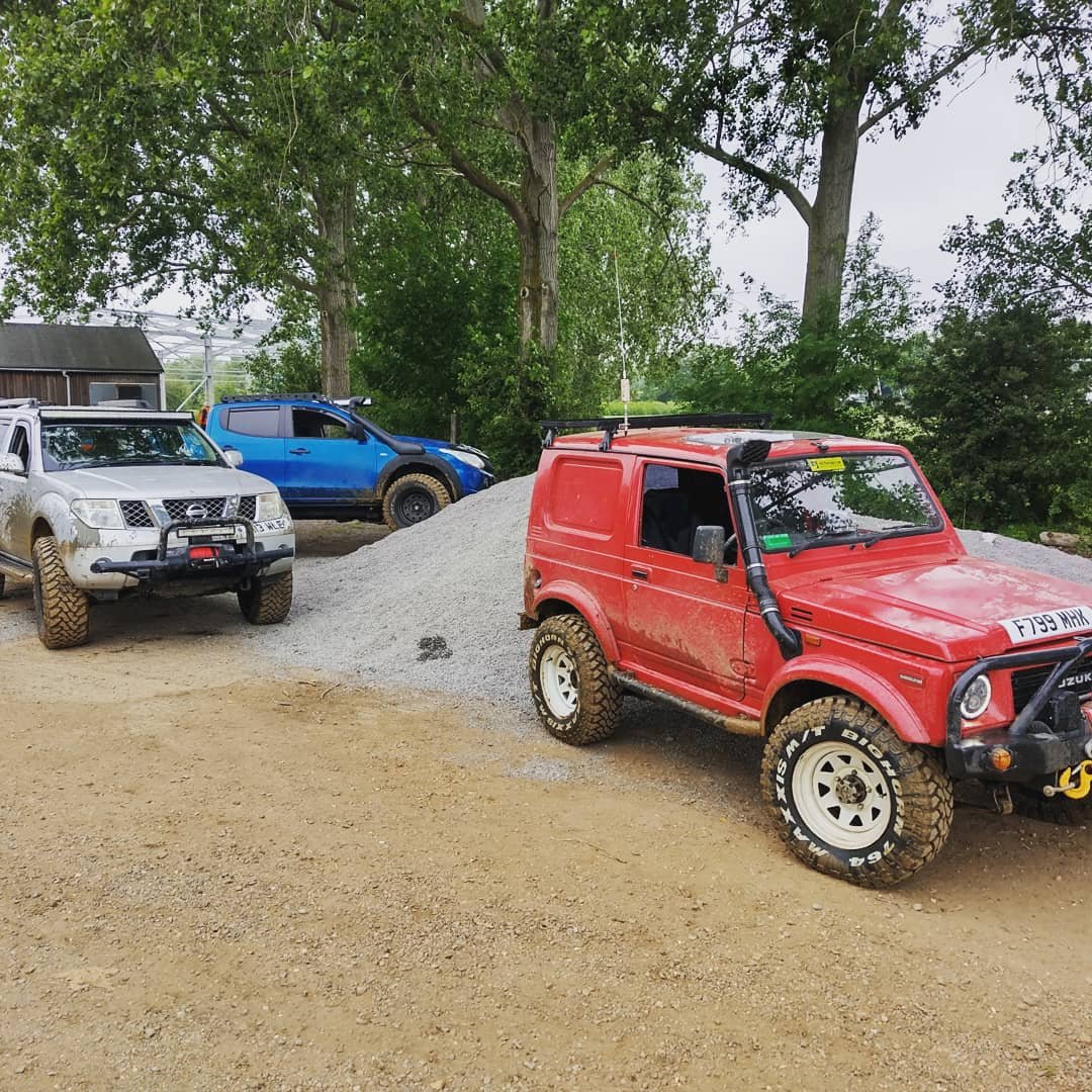

Photos from Billing last week 👍

Some cracking photos looks like a good day

Yeah, it was a good course. Not much to look at in the show itself unless you own a land Rover though!
