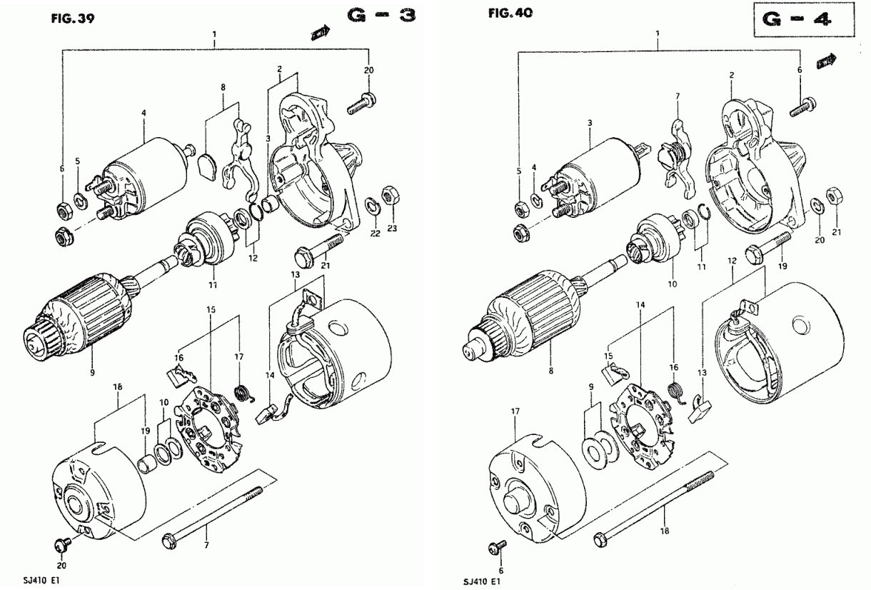

A pic of a couple of 410 starter pics in case you pull it to bits. Not a difficult job, just free everything up, especially the solenoid :thumbup:
Link to "Cranking" section of the workshop manual (413 but near enough)
http://www.4x4.in.th/manual_sj413/chapter9.pdf

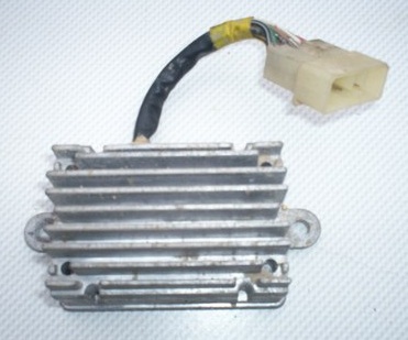

I'm up and early this morning going to a car boot then come back and do some work on the sj so it might be a pick up at the end of the day took a pic last night of the spot lights on and is there a rely for the headlights as the are stuck on

No relay on the headlights. When do they come on and how bright are they. Do you have one of these hiding under the passenger side dash ?? If so unplug it and see what happens :thumbup:

Post by hensey212 » Tue May 07, 2013 9:05 am
Darrell wrote:
hensey212 wrote:I'm up and early this morning going to a car boot then come back and do some work on the sj so it might be a pick up at the end of the day took a pic last night of the spot lights on and is there a rely for the headlights as the are stuck on
when i put the bulb in the holder it did come on like they where on full beam
