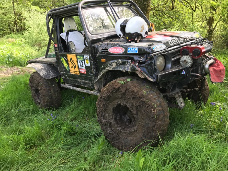

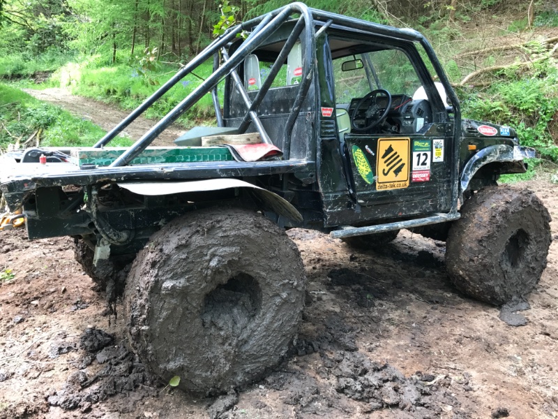

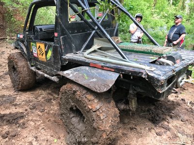

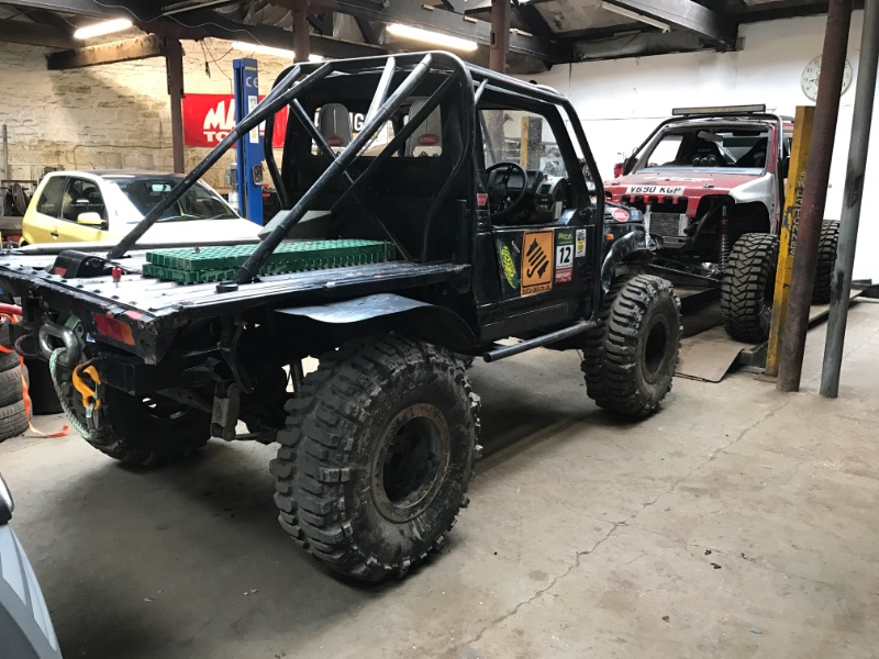

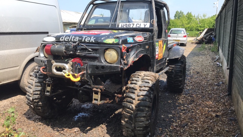

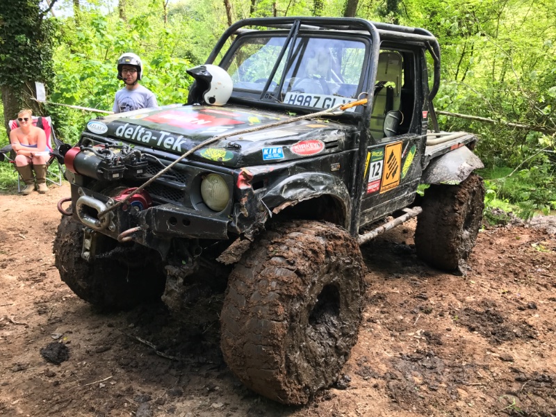

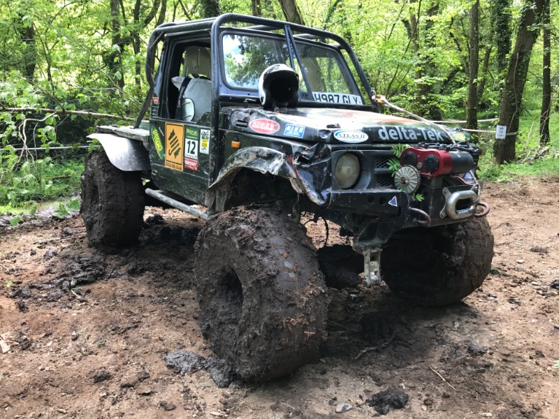

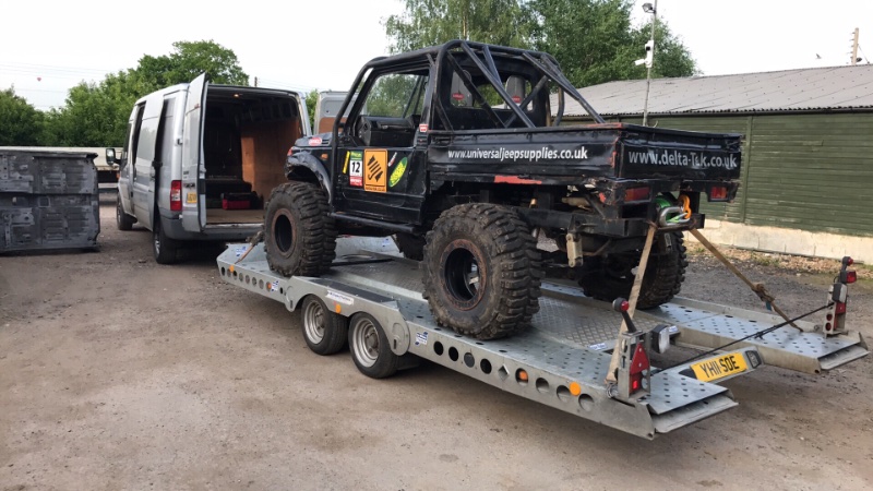

Challenge event in Devon last weekend
Was good fun, boiled up as fan died and ripped two hubs off hahha
But mended all of it and got back out.
Last pics of it on leaf springs, goes off to be coiled next weekend

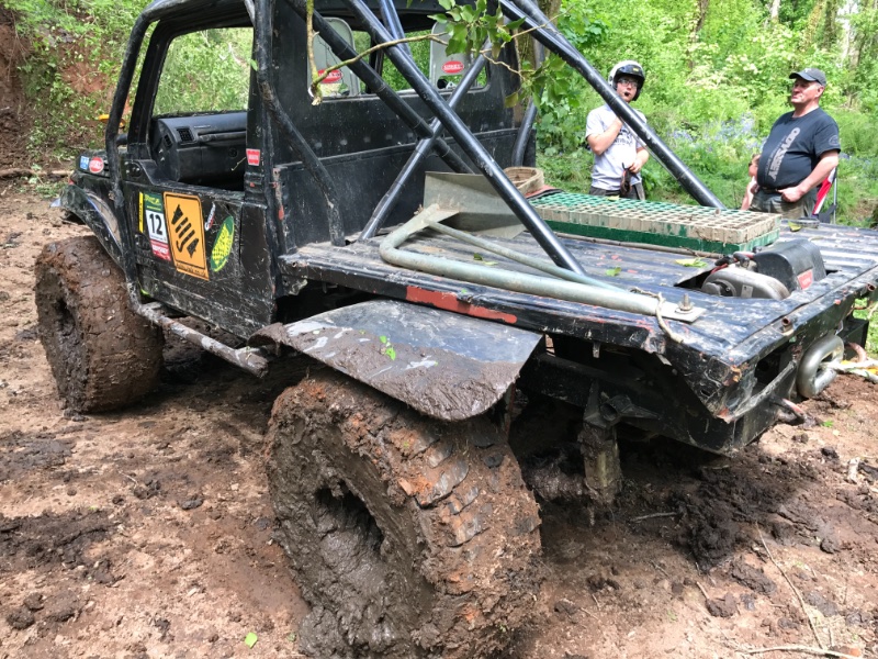

Post by mike harris » Mon May 28, 2018 9:35 am
More pics

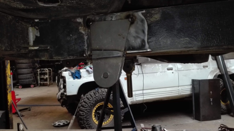

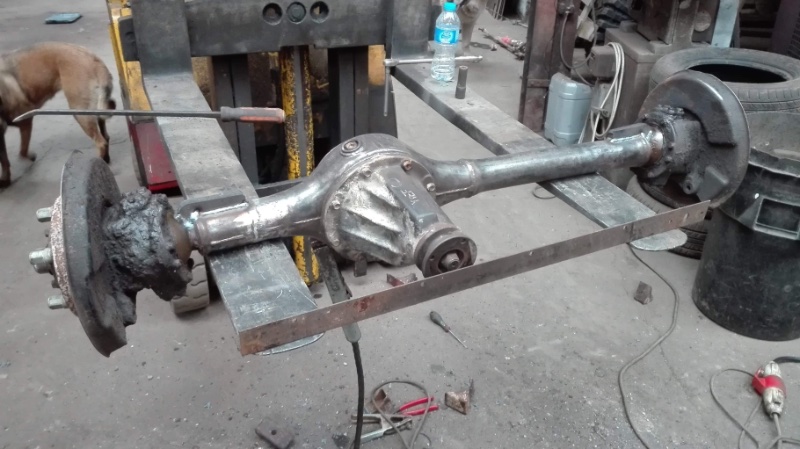

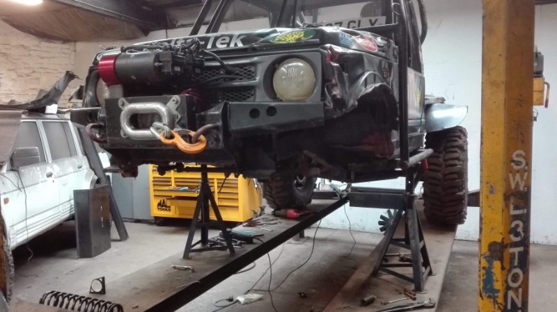

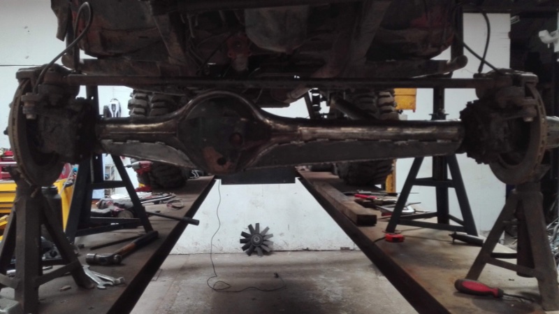

Post by mike harris » Tue Jun 05, 2018 6:10 am
So at the weekend took the suzuki to Halifax to be coil converted by js customs.
Here's what he got done on Monday !
All being well should be around two weeks and it will be done.

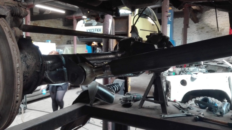

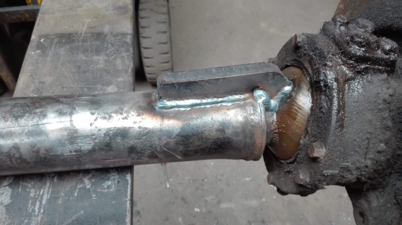

Post by mike harris » Thu Jun 07, 2018 6:58 pm
Couple more
