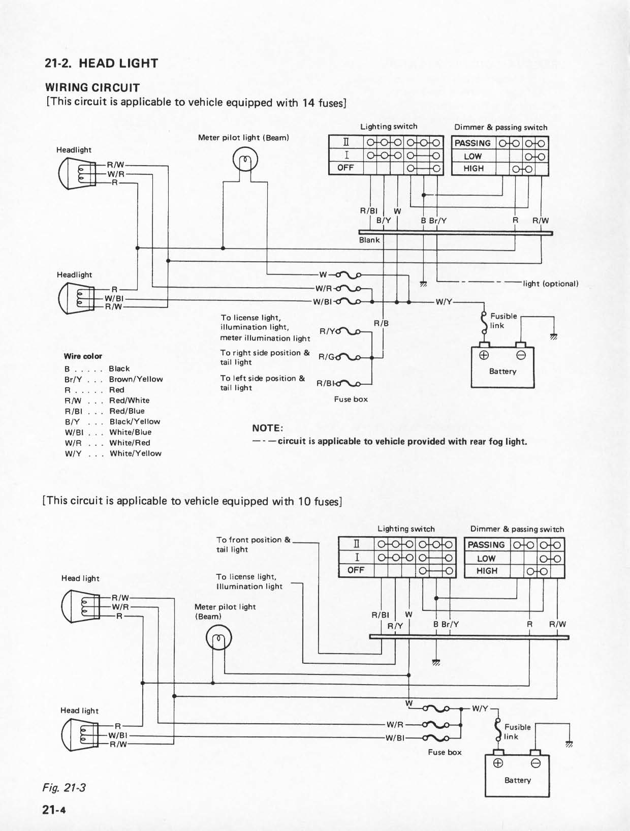

Guess it's time for the multimeter ;)
These are the normal wiring diagrams for the headlights but some Spanish built (Santana) models are switched live instead.
lights circuits.jpg (254.87 KiB) Viewed 6519 times

got the head lights working xD it was the dip dim control unit unplugged that and they don't come on now a battery is connected put some water back in her too and got my roof too its not a suzuki roof its off my dads friends series 2a but as they say "when there's a will there's a way" so ill make it fit.
