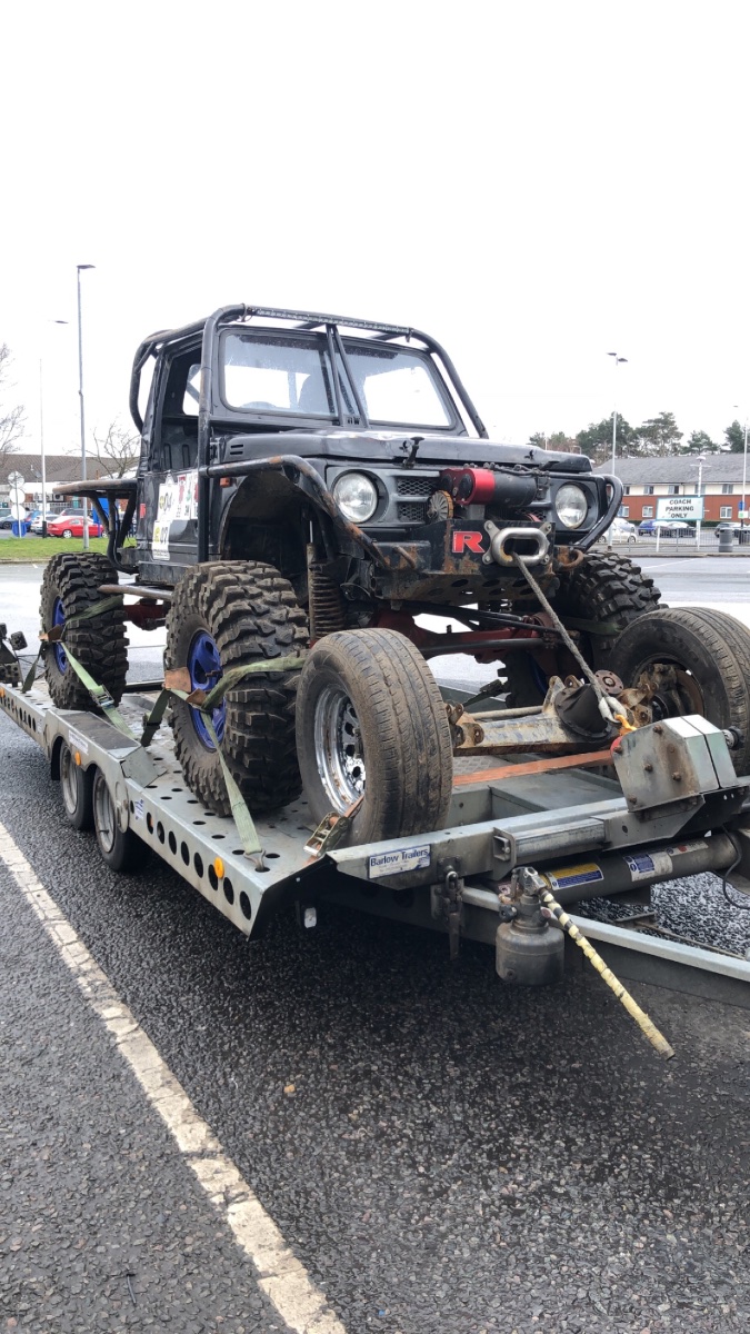

Post by mike harris » Thu Mar 16, 2023 10:13 pm
There on

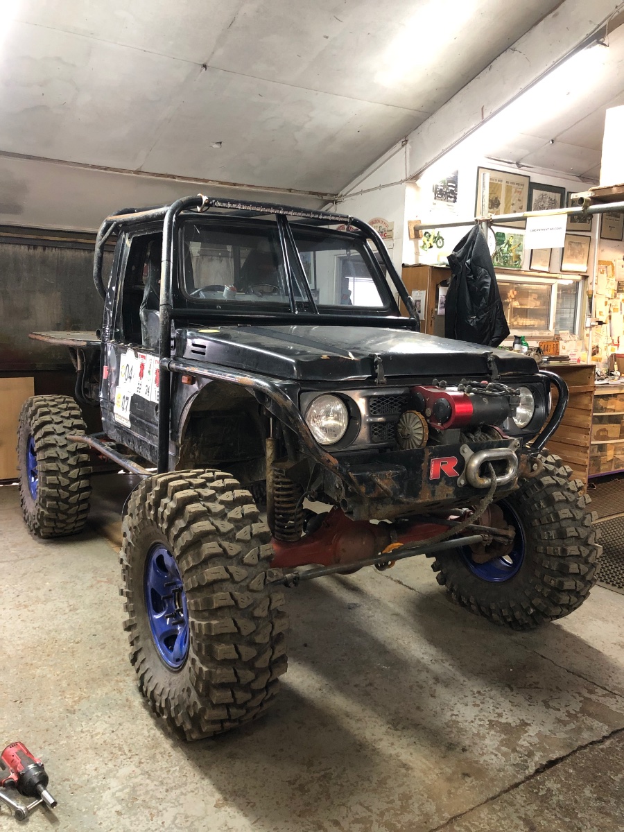

He’s home
d_r_1989
Posts: 574
Post by d_r_1989 » Mon Mar 20, 2023 11:11 pm

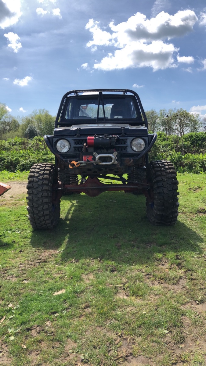

That height difference is mental. Such an awesome motor

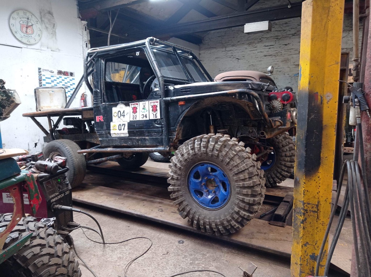

Props now both on, wound the links up in the front axle to make prop angle better, useless landrover props !

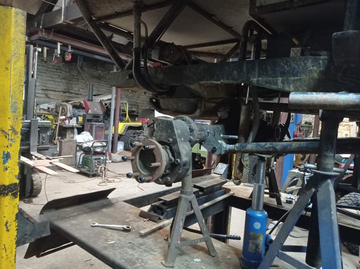

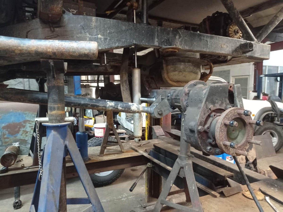

Post by mike harris » Sun Apr 30, 2023 8:19 am

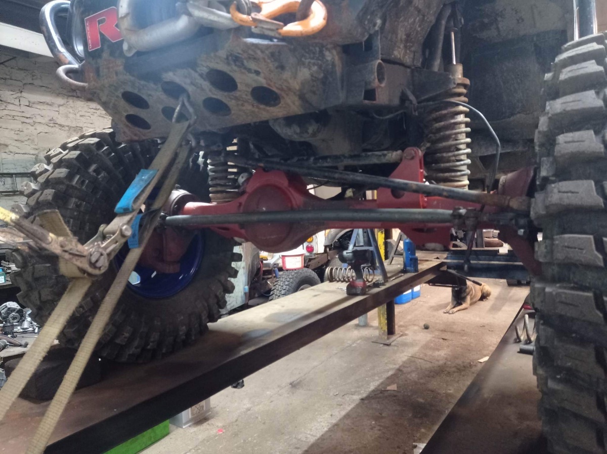

This is front axle re drilled now to sort out the king pin angle.
Got a bit more setup to do but we nearly there
Discs are machines and calliper brackets made test fitted one and they clear.

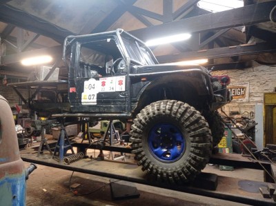

Post by Rankine » Mon May 08, 2023 4:56 pm
Looking good man rims look close to the portals.
Post by mike harris » Mon May 08, 2023 5:26 pm
Very close, il post a video
