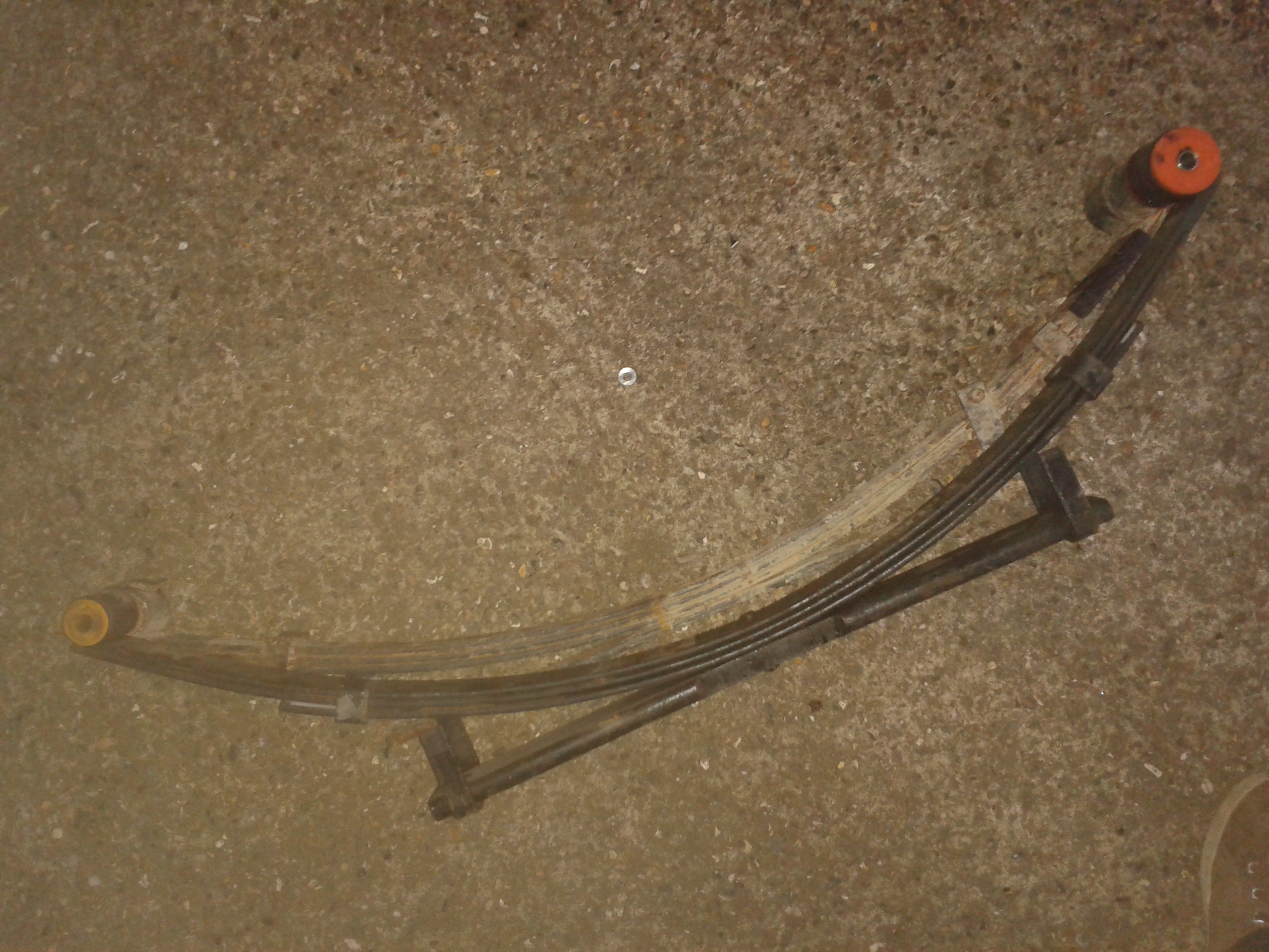

Post by andyrew » Sun Oct 06, 2013 8:32 pm
I have suspension!
I shoved the smj springs I got from rick on and everything seems right. There's quite a
Difference in the two makes
Smj with calmini on top. Both eyes in same place both 3 inch spring.
Post by Jordi » Sun Oct 06, 2013 8:38 pm
Hows it sit now then?
Post by andyrew » Sun Oct 06, 2013 9:00 pm
Same place
Better clearance on the front wings as the wheel sits further back.
Seems brick hard tho!
