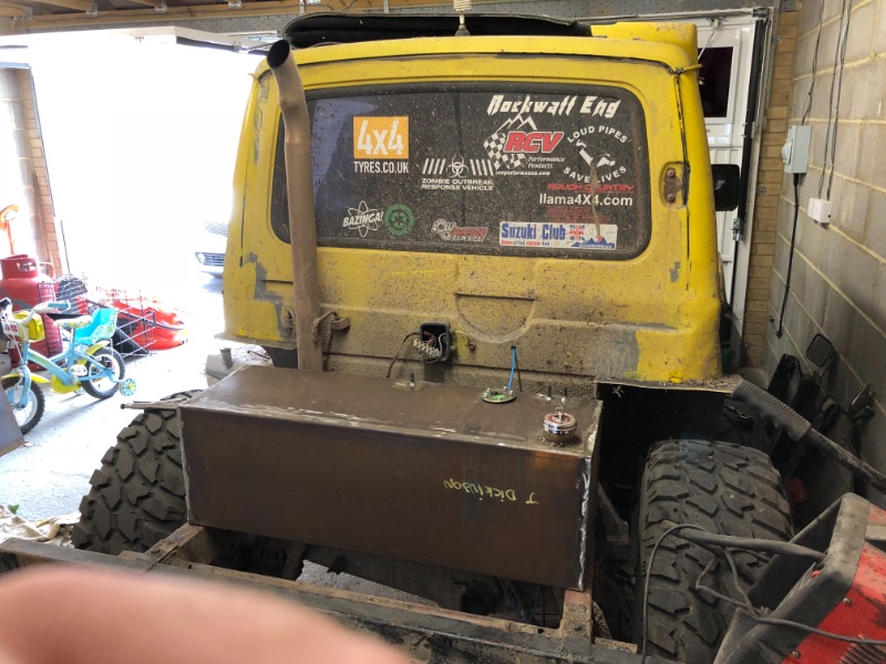

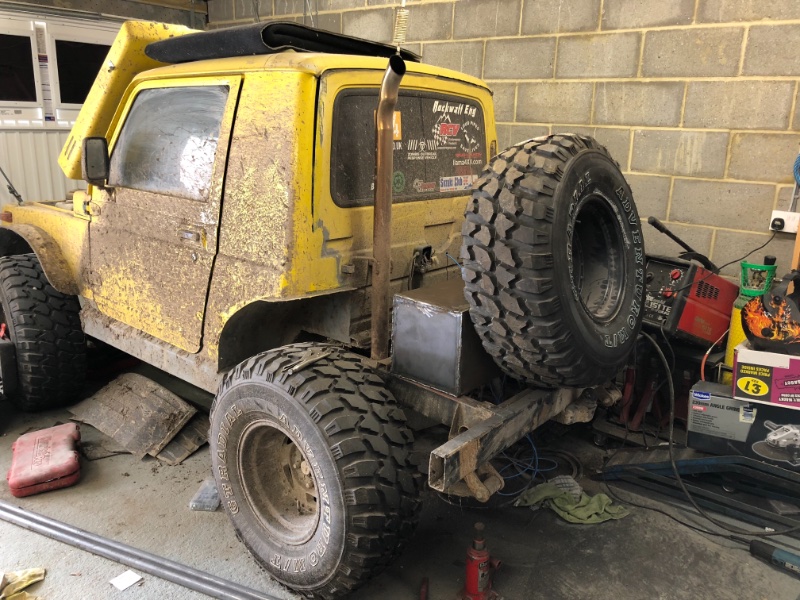

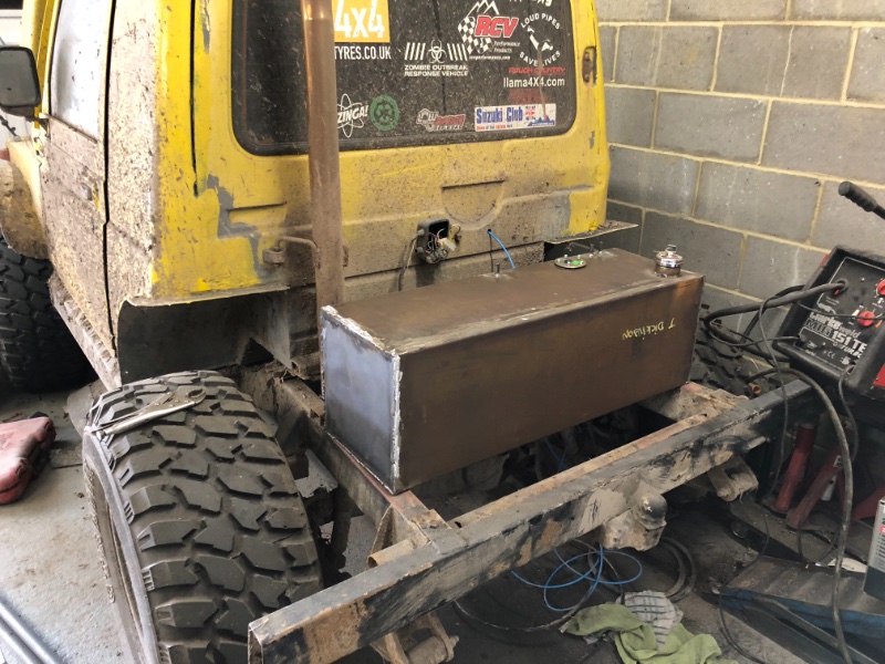

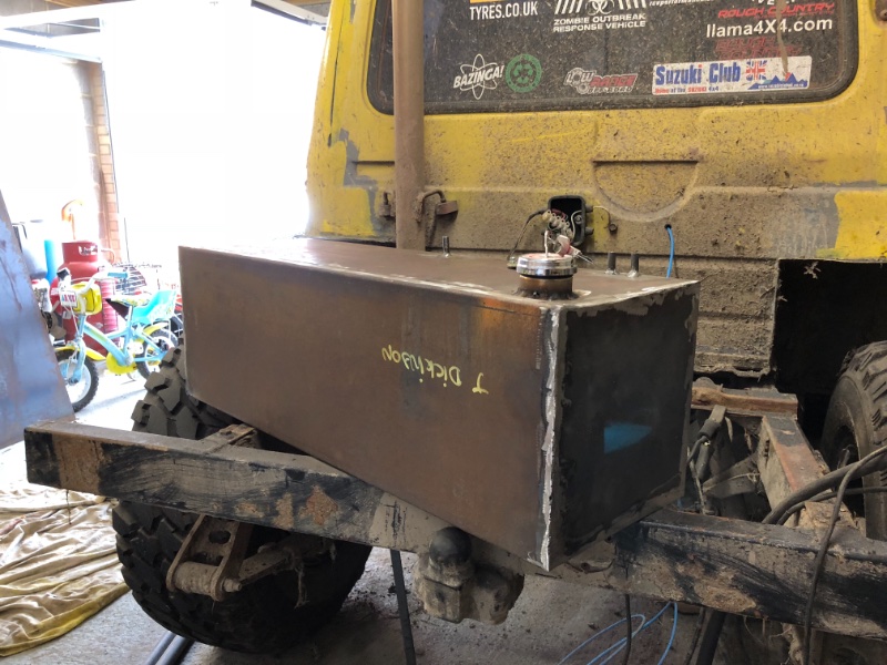

Fuel filler cap welded on.
Sender unit bolted in. I used self drilling hex head screws from screwfix and was well impressed with them given i was screwing into 2mm steel.

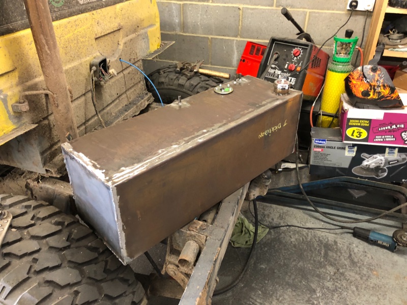

Welded on the other end cap and made a start on tidying up the welding. Some parts welded beautifully, others not so great.
I am going with the presumption it will not be fuel tight but based on recommendation from a few mates i’m gonna definitely line it with liquid tank.
It’s slow progress due to work and family commitments but it is progress.

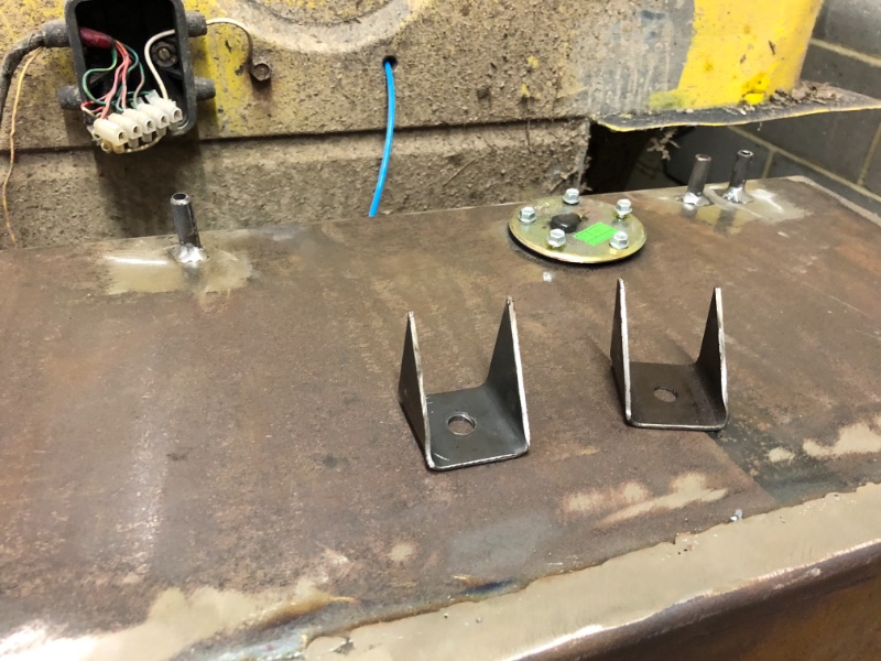

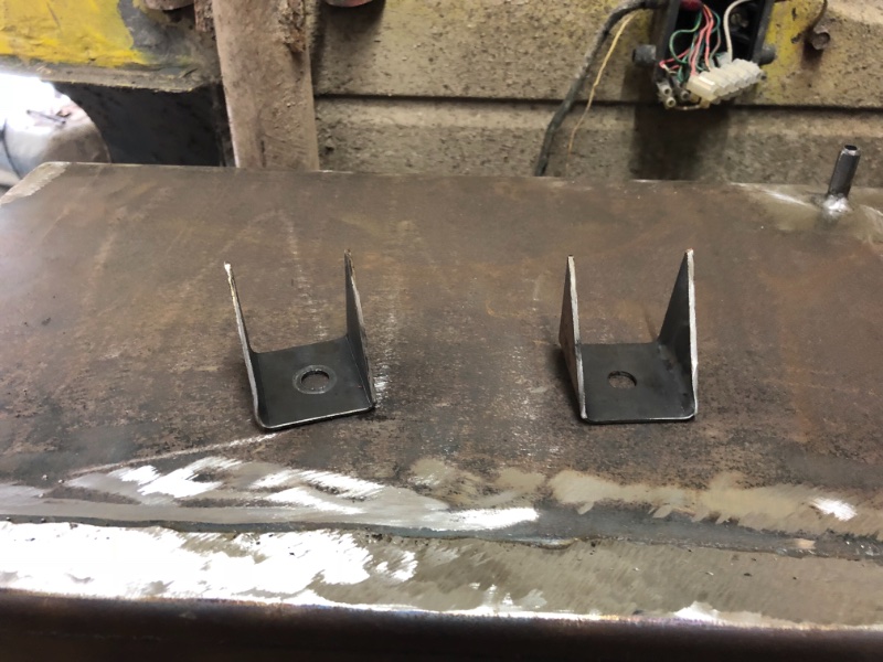

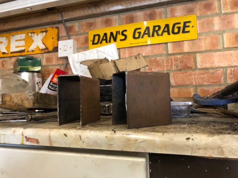

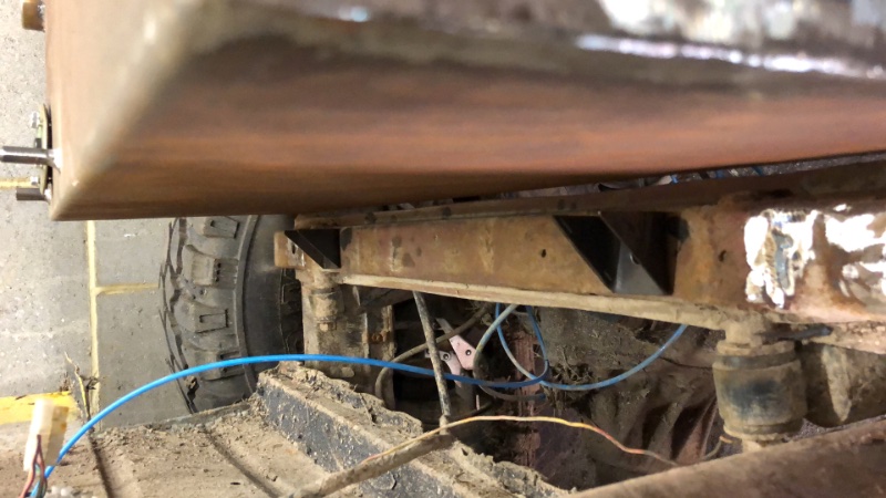

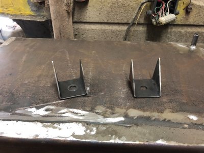

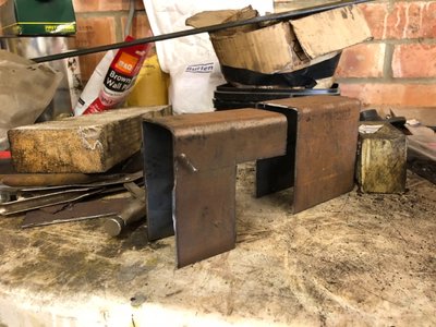

Post by Jordi » Sat Jun 23, 2018 4:14 pm

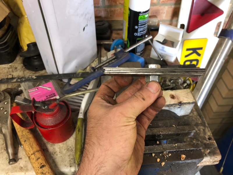

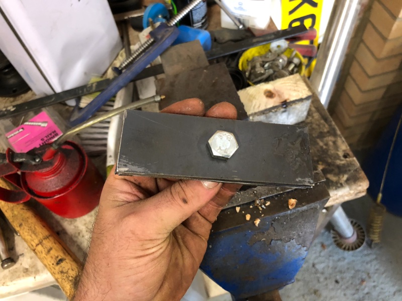

4 120mm x 40mm steel plates. Clamped together, drilled and bolted together.

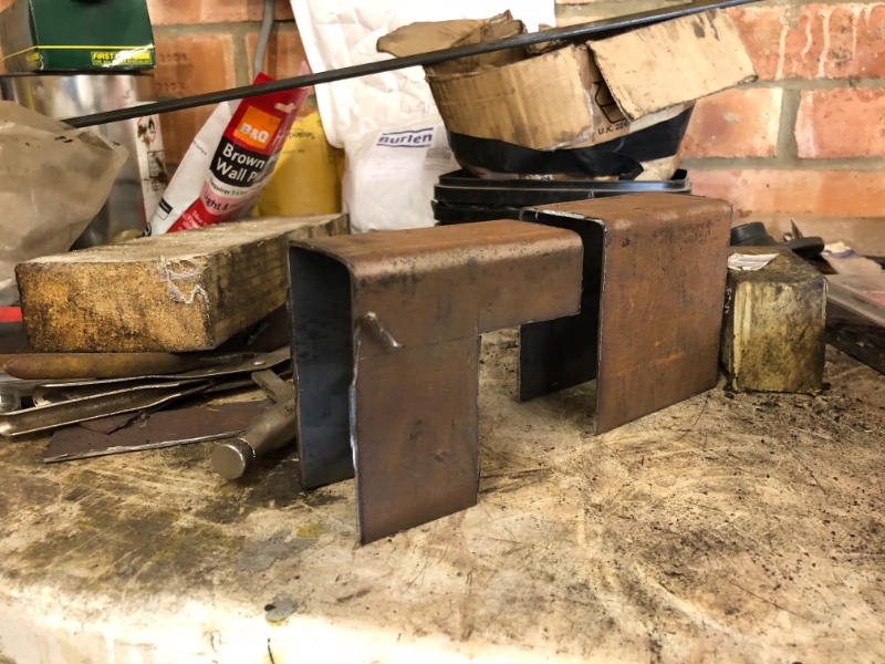

Some metal folding later.

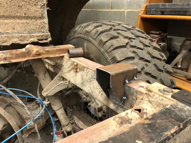

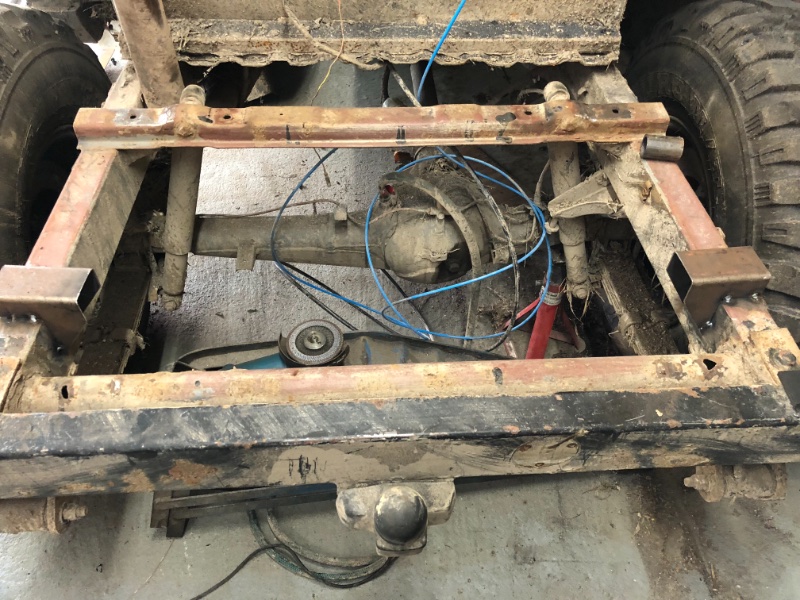

Where the rears will bolts to the existing cross member.
Next step is to make two brackets to weld onto the chassis to support the rear of the tank.

Post by ROBBIE » Sat Jun 23, 2018 9:12 pm
Looking sweet :thumbup:
Post by donkeychomp » Sun Jun 24, 2018 11:47 pm
Looking great Jordi. Is the tank kinda the same size as an SJ one? If not your fuel gauge might be wrong...if it ever worked to begin with lol
Posts: 4567
Post by ROBBIE » Mon Jun 25, 2018 10:58 am
Looks the same shape size as that came with my LJ
Post by Jordi » Mon Jun 25, 2018 11:00 pm
Only ever worked between half and empty 😂😂😂
It is a bigger tank but is pretty much the same depth so the standard sender unit will work fine it.
I honestly can’t remember its capactity. I sat for ages working it out too.
Bought a new sender from one of those indian ebay sellers too, hoping that work properly.
Just on researching the tank sealers now. So far the POR 15 seems most commonly used with generally good reviews.

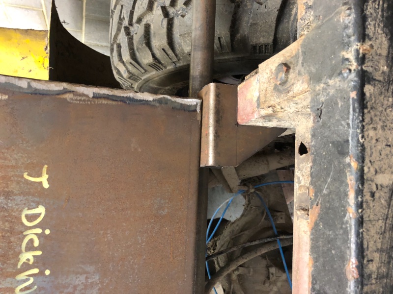

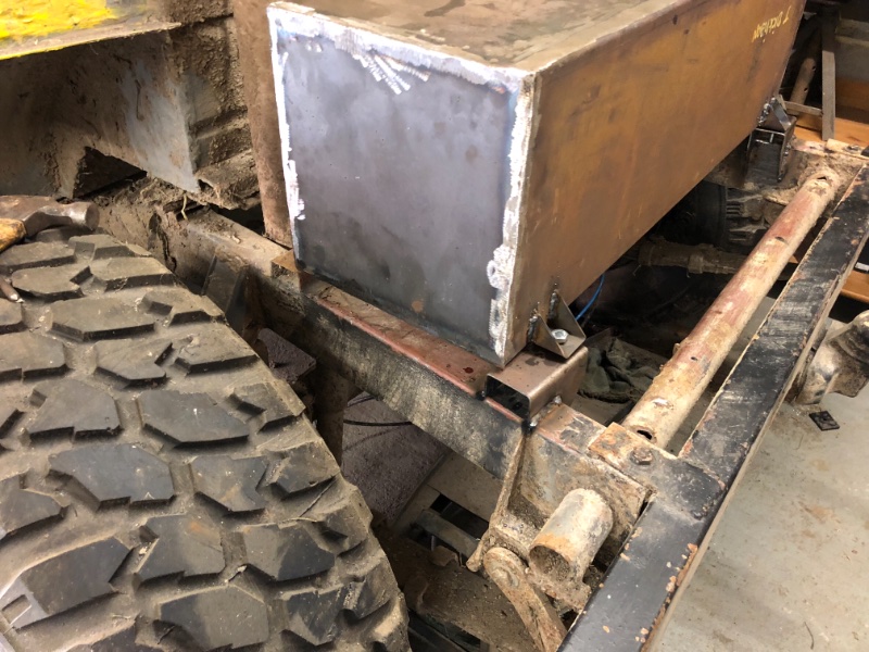

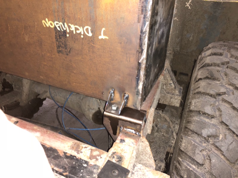

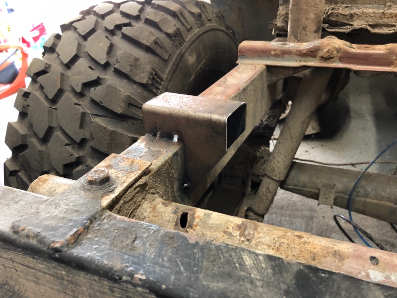

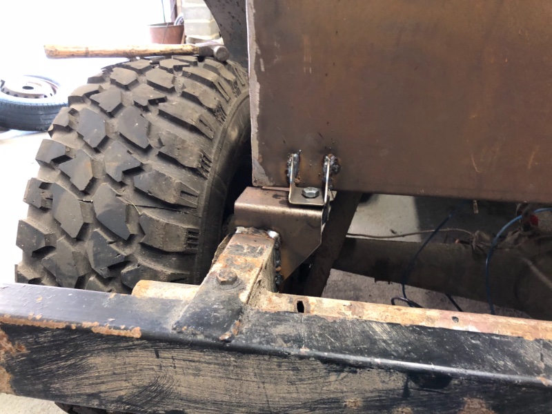

Post by Jordi » Mon Jul 30, 2018 5:49 pm
More progress.
Brackets welded onto the tank and chassis brackets made and welded on.
