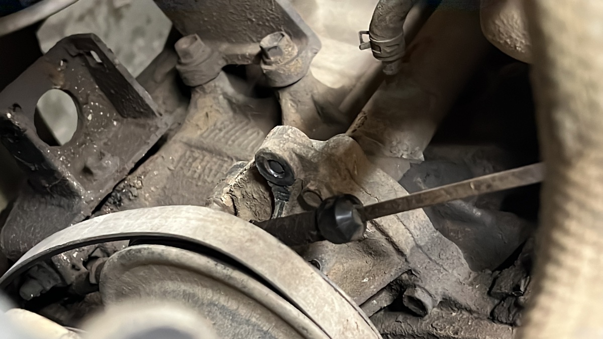

Fan belt was squeaking. Wasn’t quite as simple a fix as anticipated. The top bolt had sheared. Rad and fan out, drilled out the bolt, which luckily wasn’t seized and just screwed through as i drilled. Which was a bonus.
All back together again.
