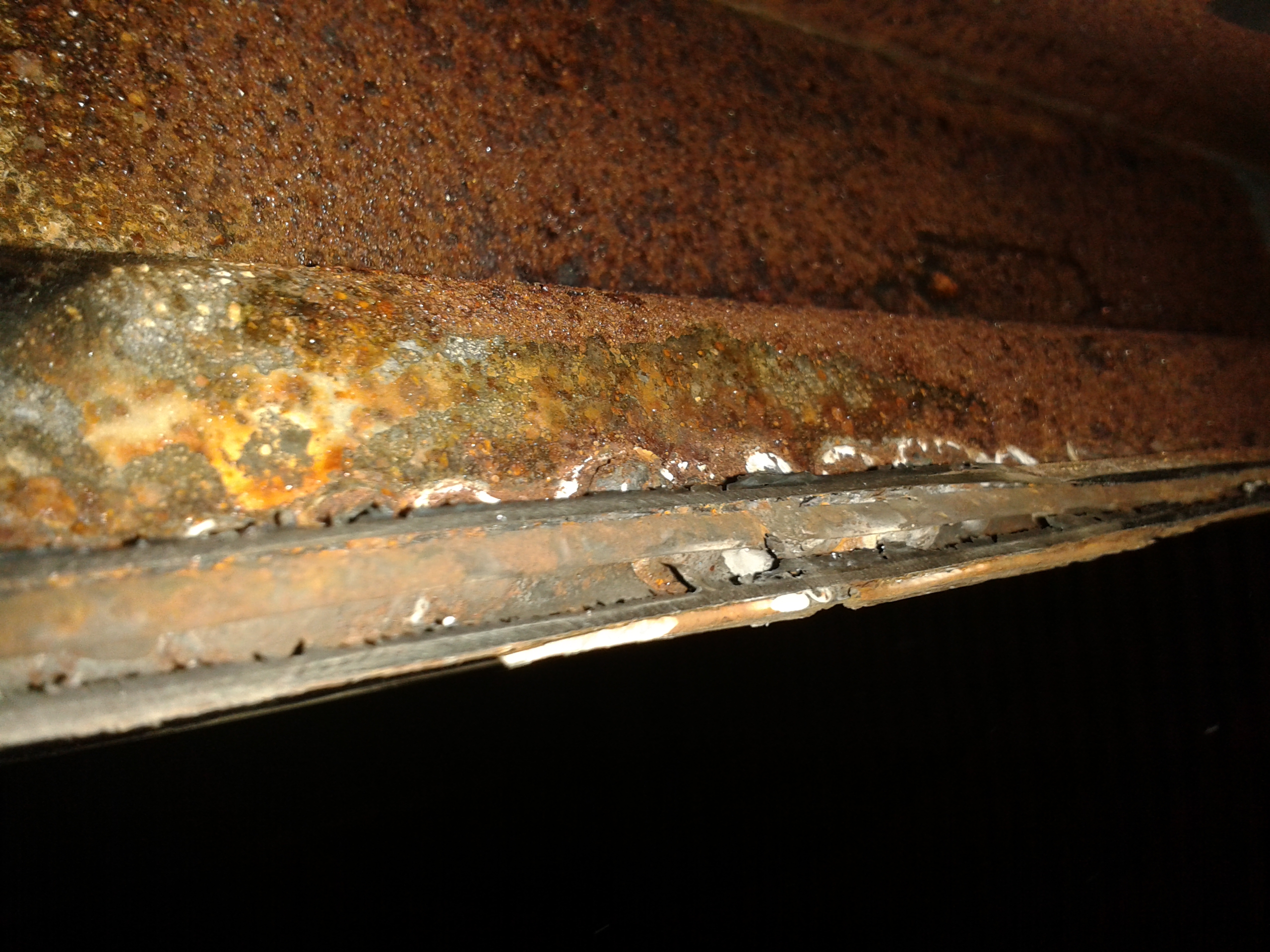

Having seen this beastie close up I love it. Small surface rust on the sills... :brows:

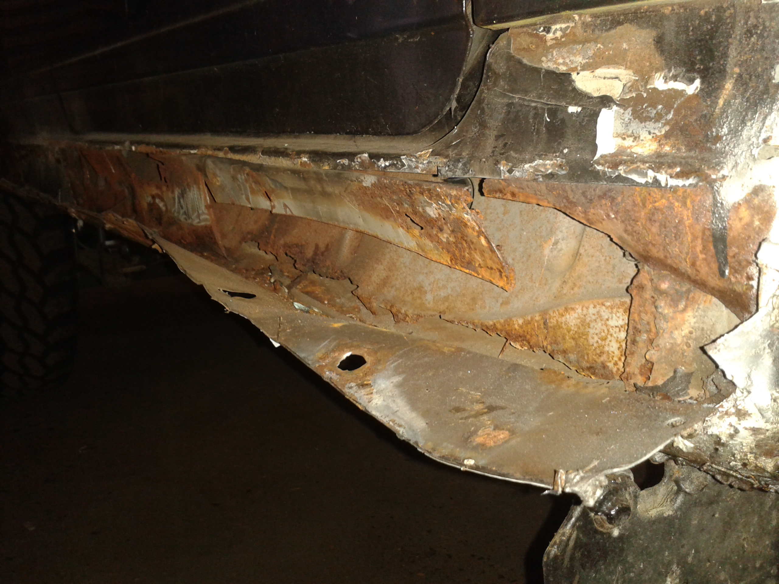

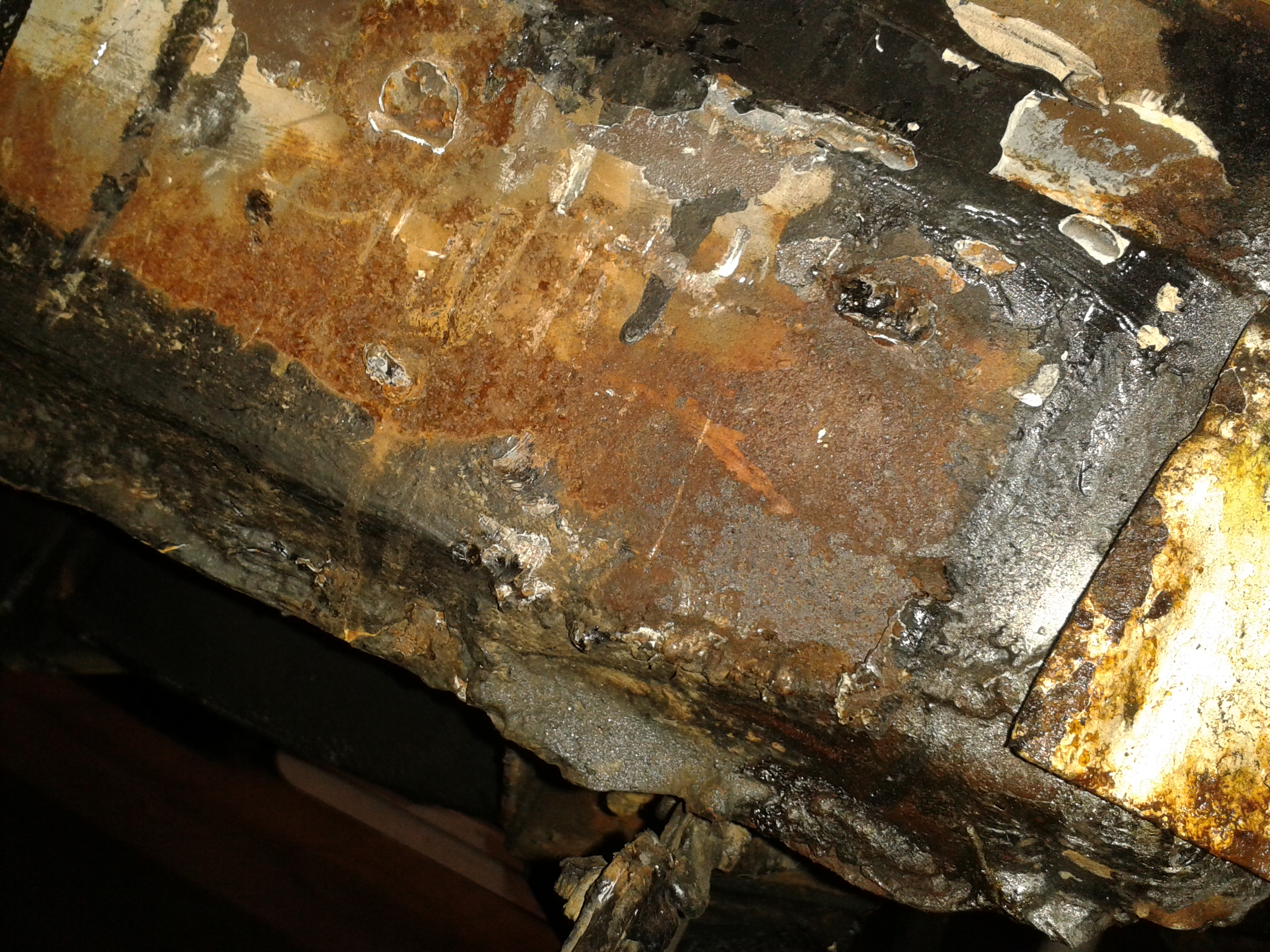

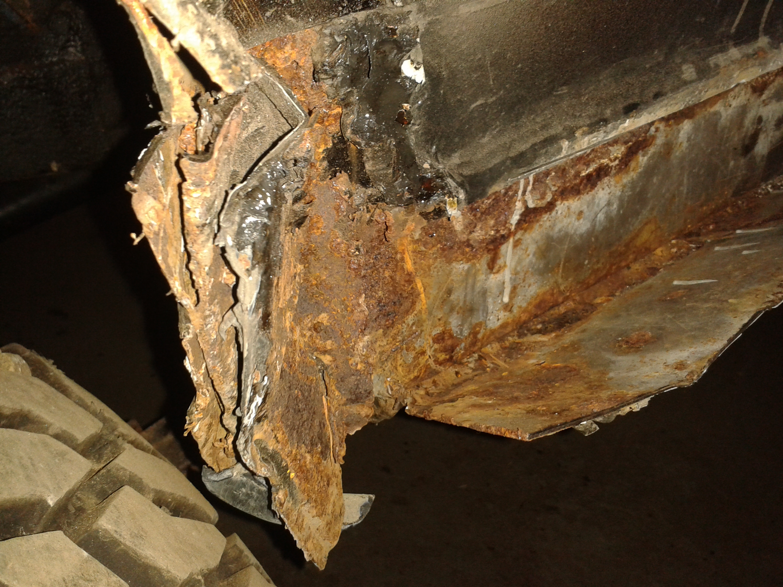

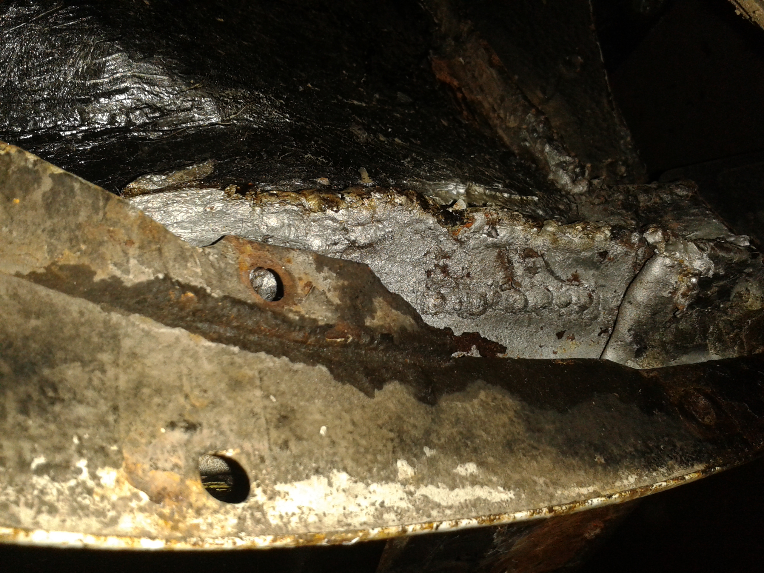

Started to look at doing the sills.
What a mess. Everything is just hacked and fucked.
Id got some 80 x 80 box but it seems I should have gotten
100 x 100. Im going to fabricate my own tucked sills
Then eventually make some tube sliders/ step for the misses.
I knew they was patchwork but this is just ridiculous. What a bell end

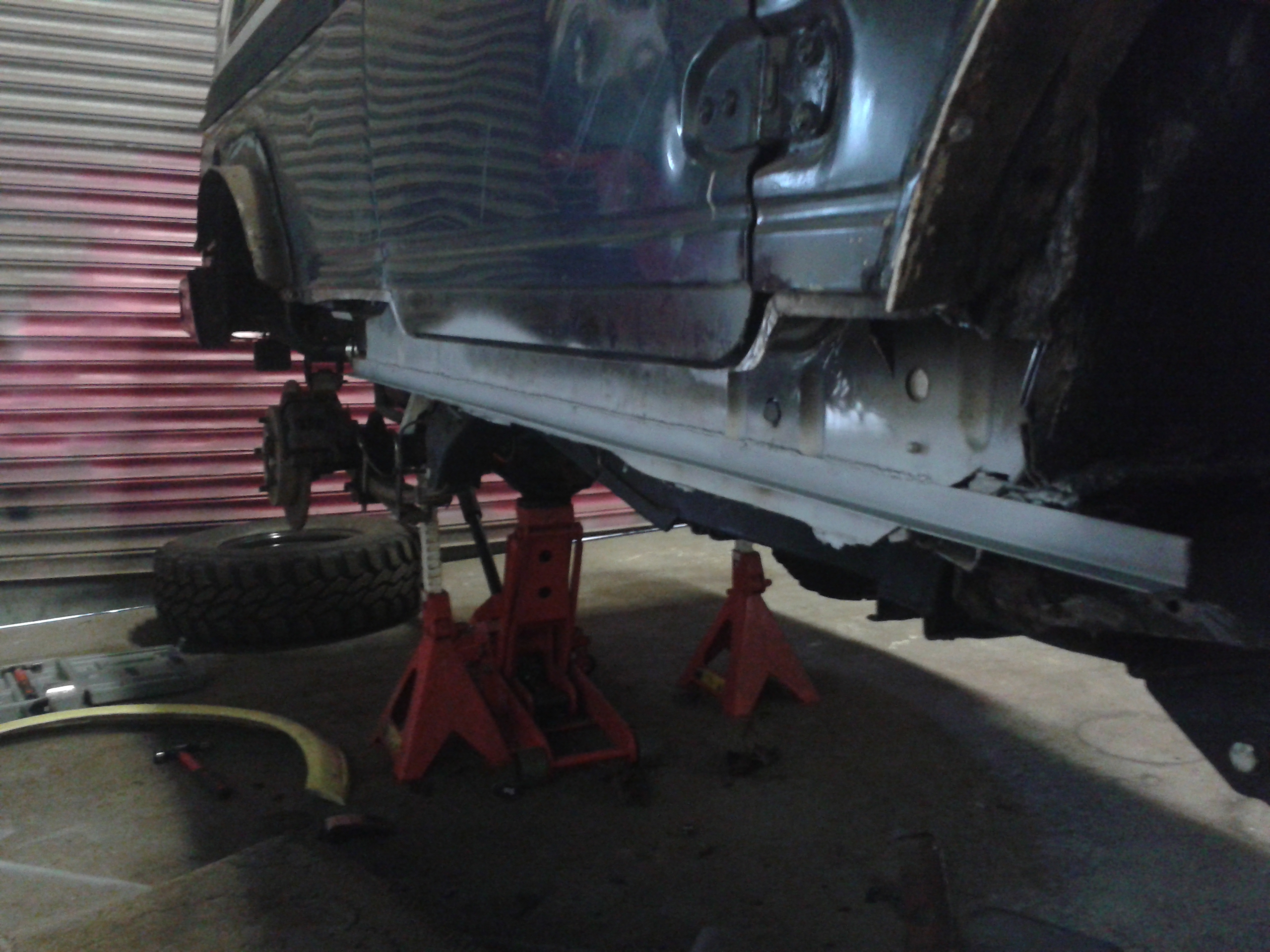

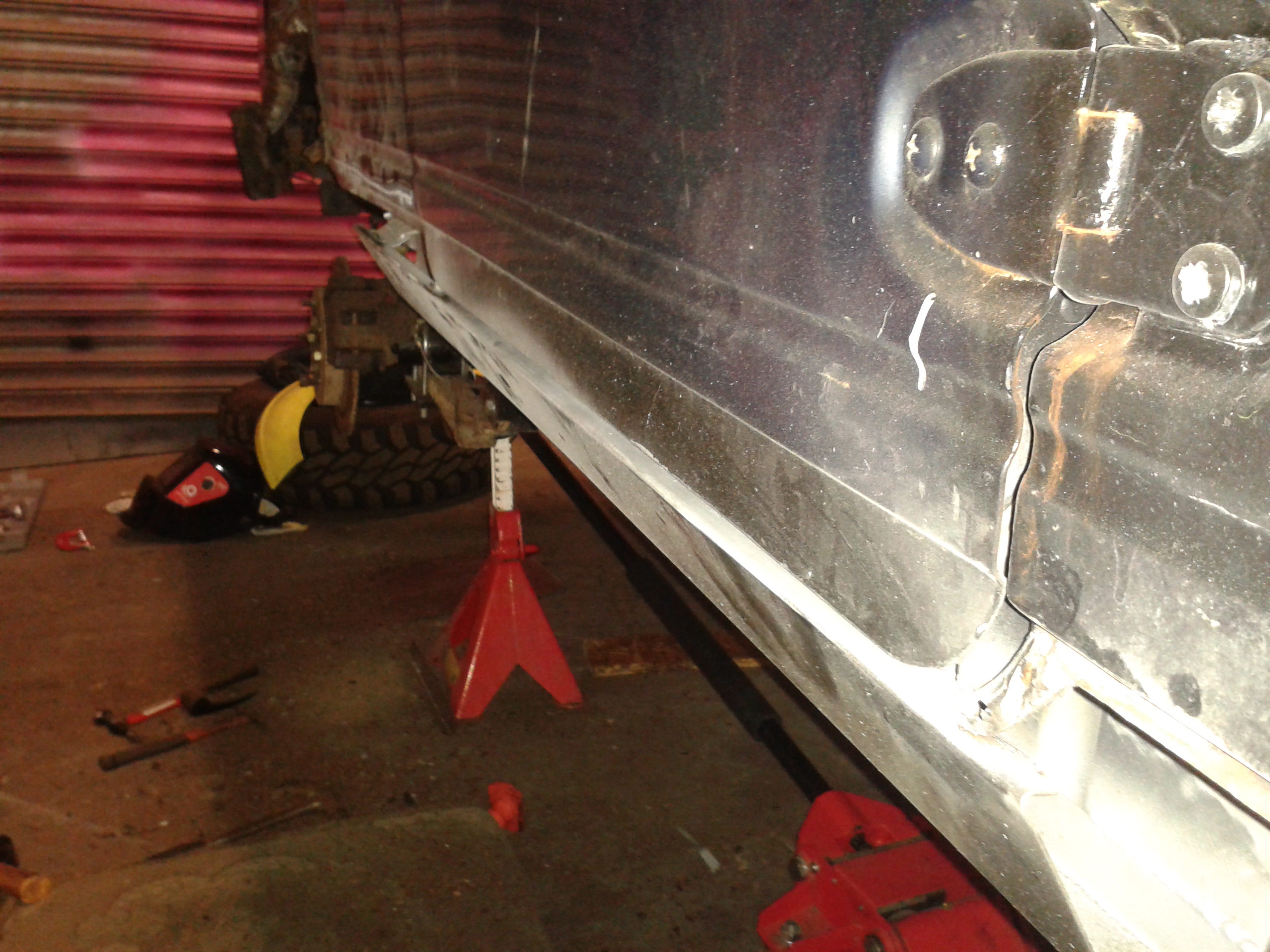

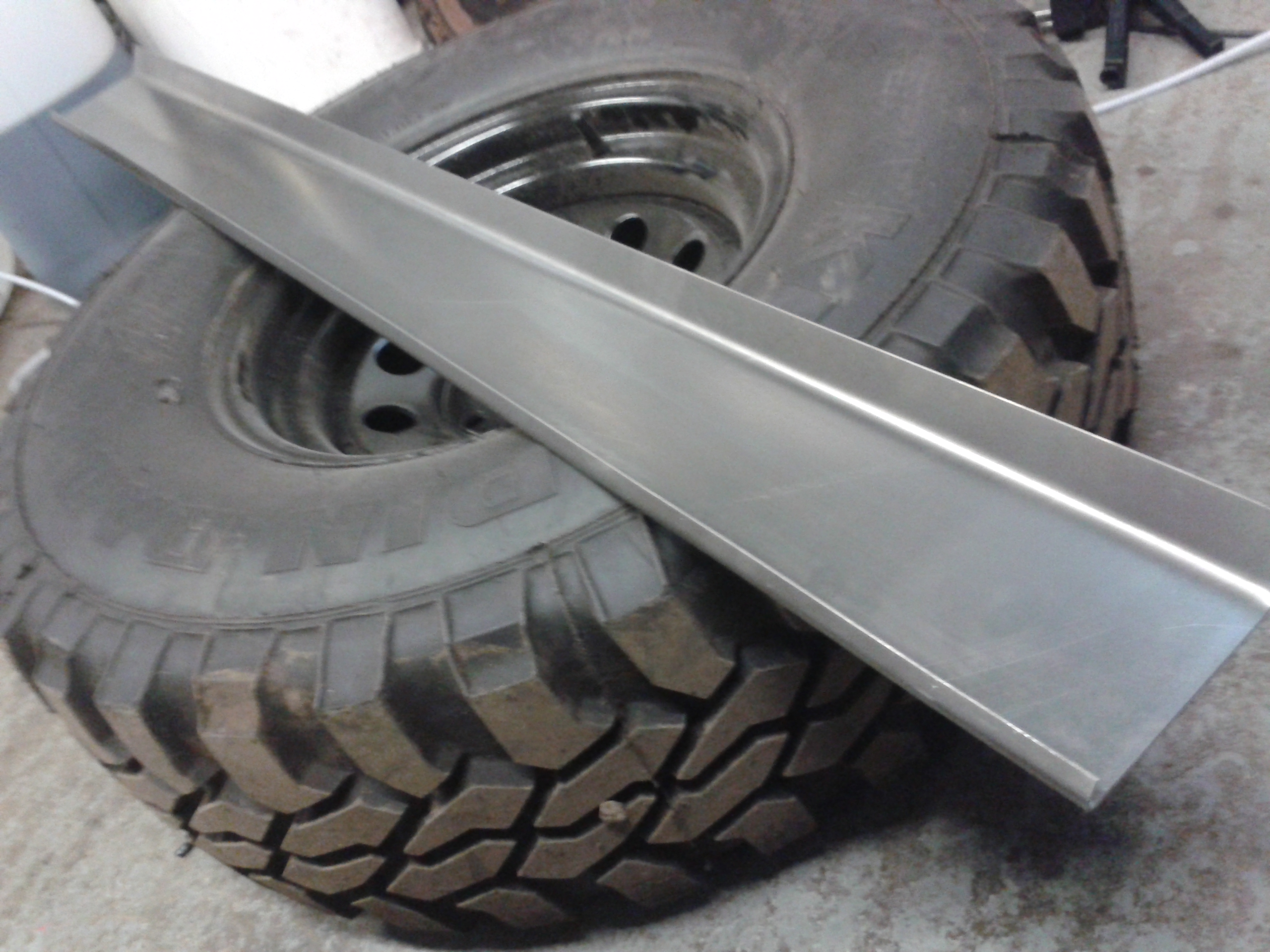

Tonights progress.
Folded up some sill panels. Had to do three as the folder is
Only 4ft wide at work :lol: . I used some inch x inch angle
Along the bottom.

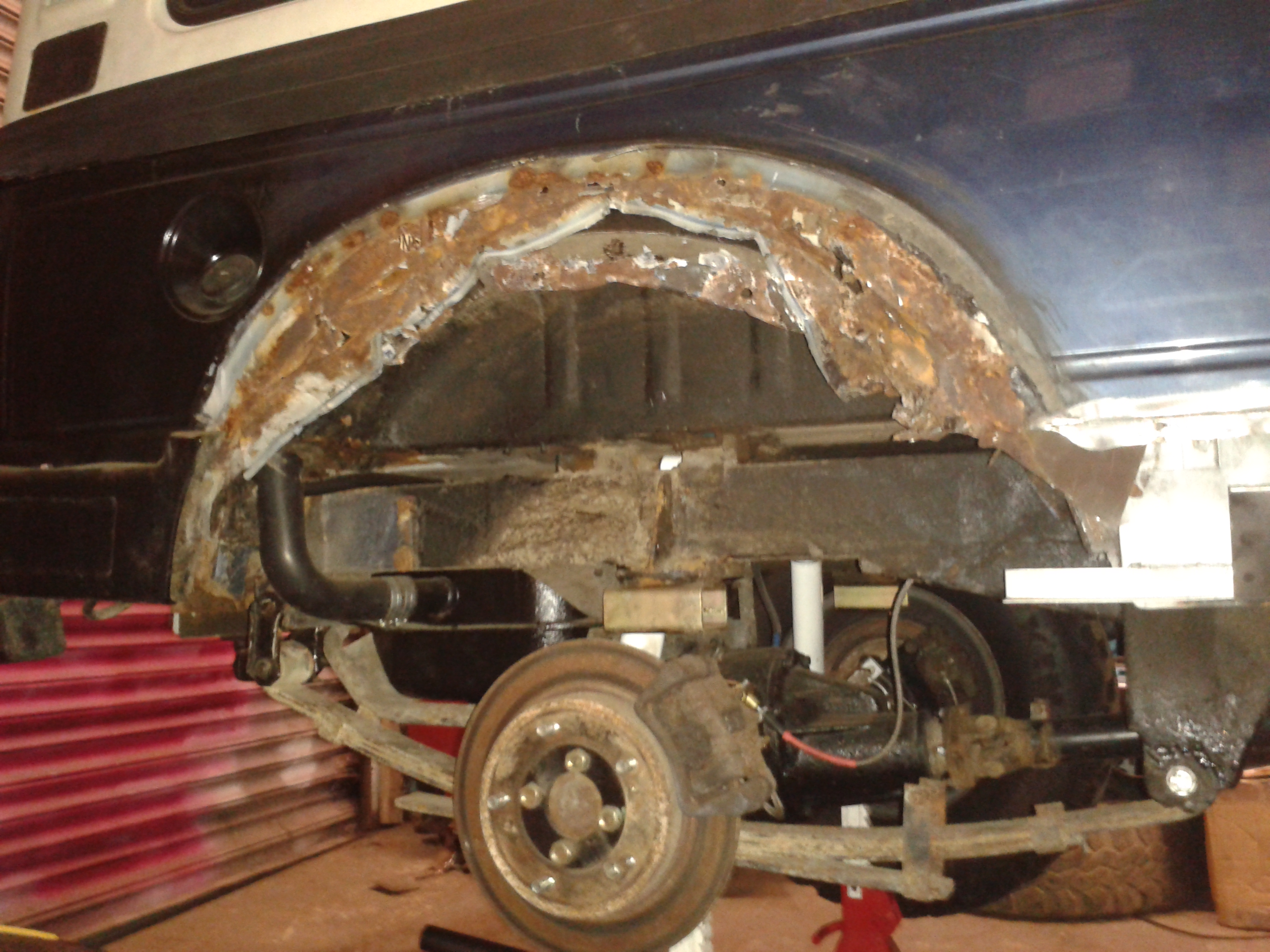

The arch is another story. :roll:
Post by dan_2k_uk » Thu Apr 24, 2014 8:49 am
Ha ha ha. That arch!
Post by twiss » Thu Apr 24, 2014 11:55 am
mmmm andy thats a mint condition arch right there
Posts: 11724
Post by ScottieJ » Thu Apr 24, 2014 11:59 am
Tidy work on the sills! That arch isn't too bad :thumbup:

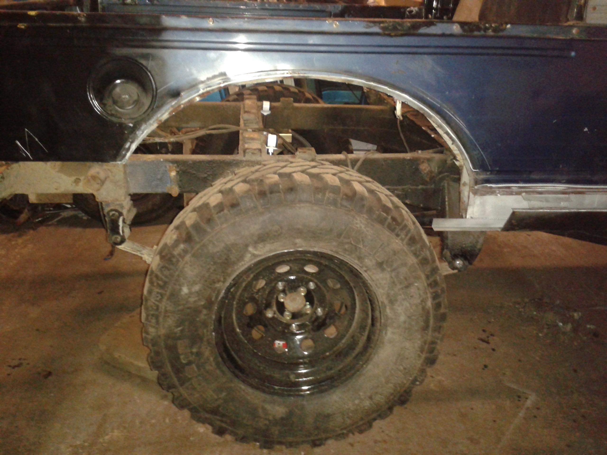

Post by andyrew » Sun May 11, 2014 11:51 pm
Well I've got the rot cut out at least :doublethumbs:
Bit too much arch gap now tho. Ill sort that ;)
Post by Jordi » Sun May 11, 2014 11:54 pm
Looking good Andy, just needs that hole patching and it'll be grand.
