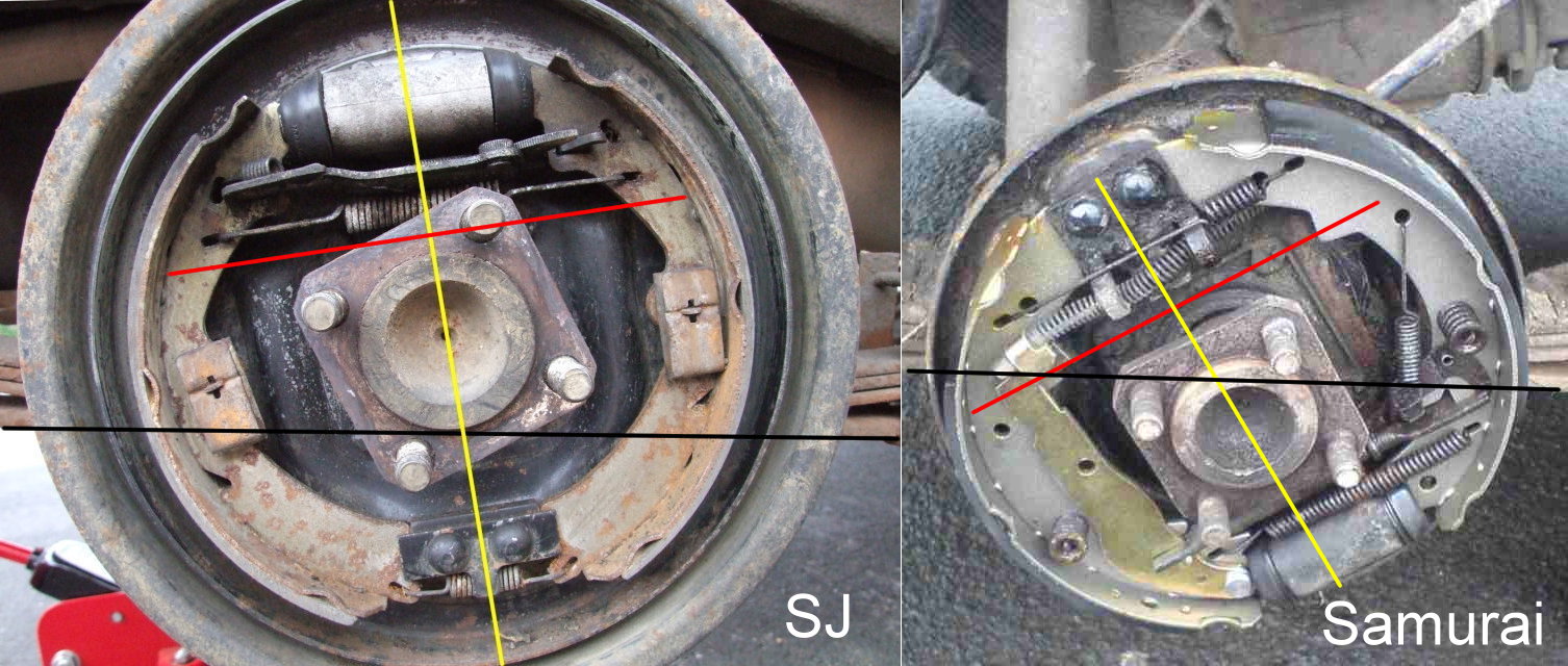

But as I looked closer, it looks like it's been modified.
The spring seats have been welded on (Possibly just repairs, not sure).
They sit 3ft apart, same as my 410 spring seats.
I noticed that the square flange that the drum backplate bolts to, is rotated around by about 45 degrees, compared to my 410 ones.
And then I also noticed, that the total length of the axle is about 6 inches longer (Wider) than my 410 rear axle too.
Diff ratio is different, it's higher on the newer axle, not a lot, but defo higher.

Sounds like its a samurai axle that has had the perches moved in and welded to fit an SJ.
I have a feeling the square ends/flanges are welded on a about 40degree angle on the samurai :er: :er: .
More investigating now required :oops:
I need some pics, so I can do a diagram :P

This do .............
Untitled - 2.jpg (244.17 KiB) Viewed 6746 times

Id say thats a jap samurai rear axle. The spring perches have just been moved to fit to a 410 or 413
