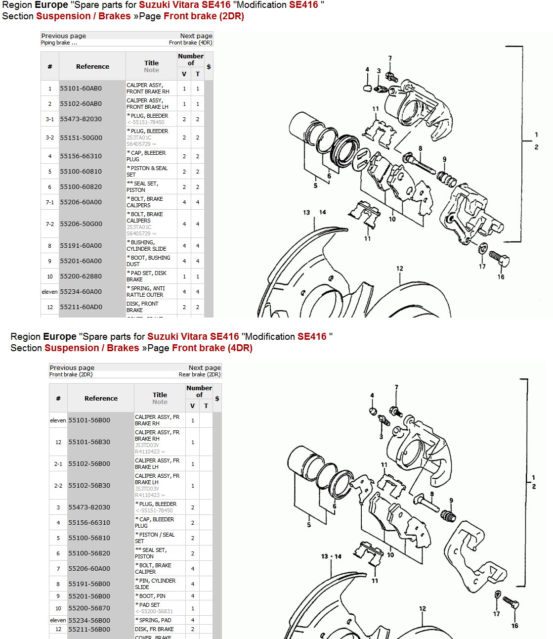

Shown in the USA as this..

Yea the company are footing the bill and also will not be getting paid for refurbing the calipers as this has been dragging on for a month now.
All my usual parts places dont seem to be able to get any, suzuki so say have no stock and would only sell me a caliper and carrier complete at £250 which they had no stock of anyway.
The pic from america looks like he right ones.
if in doubt, FLAT OUT!

Post by twiss » Tue Aug 11, 2015 4:24 pm
Is above the correct part number?
55191-56B00?
Our parts guy here might be able to get them
