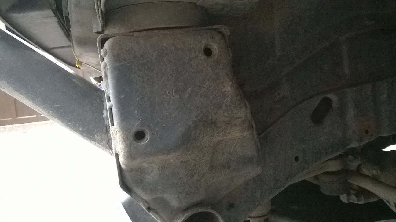

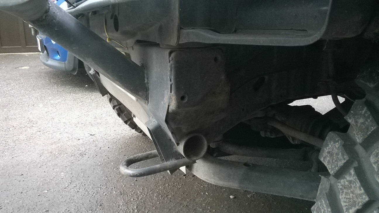

Pretty sure 4 bolts hold the actual bumper on. But there are many screws holding the grille on. Trying to recall how many when I took my bumper off. I do know it needed a ton of WD and a sledge hammer and a crowbar to get the damn thing off.

This might help...
- WP_20151030_002.jpg (413.82 KiB) Viewed 9619 times
- WP_20151030_003.jpg (333.92 KiB) Viewed 9619 times

@donkeychomp,i think that may be the information that i have been looking for,will have a look at it in the morning,its also in that area that the rust worm is,so will update you tomorrow.
Many thanks for that,gut feeling tells me that could be the cause of all the trouble.
Thanks you for taking the time out to post the pictures.
