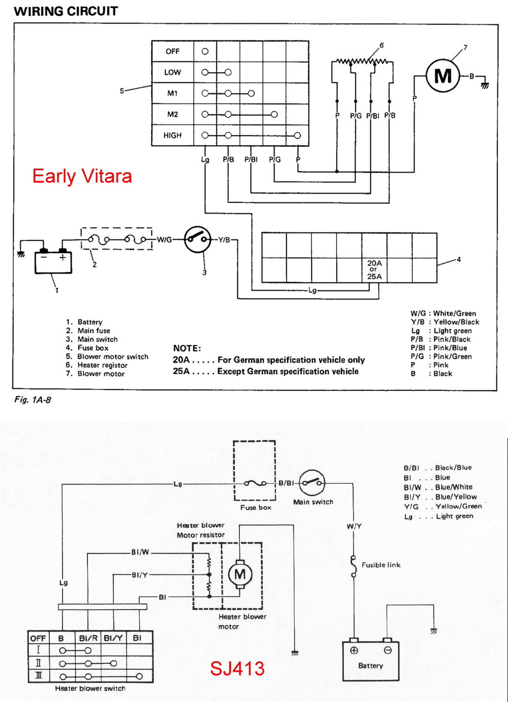

Re: Heating
Post by Darrell » Sat Nov 19, 2016 12:26 pm
Well it looks like the light green wire on both models feeds the fan. So now you have a choice, either get another fan switch and have different speeds or just a simple on/off switch to whichever resistance/speed setting you would like. Pics of what you have left may be helpful as the earlier 410 is not quite the same.

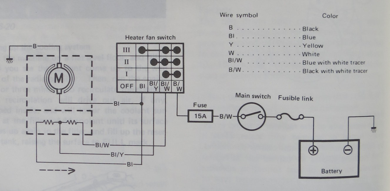

Thanks Darell its a c reg 410 , all the contols have bin ripped out the front but all the rest is still there , heres a pic of the green connector out the back of hvac also have the other end of green connector so if am wright in think if i just run a normal switch from the live n nutral wires here would i have heating on full speed ? I carnt seem to find on the diagram which colours r the live and earth any ideas asuming i can do it like that Thanks
Re: Heating
Post by Darrell » Sat Nov 19, 2016 2:32 pm
It's hard to tell from the pics, but as long as the motor black lead is earthed and power (black/white on earlier 410s, Light green on the Vit) is connected via a on/off switch to the blue wire from the fan motor it should run at full speed.
I believe the below photo to be correct for the 410 82-84.
SJ410 heater fan circuit - Early type.jpg (117.93 KiB) Viewed 9721 times
Re: Heating
Post by Darrell » Sat Nov 19, 2016 2:38 pm
Looks like the 2 wires in your pinkies above. Black to earth, Blue to live.
