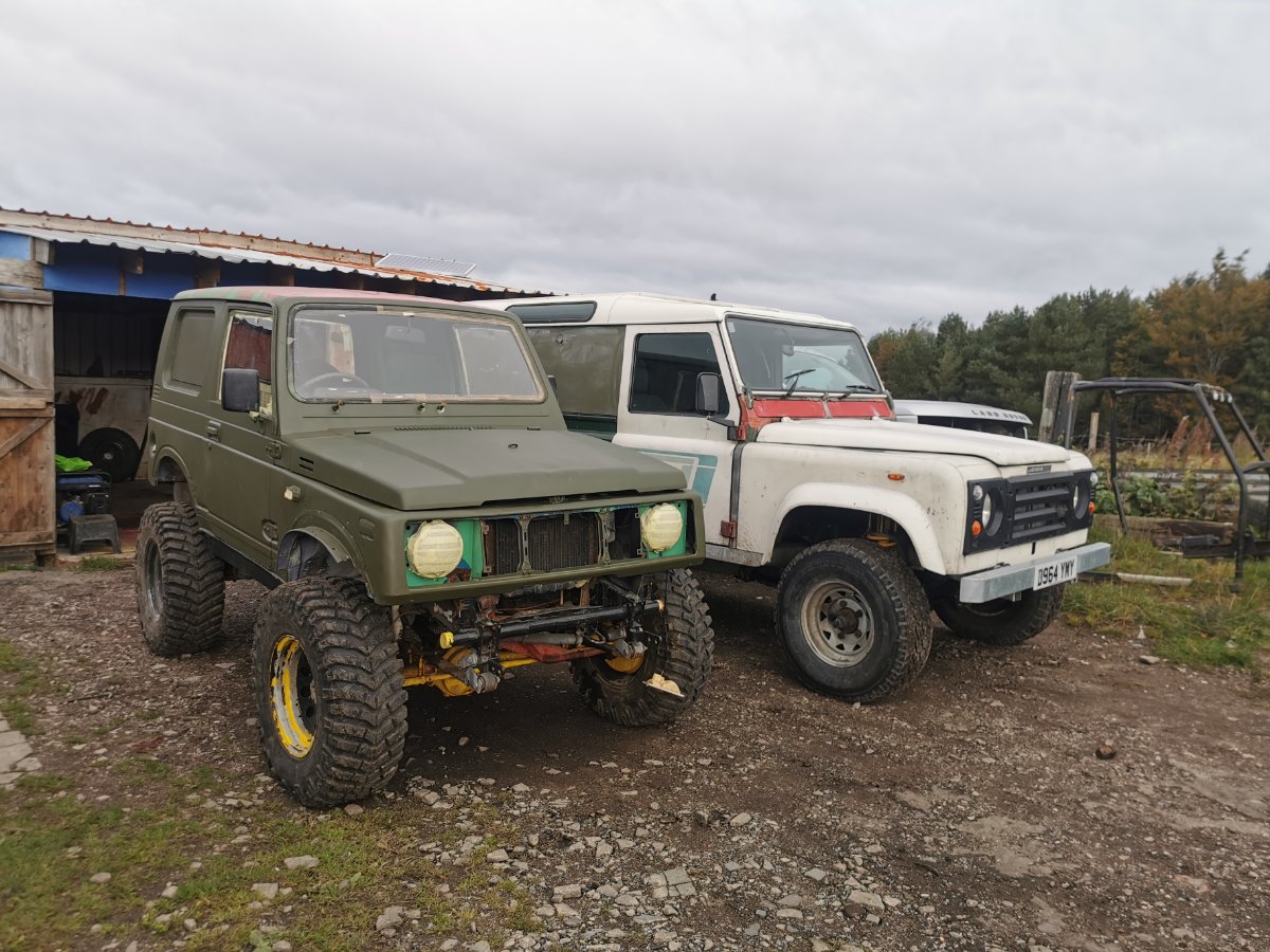

SJ 410,
Just put discs and pads all round, one of the rear callipers was seized but sorted now, all wheels moving untill brake applied.
It just does not seem to have enough power, is ok until you stop then when pulling away in first one of the back wheels will spin and very hard to pull away. This is in 2 wheel drive, Only drove it on field as not Mot d yet. Its worse when reversing back in to the shed as there is a rut just before going inside.
Not sure if it is the clutch or something in the rear axle.
Anyone any Ideas,

Sorry forgot to say it has had rear disc conversion. Im sure all brakes are free now and moving as they should. Only seems to do it when you stop in a rut or sligfht incline. ok on the flat,

It has a 4 or 5 inch lift, wheel spacers ect, big tyres will get size

Unless its geared right it will be sluggish with them tyres. Unless you have a working lsd or locked diff then it can potentially just spin one wheel on each axle. When your noticing the one wheel spin whats the other wheel doing? The drive will always go the easiest route.

Other wheel seems to be trying to move.d_r_1989 wrote: ↑Tue Oct 20, 2020 11:28 amUnless its geared right it will be sluggish with them tyres. Unless you have a working lsd or locked diff then it can potentially just spin one wheel on each axle. When your noticing the one wheel spin whats the other wheel doing? The drive will always go the easiest route.
When I say that they spin freely when jacked up, I meant that they do spin but a little force has to be put on, ie they dont just spin using one hand, but still think the Brakes are free.
Will jack it up tonight and check bearings, Should I feel free play in wheel if bearing is knackered ?

There will always be abit of drag on the wheels from the drivetrain, thats normal. But should be able to spin one handed. Wheel bearing can be noisy and/or have play. Id double check the calipers and sliders are free, the sliders seize up real easy.
The correct gearing will help with engine performance too, them tyres look like 33s, at minimum you want a 410 transfer box and some 3.9 diffs or higher.

Cleaned all the pistons tonight on all 4 corners, wheels spin freely now with one hand and very little resistance. drove it round the field and in and out the shed a few times and it is a Lot better but still seems to be sticking / struggling as before but not as bad.
Everything cleaned and greased when fitted new pads. Cant hear anything from bearings and there is no movement on the wheels either direction with bar.
Tyres are 31s
How can I tell if gearing is out ? as far as I know it has the original transfer box fitted. but then again I wouldn't know even looking at it.
