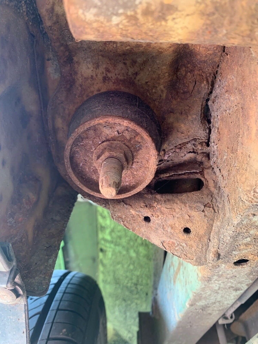

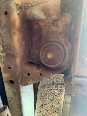

My Jimny got any advisory for rusty rear body mounts. Im interested to know how bad these are, when I will need to fix them and what it might cost.
Pictures attached
many thanks!
Re: Rusty body mounts
Post by donkeychomp » Mon Jul 19, 2021 9:06 pm
If it's only an advisory I'd try to clean them up with a Dremel or something similar, coat it all in rust killer afterwards, then underseal.
