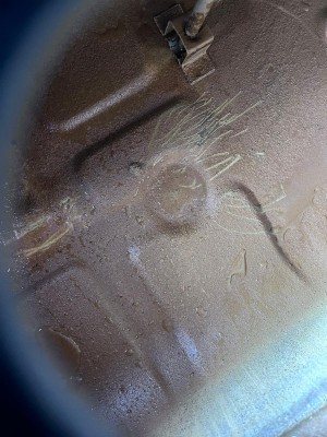

Anyway, we've cleaned out the tank and flushed the fuel lines, and all is looking much better, but I have a question about the fuel outlet pipe in the tank: As far as I can tell, the 1.9TD used the same tank as the Spanish carb models - does the outlet pipe have a 1-way valve and/or mesh on the end?
There is resistance when blowing into this pipe but not when sucking - thinking this could either be a 1-way valve (that I can't find any reference to) or that a load of diesel bug/sludge made it's way through a mesh and is now effectively creating a 1-way valve (and we therefore have some more cleaning to do).
If anyone has any photos of the tank internals that would be great!

As far as I’m aware there isn’t a one way valve but I think there is a mesh on the pick up. I can check on a spare Spanish tank I have in the workshop on wed eve for you though 👍 I’ll try my best to remember.

Eventually managed to get a good photo through the fuel sender hole, which shows no valve or mesh on the outlet pipe - I've attached a photo in case this helps anyone in future.
