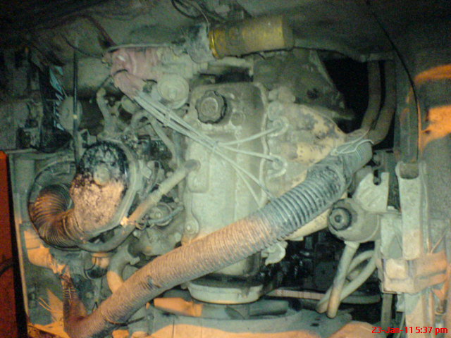

i was sold my sj413 with the 1.6 8v vitara engine now yes its an 8v etc etc but ive never seen sj or vitara engines at all before, but my problem is ive now got a manual for it and looking at pics of the engine im thinking its just the original sj engine what do you guys think?

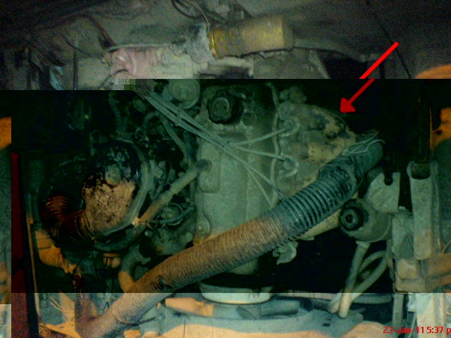

It will have the engine CC stamped on it, around where this arrow points.
My vit engine says "1590cc", samurai/sj engines will say "1324cc" or "1298cc"

As twiss says, its deffo got 413 intake on the carb, they do fit on a vit carb but need to be modified as to not interfere with the choke.
In general the 1300 and 1600 8vs look pretty much identical, the 1.6 just has a longer stroke and taller block.

and a bigger fuel pump!

you were right twiss! mahoosive engine size numbers of 1590cc on the side of the block! how could i miss that
at least i know what it is now,
