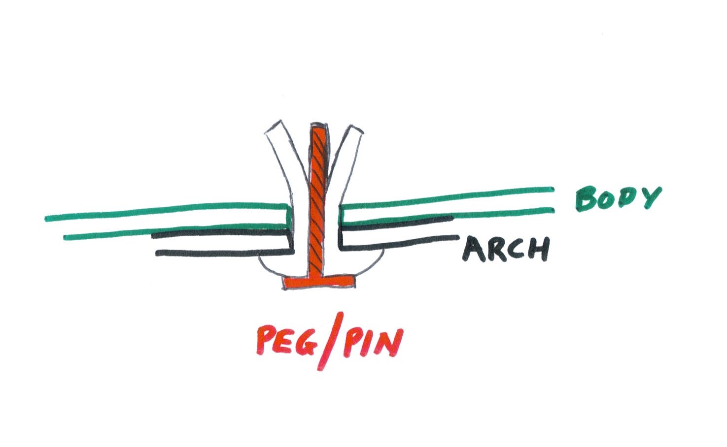

The arches are a bit fiddly and the clips feel like there going to bust any second and some may
Basically it's like a rawlplug, a plastic plug which the back expands when the peg/pin is inserted. All you need to do is remove the pin then it can be removed from arch. If you can get the pin out without pulling the top off
. Hope my crappy diagram explains better.
The rear bumper bolts if I remember are behind the light units, just some m6 bolts.

I yanked my arch clips out with a flathead screwdriver, pliers and mole grips. Took a bit of persuasion and time but got there in the end, front arches this summer!
