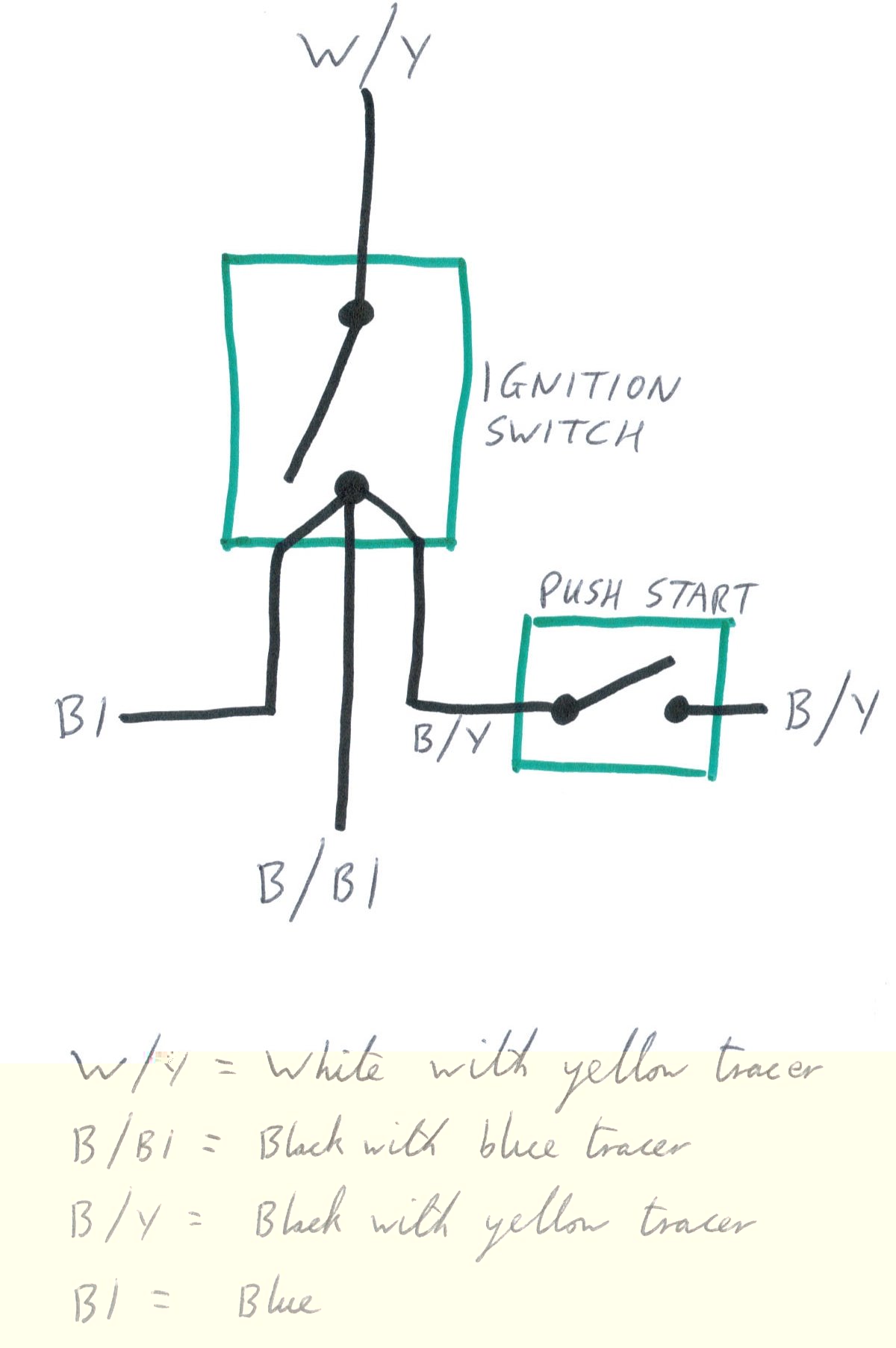

btw i forgot to say, the key barrel was jammed in the anus, i just ripped out the wires from the back and crossed them over until it started usually involving sparks until something happened, any way i can have a switch to start it up.

Is this just on offroader, what about security. But yes you can just use switches.
Something like this would work fine. You need one with a descent ampage rated switch though.

Re: Vitara 1.6 into Samurai 413
My 413 wiring would need to be like this........
- ign.jpg (111.85 KiB) Viewed 9710 times

looks good ive got a few heavy duty switches lying about the house, ill give them a go.
