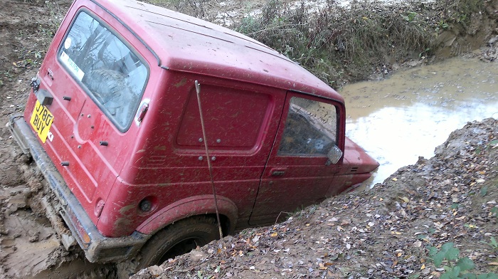

This might have had something to do with it.....
