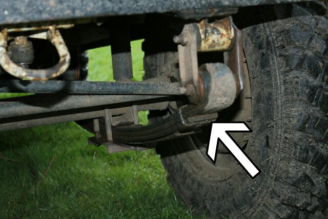

Firstly, not sure what suspension setup I have going on, maybe add-a-leafs?
FRONT:

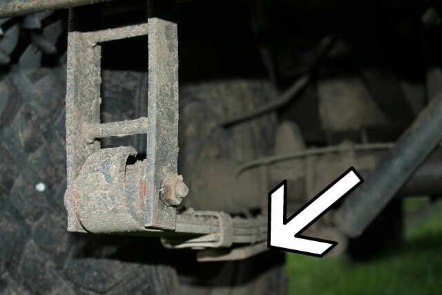

REAR: Very long shackles, not too keen! But yet sits the same as the front, with short shackles?!
Also shocks have been mounted in the middle via what looks like a piece of angle. But they dont fit well as the shocks are fitted 45degs thru the angle which is still horizontal. This causes them to bang about when bouncing over stuff, bit of a bodge in my eyes :(

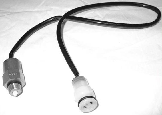

Found the reverse lights dont work and have found what I assume is the switch on top of the box, with 2 electrical connections on top and nothing going to them. Where are these wires likely to be hiding? It had a clutch not too long ago by previous owner so Im guessing they havent been re-connected :S

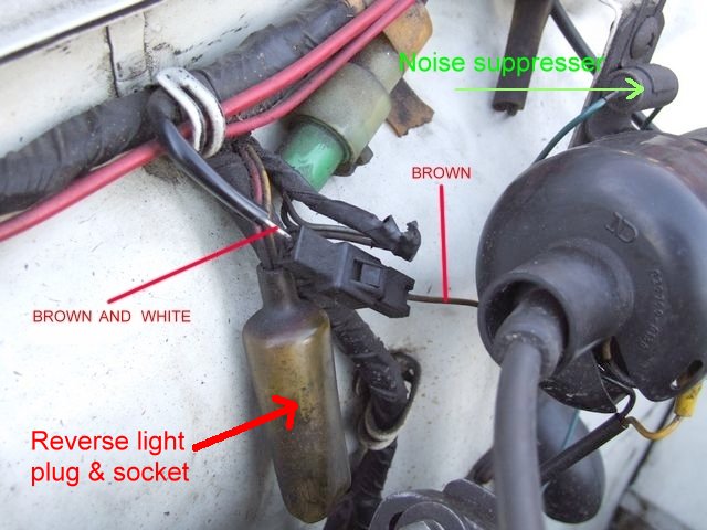

And one last thing, where is this wire on the bottom of the distributor supposed to go?
Its only short.

regarding the switch at the top of the box
looks like this? Image two wires normally yellow and red , thats ya reverse light switch :guns:

I think the wire on the bottom of the dizzy is a earth. There should be another similar wire attached to the body that it plugs into.

What looks different between front and rear for you to suggest that? Theres 4 springs all round but I cant tell the difference, being new to leaf springs lol ;)
Is the earth essential to it functioning properley? I'll take a look!

The front springs have a nice curve to them = lift, + 4 leafs = heavy duty.
The rear springs look pretty standard but have gone flat, this happens when lift shackles are fitted without extending the bump stops as the springs can be overstressed the wrong way.
The whole engine block will be earthed so it doesn't really need that earth, but as Suzuki added it I would connect it. The should be a matching wire coming from the bulkhead.

You can see on your spring packs
On the front you can see the add-a-leaf, its thicker than a standard leaf spring and gives the curve shape to the pack. Standard SJ front leaves are almost flat, yours have a good curve

On the rear you obviously have extended shackles ( standard ones are the same as the front) if you look at the leaf pack there aren't any thick leaves apart from the flat one I've arrowed. This is a helper spring and is on all standard rear SJ leaf packs

So ideally, it would be better to have add-a-leafs on the rear too, and lose the huge shackles?

Those front springs look like lift springs to me, not standard ones with an add-a-leaf as they have military wrap.
